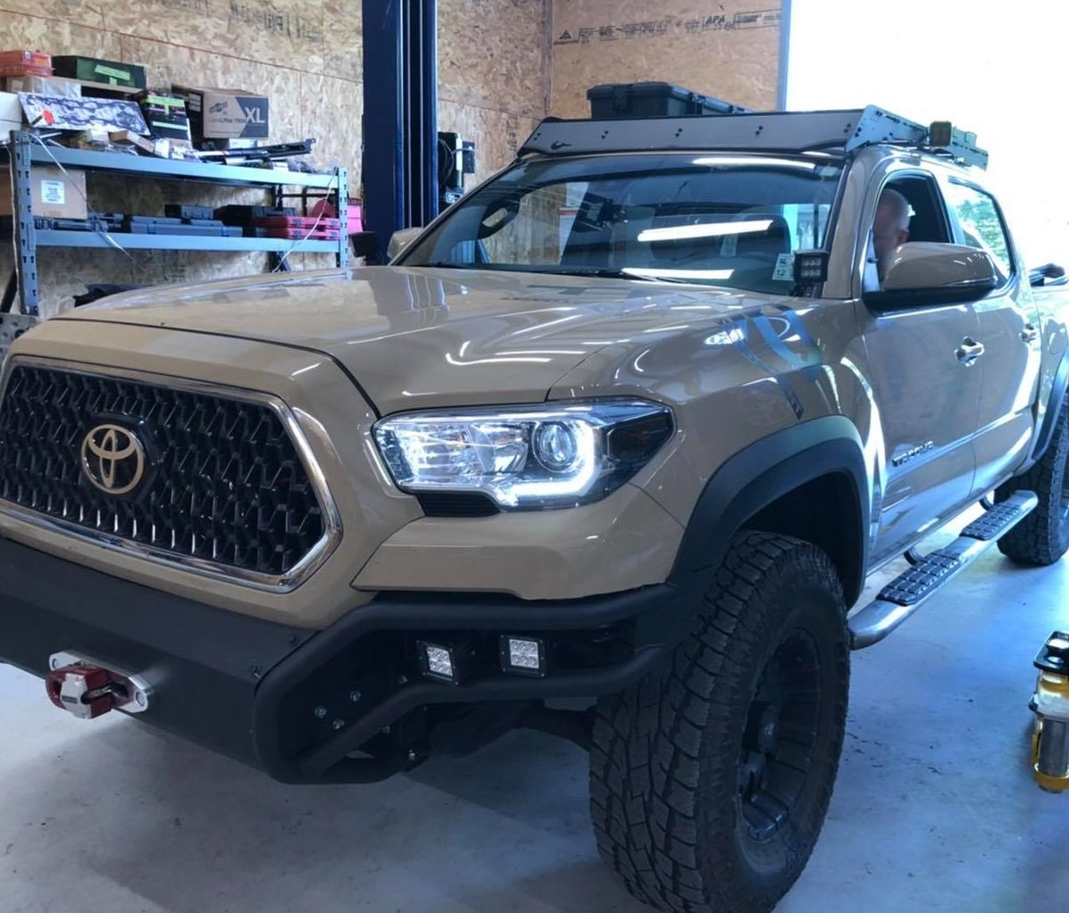

    I'll post a pic of my truck that's recently taken in the shop. As you can see from my rig down below, I didn't have sliders for a while; I recently put it on two weeks ago one of the reason why it was in the shop, the other reason was suspension and regearing. However, I don't rock crawl; I do mountain passes at 30+mph and "Overlanding"/camping. Your type of adventure doesn't always fit with what the other person has. 285s are necessary for me since I live in Louisiana where it's deep swampy mud where skinny tires can't dig through (wish I can get skinny and tall, I like that look better). Literally will get wetter/softer as you dig. People think just cause they have one thing and that is what's good in their area, it's the same for the rest. It's your taco, your adventure, don't let people dictate what you do {end rant}.

    That guy has at least $60-70,000 in the truck pictured in your 1st post,this includes the price of the truck itself.

    That looks like an additional $6k for all those parts.

    Bumpers, Skids, Sliders, Lights, Wheels, Tires, Suspension, Roof Rack, Bed Rack, Traction crap, Winch, etc. plus shipping/install all for $6k?

    nah son. That’s more like $15k-$20k with shipping and install. Plus I missed half of the shit on the truck.
