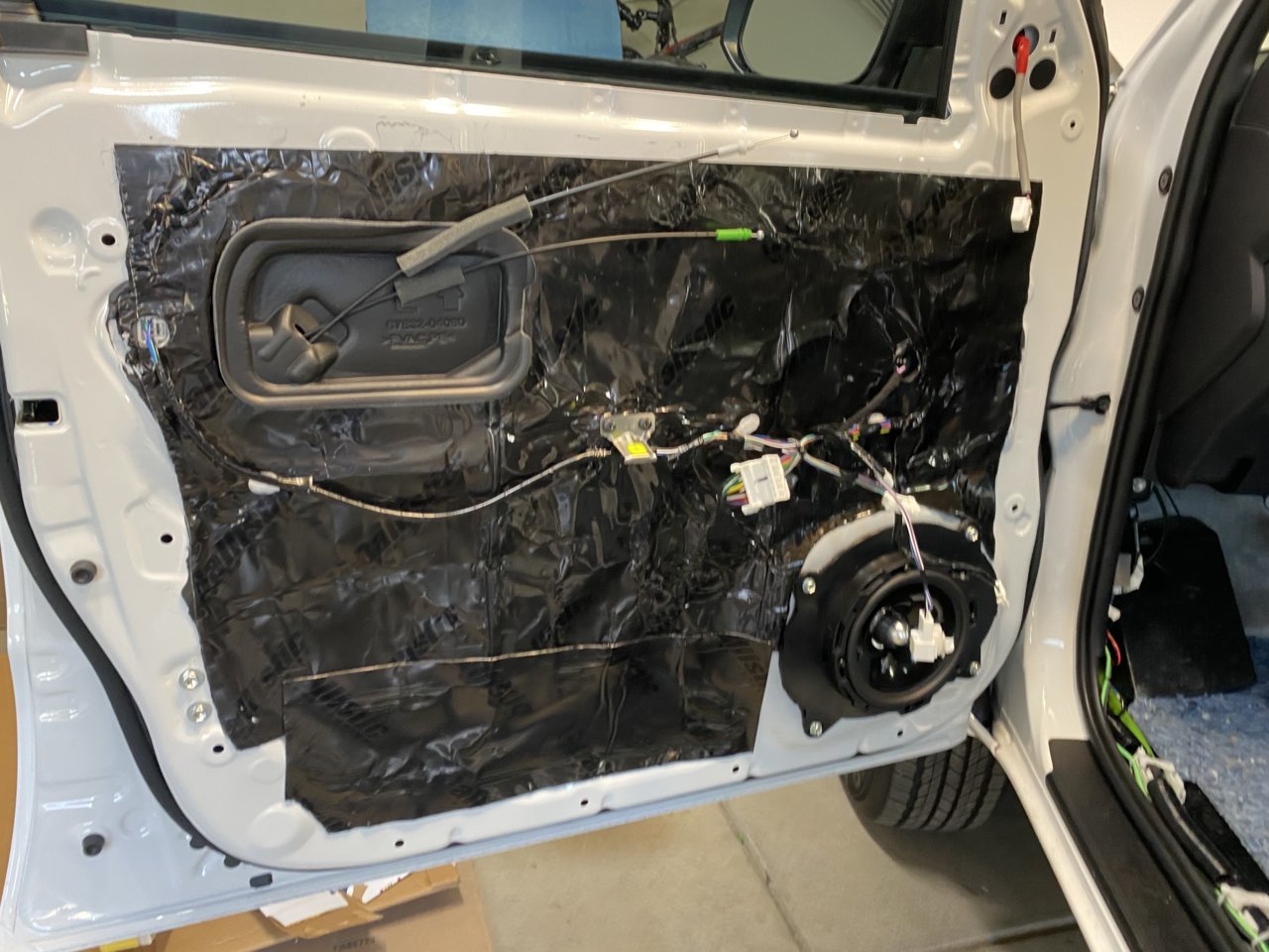

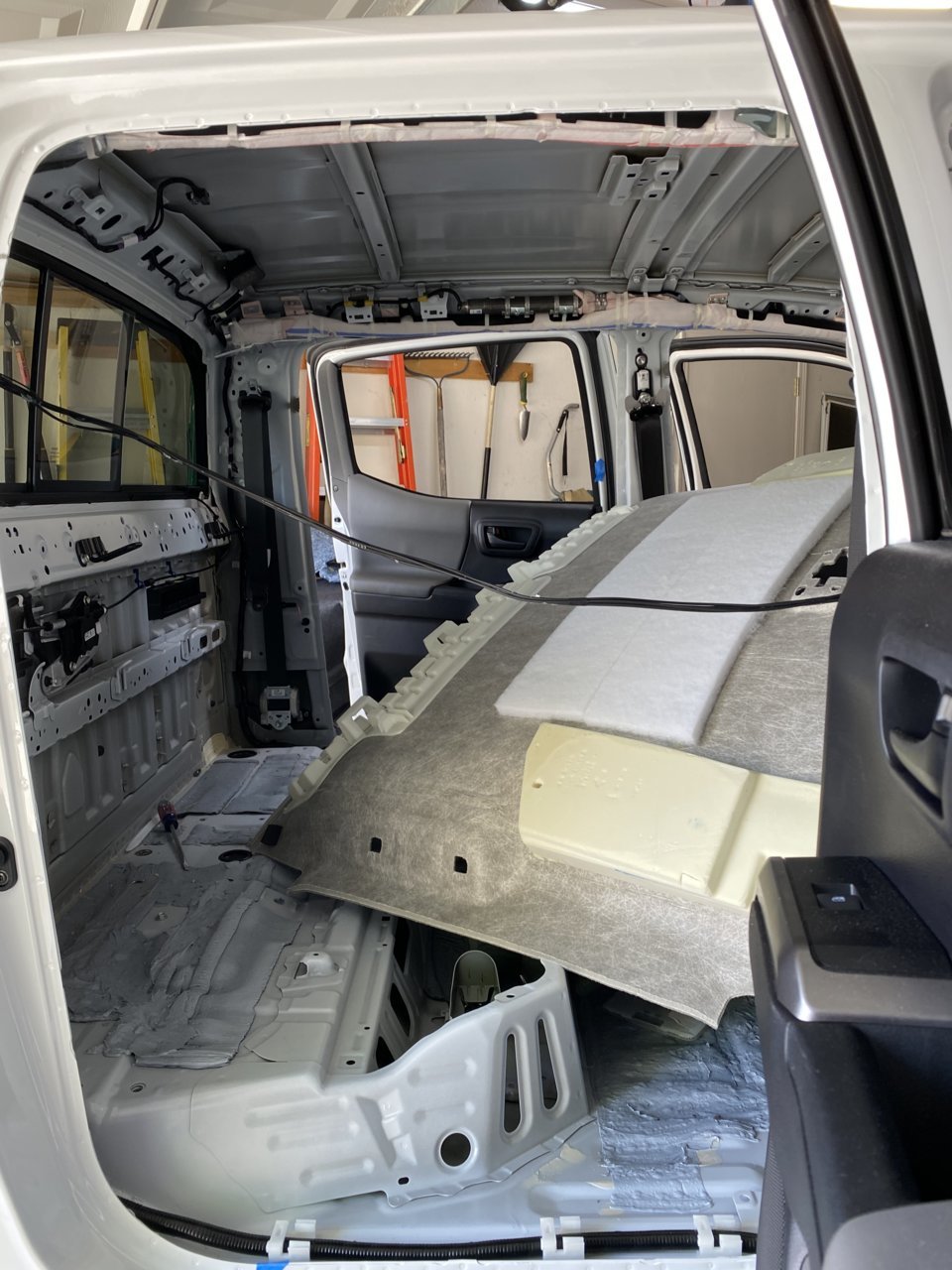

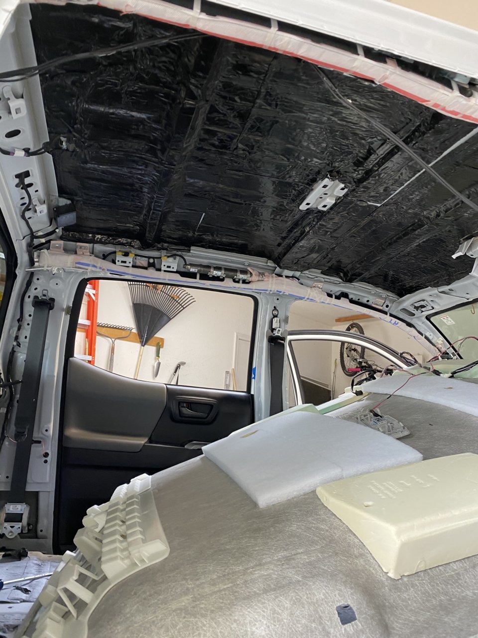

    Sound system 2-10” Sundown SD4, 2 amps Rockford Fosgate mids and highs. Sound deadened entire cab and door with Metra Ballistic deadener
    As far as the sound deadener, I used 3 boxes of Metra Ballistic Sound Deadener, 36sq ft each. That includes roof, floor back of cab and inner sides of the doors. That’s the entire cab of the truck. Remember- when you go this far, DO NOT START THE TRUCK WITH THE LANE DEPARTURE CAMERA DISCONNECTED. You do not want any error codes for the LDWS. As stated in a few other threads, time consuming, but this step is definitely worth doing. No “tinny sounds” at all after this step.
