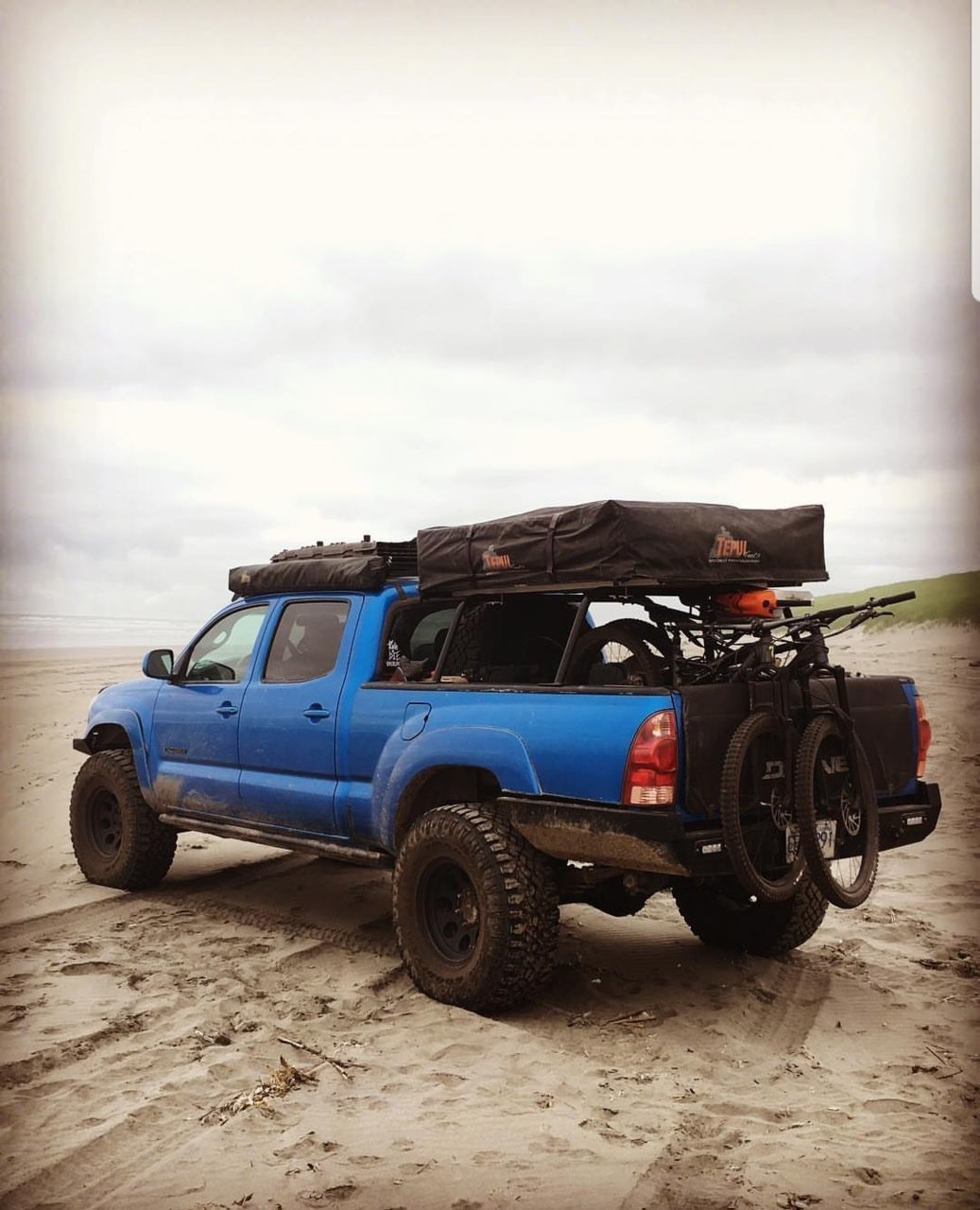

    Gotcha, so that's your truck in his post? Has anyone suggested mounting your spare to the bottom of the rack below the tent?

    My original intention was to start a thread for topic discussion of what people have used or seen used.
    In hindsight I probably should post a few pics up so that people can see what I’m working with on my setup.

    Yes, that’s my rig.
    Yes, that was mentioned but I only have 25” of room between the bed floor and the bed bar so a 35x12.5” tire would not leave much room for bed space.

    I 100% get what you're saying about the leverage multiplier of having your tire mounted on a swing out. If you are committed to getting it over the axle I think I'd consider a rack that was a few inches taller and mounting it under the tent. I too would hate having a spare in my bed taking up space.

    I do what you do, but I built my bedrack as low as I could to clear the tire and my bike seat over the tail gate. Tire stands up, and the tent lines up with the stuff on my roof rack. I would like to make everything lower, but the weight up high hasn't really been a problem. I made the tent as light as possible. This is with a 35 against the front of the bed.

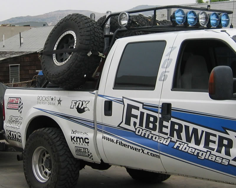

    One thought I had, that I've been contemplating for myself and would work for you, would be to cut a hole in the front of the bed that the tire could sit vertically in like it does now, just lower.
