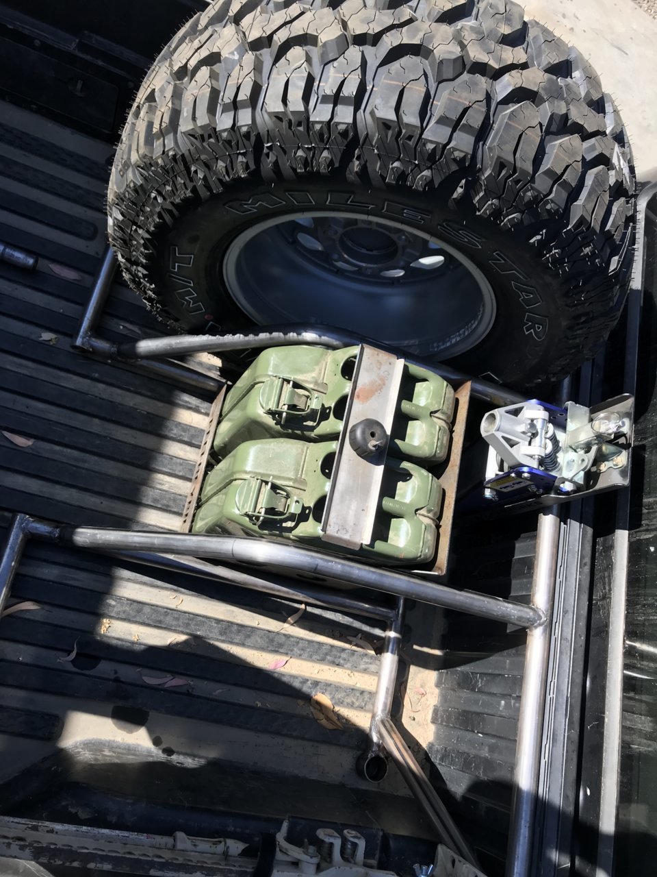

  5. Jul 5, 2020 at 1:48 PM
    #105
    desertjunkie760
    desertjunkie760 [OP] @DesertJunkie760 (IG)
    Apr 11, 2016
    #183963
    9,159
    Shane
    2011 MGM DCSB TRD Sport 4x4
    Check My Sig.

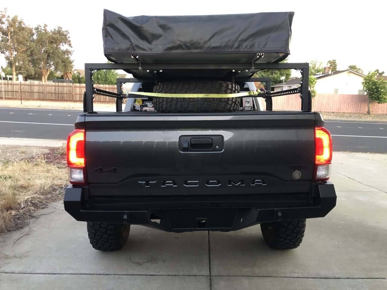

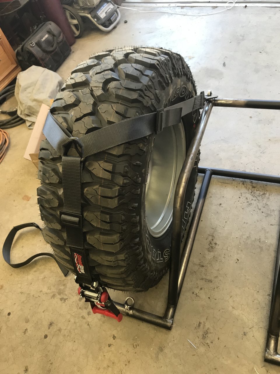

    Been a couple weeks since any updates on the bed rack. The main structure has been built and the tire is now secure. Working on the layout of all other accessories now.
    I’m open to ideas/opinions on the layout. Trying to keep the build as practical as possible and optimize the space.
    eccracer104 and hoarder23 like this.

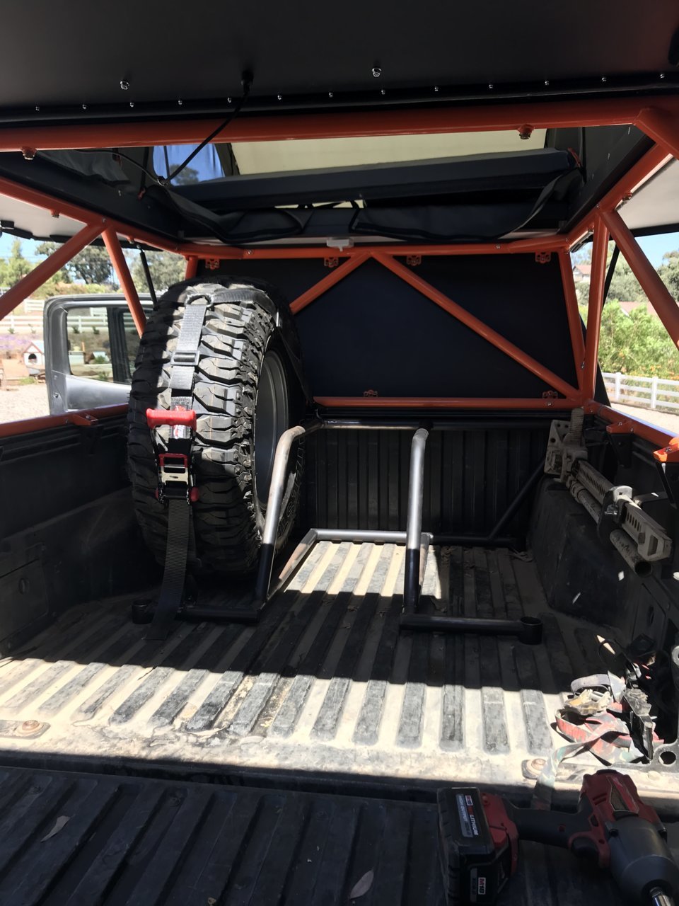

  6. Jul 5, 2020 at 1:55 PM
    #106
    desertjunkie760
    Apr 11, 2016
    #183963
    9,159
    Shane
    Check My Sig.
    With the tire mounted/mocked up.

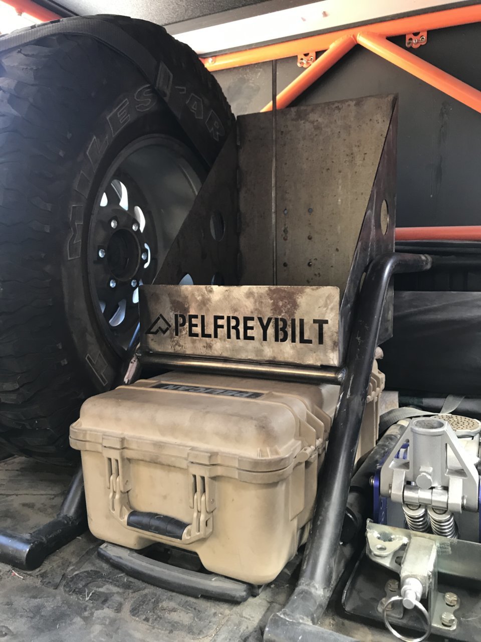

  7. Jul 5, 2020 at 6:41 PM
    #107
    desertjunkie760
    Apr 11, 2016
    #183963
    9,159
    Shane
    Check My Sig.

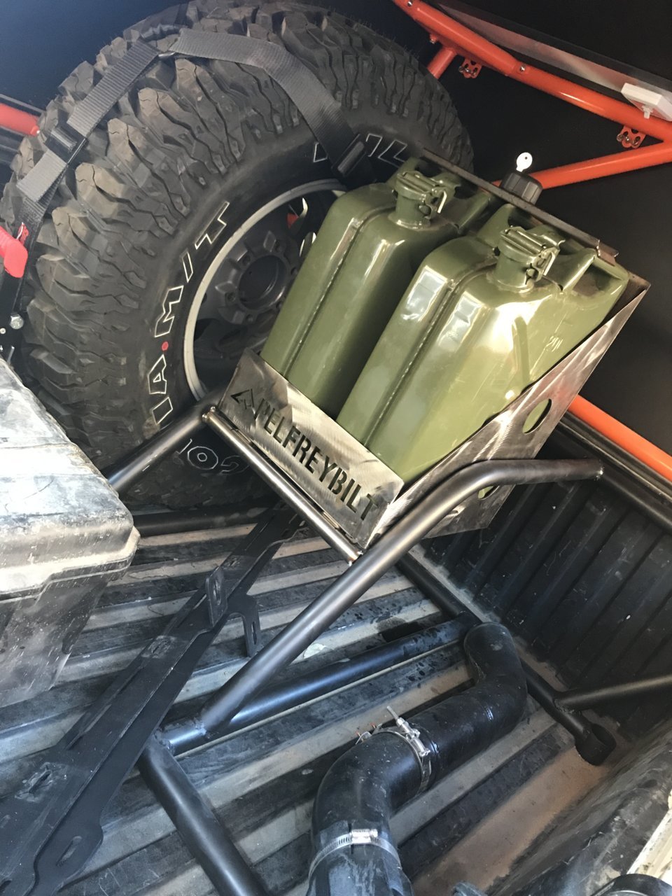

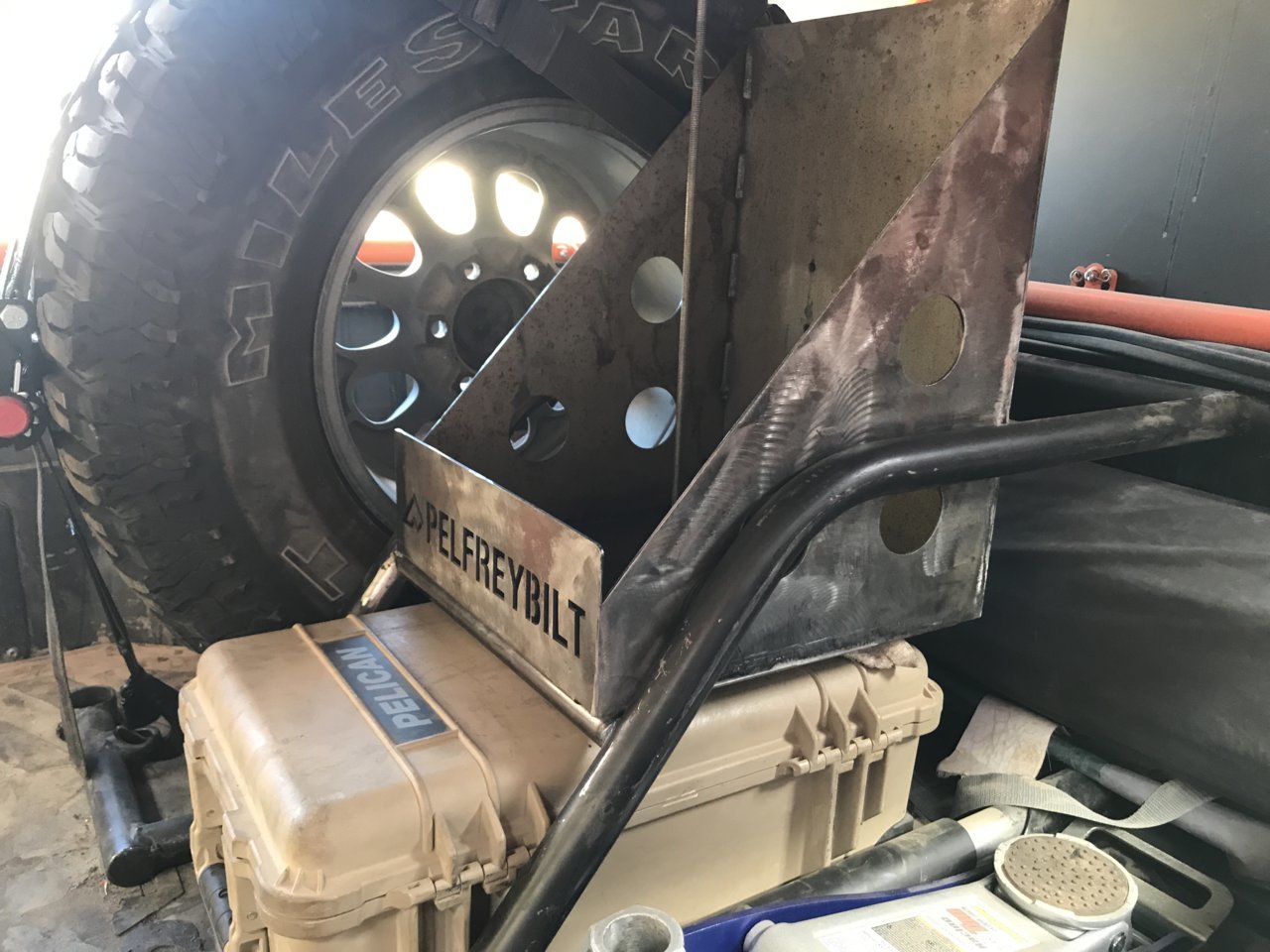

    Last one for today. Spent some time playing with different layouts for the additional accessories. Decided to make the Jerry can holder modular as it’ll be used the least amount of all of the features im building into this rack. The holder will be held on by 4 bolts with two additional crossmembers being added to the main structure. the can holder will be elevated to fit the tool box underneath.
    also, if anyone has a plasma table and wants to cut out a new front plate that says #PelfreyBroke on it I will take the time to cut this one out and replace it.
    Road Bull, Wulf, Airdog and 3 others like this.

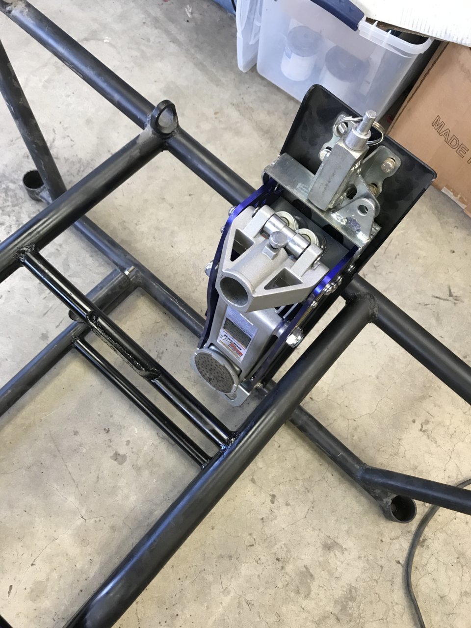

    #183963
    9,159
    Shane
    Check My Sig.
    Spent some time the past two weekends working on the bed rack some more. It has been holding the tire and tool box with success the past few months but I've got a trip this week and need extra fuel/water. Re-worked what I thought was bad measurements on the fuel can supports to realize the fuel can holder itself wasn't square and was causing my issue.
    I modified the holder and it now fits like a glove! Also, spent a little extra time and got the floor jack mounted up and secure. The rack is now 90% complete but is ready for this weeks adventure!
    Mocking the floor jack up. It's the smaller 1.5 ton HB special mounted using a Stewarts Raceworks mount. :bikewhoops:

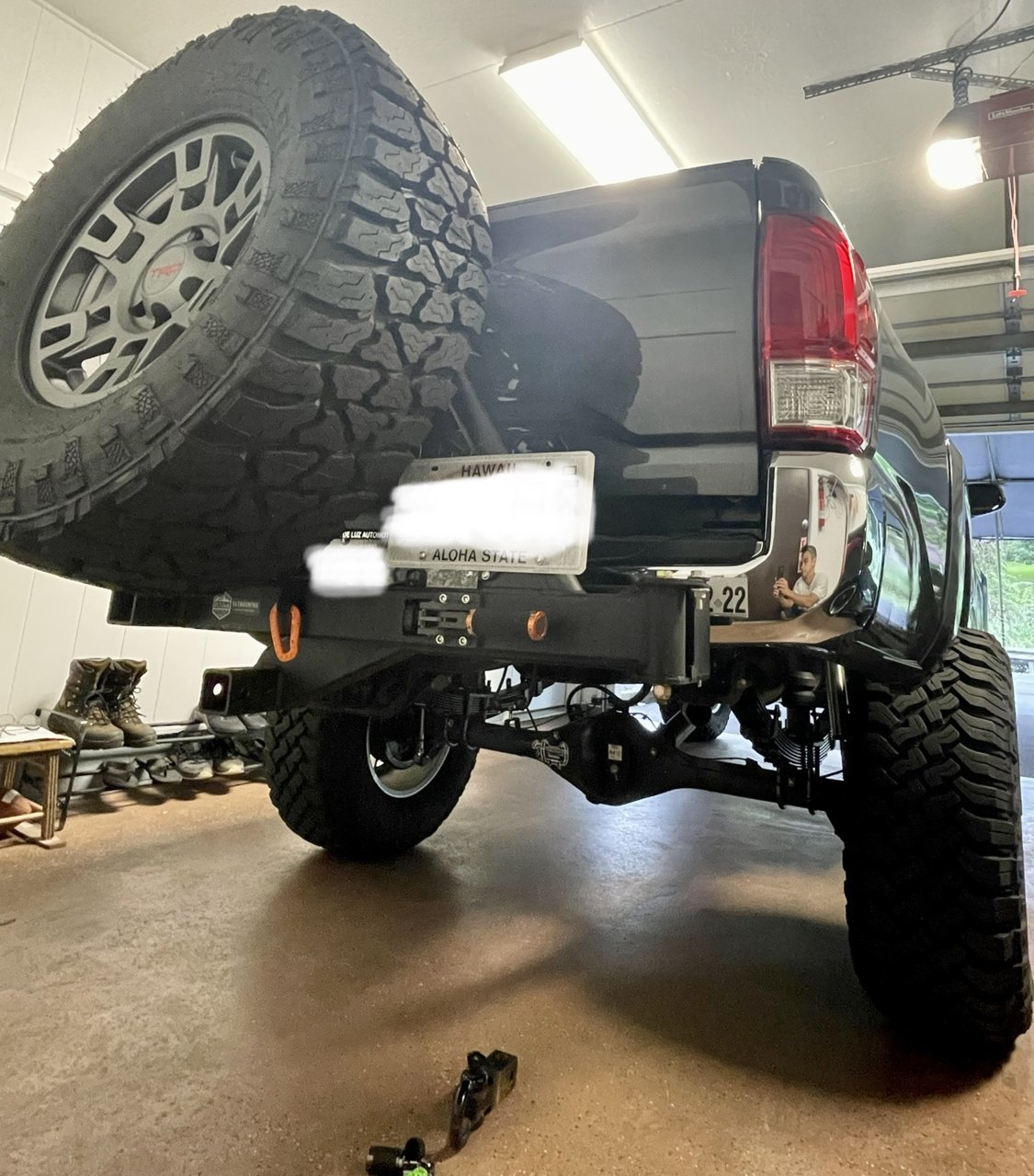

  17. Jul 13, 2023 at 3:32 PM
    #117
    alwaysHI
    alwaysHI Well-Known Member
    Nov 6, 2015
    #168846
    747
    2017 MGM DCSB
    Pro Comp 6", full length 5100's with OME 888 w/ taco lean spacer, 5160s w/ Alcan custom pack, HS extended brake lines, Summit offroad Dakar 17x9, 315/70/17 Falken Wildpeak MT, Nitro 4.88 regear
    I run Rigd
    Added the anytime backup camera (by the license plate). I bypass the factory tailgate one when the swing out is on.
    Best thing about it I can take the spare/carrier on and off whenever I please.
