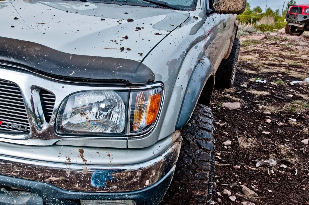

    Okay this is what I have 15x10" with a 3.76" backspacing and a -44mm offset and they stick out about 3 1/2" past the stock fenders at the top of the tire. That's why I'm getting the cut out's they should stick out about 1/2" to 3/4" at the top of the tire as you can see in the photo the side wall will be sticking out a little more. I think this wheel & tire combo will look perfect with the cut out's
