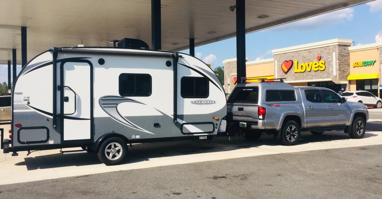

    Yeah, I know, different trailer. I towed my Satelite 17RB(approx 3300lbs) with my ‘19 Sport. I’ve run Airlift bags on 5 previous trucks with no gripes. They work great. This truck I tried something different. I went with Wheelers 1.5 AAL because just adding the ARE topper, OEM bedmat and toolbox dropped my rear an inch or so. Not shown in pic is my Fastway E2 WDH. This trip we were just going to next county. Without it the truck handles fine, but it doesn’t bounce as much with it. I didn’t do the exact numbers but I’m still in spec. We, my wife and dog, travel light. Usually just my Weber 2000 grill in truck and sometimes our bike on the roof.

    Thanks Aquatic. I'll give an AAL a try. I like the air bag's adjustability, but the shaking/bouncing is dangerous and has to be hard on the truck and the trailer.
