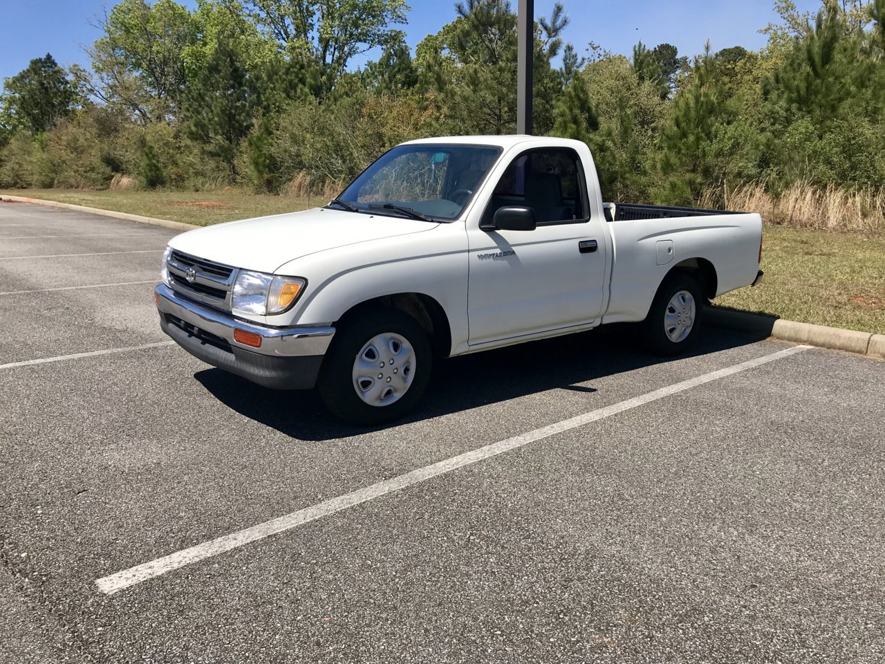

    I want to turbo my 97 2RZ taco. She is completely stock front to back not one thing done to it and never been in a wreck. So my question is if money wasnt an issue where should I start. Essentially I want to do everything (necessary) else but the turbo and then BLAM turbo. She has about 194xxx on her, standard trans, rwd.
    So for the taco enthusiasts out there, if you could start over where would you start :)
