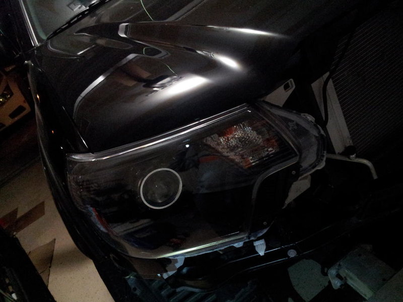

    Passenger side mounted.. One more to go tomorrow and I'm done.. Thanks guys for the help

    everything is finally mounted back on. ill take more pics next time...im a little tired and just glad im finally finished LOL

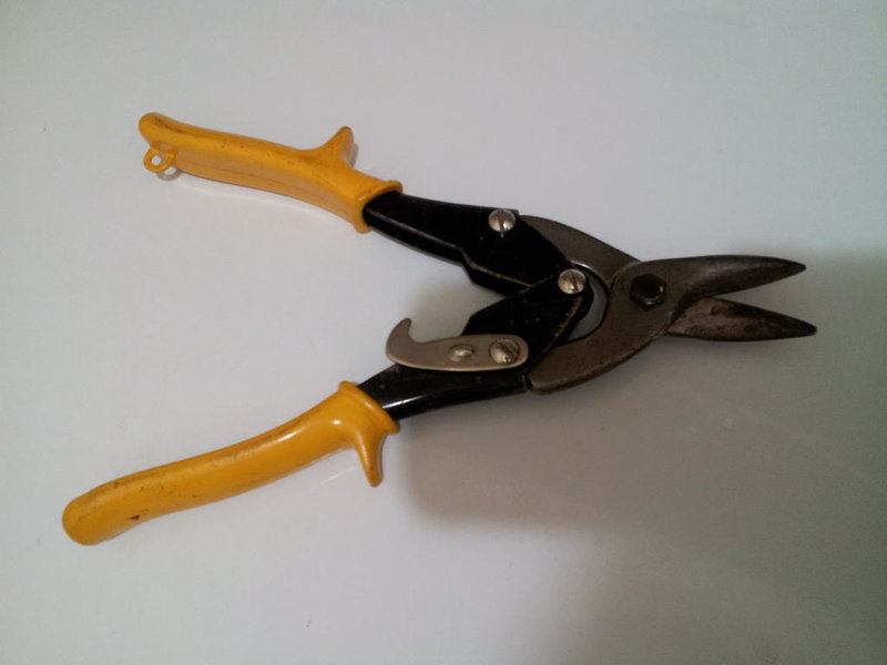

    Hey Paul, what did u use to modify the H4 Ring?

    I used that heavy duty cutter/scissors.. Don't know what it's called but I had one laying here.. It literally cuts it like paper.. Took less than a minute

    Sorry didn't take a pic of it. Basically it's like the "Y" and just trim a little off each of the 3 legs (make them skinnier not shorter) so you can rotate the projector more and get a better 180degree cut off

    Okayy so u used Metal Snips to trim it.
    So did you mount it on your truck to test the alignment before sealing it?
    PS: What paint did u use?

    Yup mount, test fire, align then if all is good, seal them
    I used fusion satin black

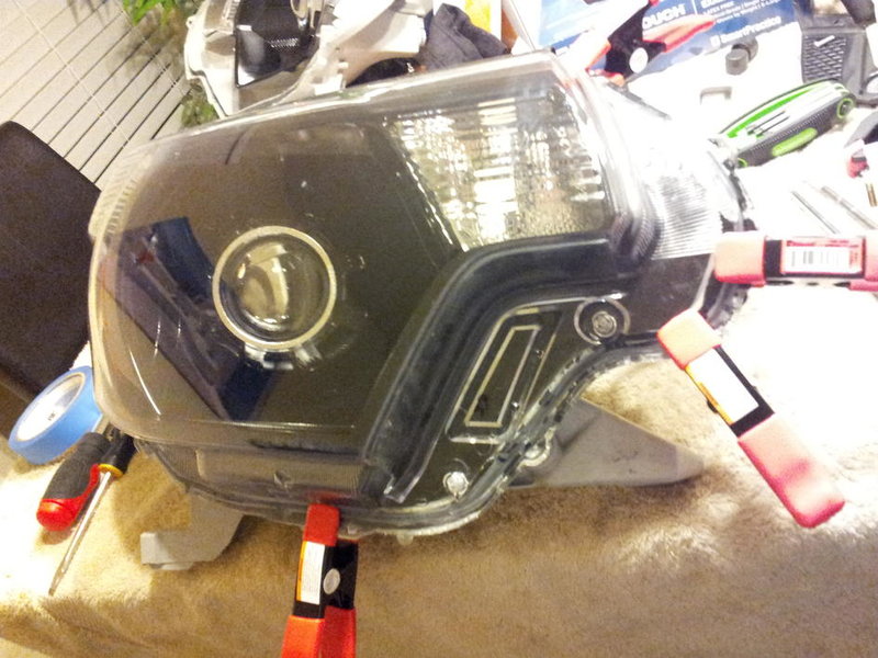

    Oh btw, what sealing process did u guys use?
    Did u scrape off the old stuff and put in new ones?

    I didn't even cook them.
    I got the larger pieces of the original sealant out, then laid in a bead of the TRS glue.
    I headed to the oven and "somebody" flipped out.... I put them back together and just applied steady force from spring and bar clamps.
    Snugged up the bar clamps every day or so and after a week, every thing was seated nicely.
    I was in no rush... my work schedule didn't allow me to have the truck torn apart while I was on call.

    A good heat gun is also an option if the significant other is yelling at you not to use the oven :D
