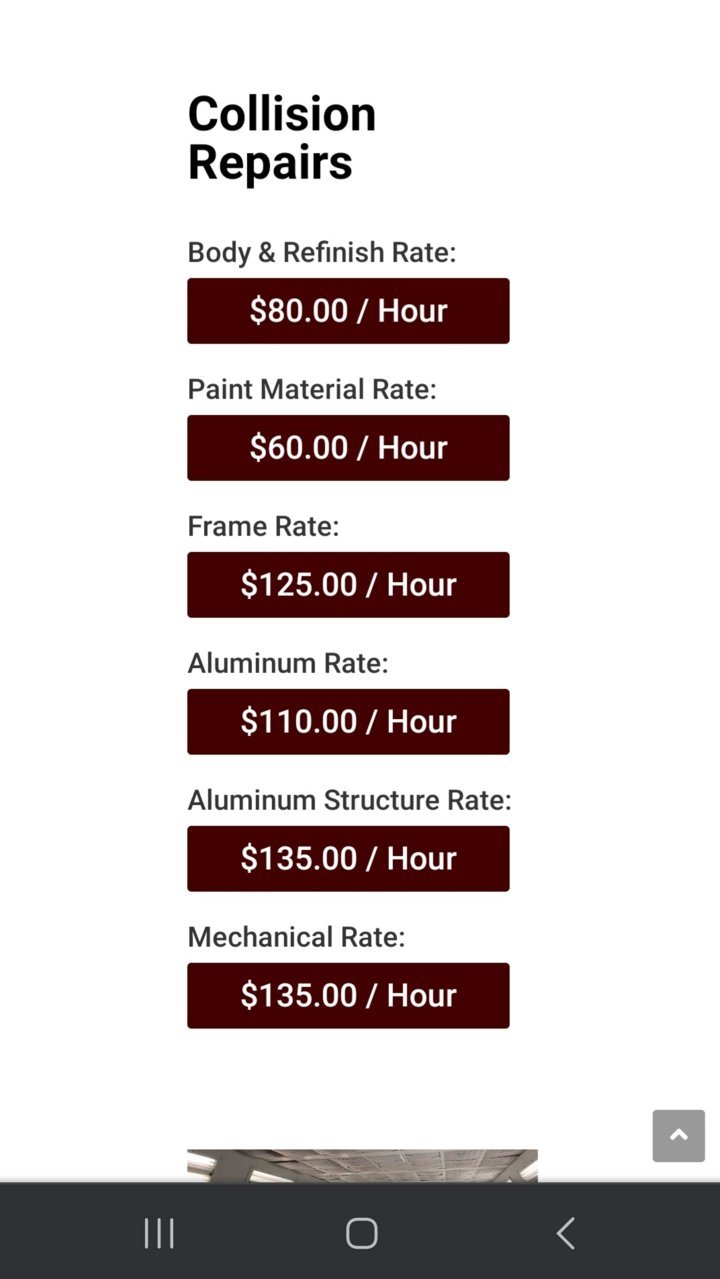

    There is alot of prep to paint that bumper. 1st. It needs to be washed soap and water. 2nd, wax and grease remover, 3rd, scuffed w/scuffed pads. 4th, wax and grease mover again. 5th primer. 6th scuffed/sanded again.7th wax and grease remover again. 8th painted with flex agent. 9th clear coat w/ flex agent. Shop rates around here are $80 -$110.

    body and paint labor are heavily regulated by the insurance companies. mechanical rates are double or more but, body and paint have not been able to get to that level. Ski

    yes, and the estimate is paying the shop 5.5 hours to do this. are your body labor rates 80-100 or mechanical rates? I ask because I am in the industry. Ski

    Body and paint, labor rates.
