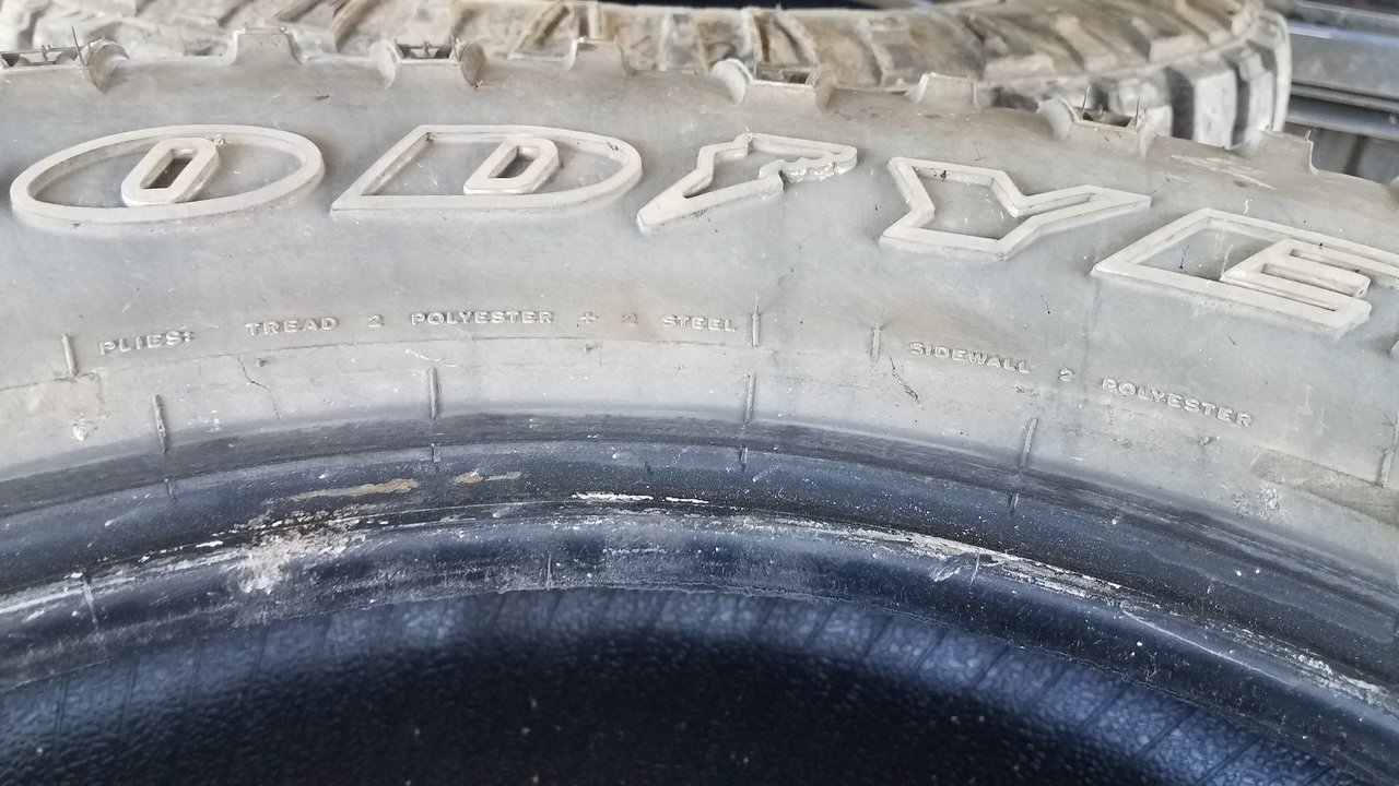

    How old are those tires from the second pictures? From what I understand the 3 ply sidewall on duratracs was on their 1st design. A few years back I had got 2 used but very good shape duratracs and bought 2 new ones to match them. Both Tire Rack and DTD had 2 of the same size (285/75/16) listed at that time so I ordered the "NEW" ones on DTD and when I received them they had the much weaker/softer 2 ply sidewalls. Luckily DTD is awesome to work with and 1 call later they had someone in the warehouse check and confirm to me that the old design had the 3 ply sidewall and the new ones had the 2 ply sidewalls, so they switched them for me right away. Great customer service!

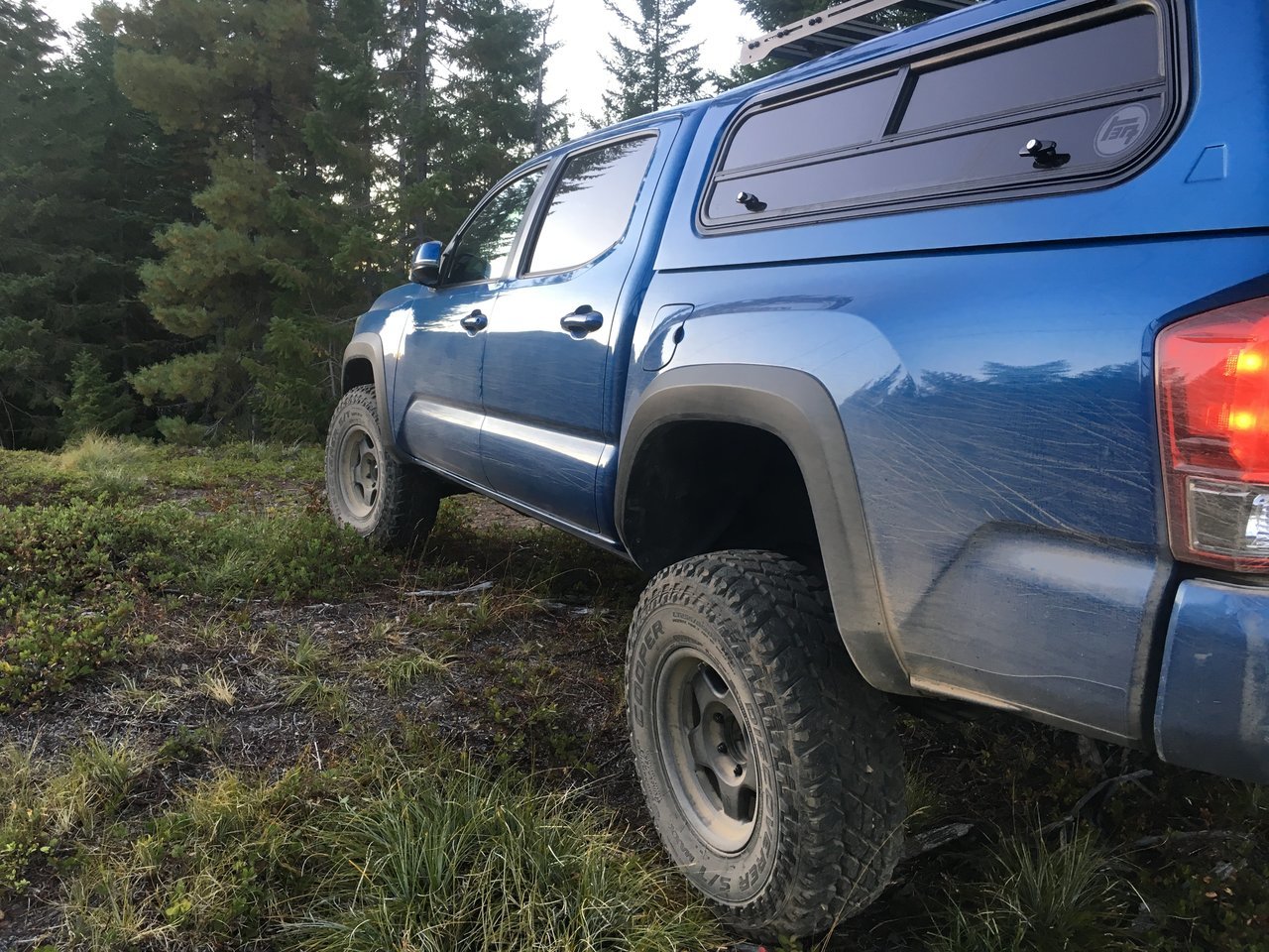

    Exactly what I went from. I thought about going 255 for a little while but figure I don't need the extra drivetrain wear and tear when I haven't had an issue travelling with friends running 255s. The ride is stiffer than a C rated tire, but the truck feels much more surefooted on stock suspension. Not interested in lifting since I have to deal with kiddos in car seats for a while to come. Plus I'll be towing a trailer if I ever get off TW and get it finished

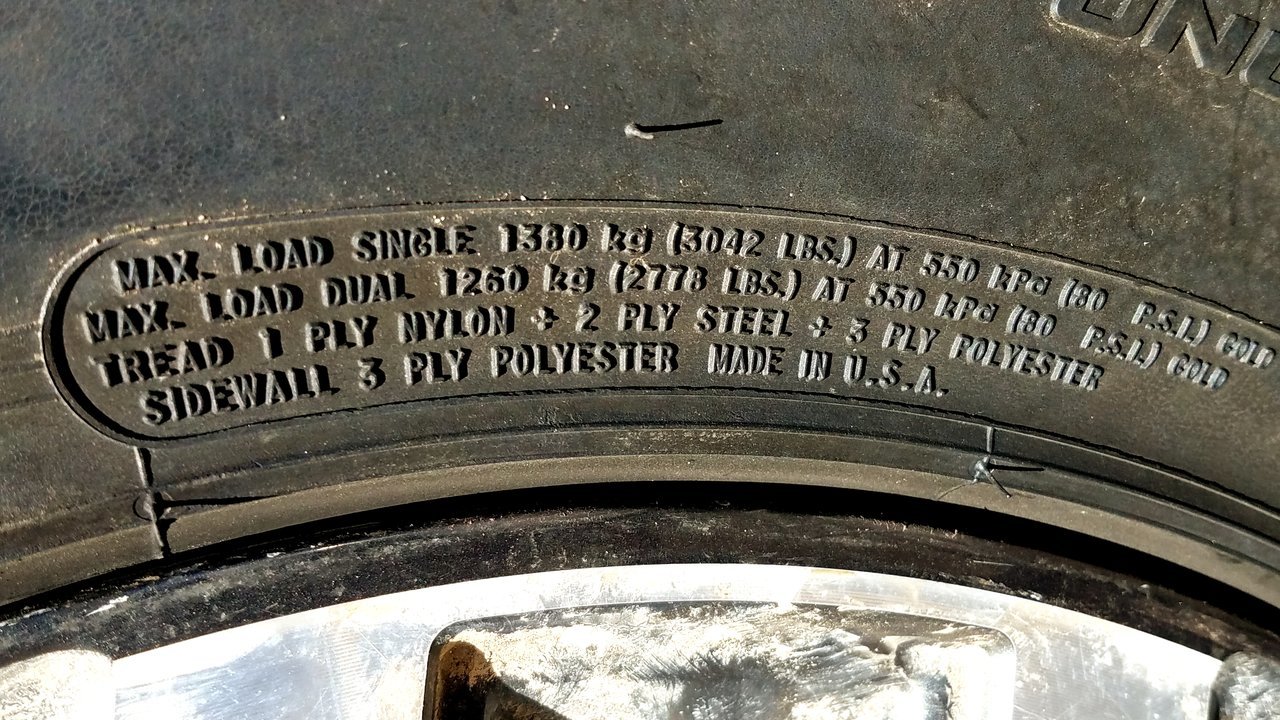

    The ply rating is just a rating. Load range "c" is 6 ply rated for a radial tire or same as a 6 ply bias ply tire. Load range "e" is 10 ply rated in radial construction. It is a load capacity rating. The sidewall construction will vary from tire manufacturer to tire manufacturer.
    There is generally no xtra protection based on ply rating. But the all terrain and mud tires are built with what I like to call "stump protection".

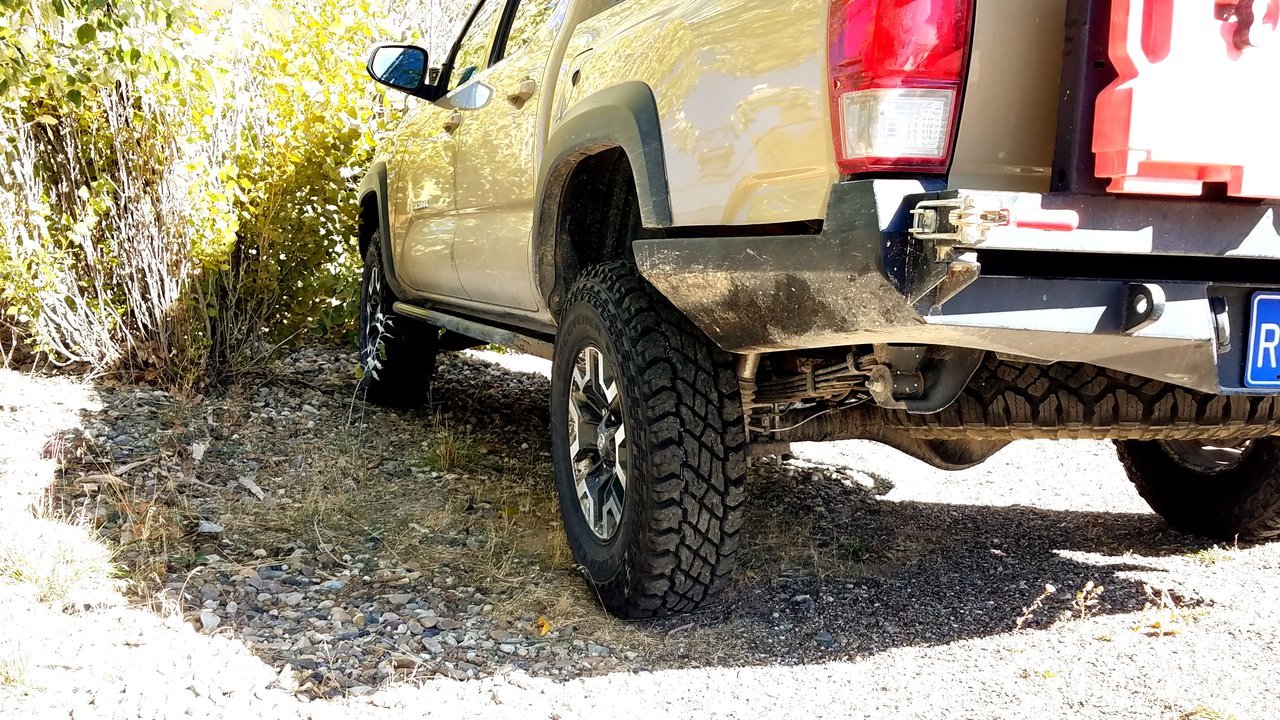

    I like your build OP. Similar to where I'll get some day. I may go with 235's when the stock tires wear out. Haven't decided on those or 265's yet. Probably go with BFG AT's.

    You still lug around the stock spare??
  8. Oct 12, 2017 at 4:25 PM
    #48
    nevadabugle
    nevadabugle [OP] Desert Rat
    Jul 25, 2014
    #134701
    3,990
    Elko, NV
    2016 DCSB TRDOR manual in quicksand
    No. It's a 265 75 duratrac on the stock spare rim underneath. And a second oddball BFG MT on an aftermarket rim on the swing out. Spares dont need to be pretty...just full of air.

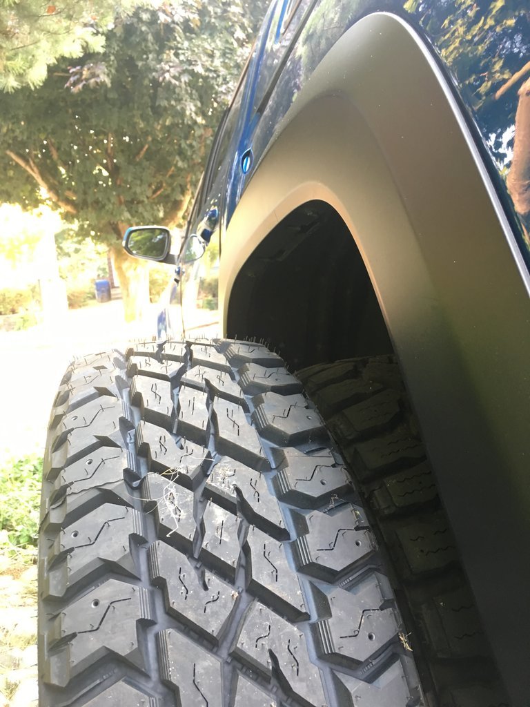

    I switched for a few reasons, but primarily I wanted to go 255/85/16 after doing my suspension. I was also curious if the howl was actually caused by my duratracs, because it literally sounded like a lower frequency whistle, similar to the LCA howl. Also, the reviews of the ST Maxx were nothing but positive, 3 ply sidewalls give me peace of mind. Full size spare fits nicely. If I were going for pure functionality I would probably still have the Duratracs, better for the PNW. Also, the ST Maxx seem to pickup more gravel.
    265/75 duratracs vs 255 coopers unmounted
    255s taking me places I probably shouldn’t be. Notice the pinstriping...

    I got news for you (OP) 6ply and 10 ply is only on the tread. The sidewalls are the same.

    I have some bad news for you. Like others have said, the load rating isn't really related to ply.
    You tires advertise (from the brand not load) they have an extra layer of sidewall - which is good for your truck and use.
    Mine aren't 10 ply nor are they e rated. I have the same tread and sidewall as your "10 ply" tires.
    More of the issue is with the duratrac tires. They suck period. ;)
