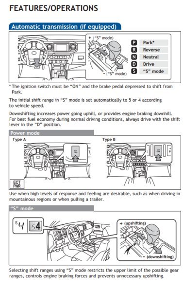

    It's normal for a truck with two OD gears if you leave it in D.
    If this happens use ECT or kick it over to S mode if you want it to reduce unnecessary upshifting like the manual says.
    Transmission is configurable so the OP should learn how to use it. Some don't like it because its different than other trucks and consider it a problem.
    OP should decide where he falls on the matter.

    Yes but you know you can remove 5 and / or 6 with S mode to reconfigure.
    Is it the best choice of transmissions, not really but you can learn to optimize by using the available features. If that's too much to contend with then consider shopping a different truck. For you 4Runner fans this drive train is also rumored to be used in the next gen 4runner soon.
    If I recall correctly, the 2nd gen transmissions also suffer shift flair so it's been longer than 2.5 years for Aisin and it's not just a symptom in 3rd gen Toyota trucks.

    There is a difference, it won't shift into 6th when in S5 but will still drop to 4th if the incline is up enough to maintain speed.
    I don't suppose you tried dropping the speed to 65-70 just to see if that also made a difference?
