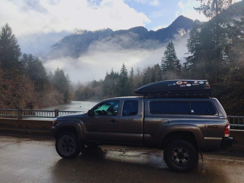

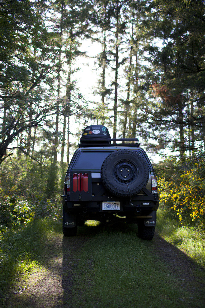

    Couple photos from thrashing it today in the Pacific Northwest. Big changes heading it's way soon...rear swing out from Pelfrybilt will be shipping out in a few days as well as 4x innovations sliders showing up shortly. Should all be on within a few weeks. Also looking into maybe getting a prinsu access cab rack to match the rear topper rack.

    Nice! Where did you go?

    Haha definitely not Spokane. Took the trip out to Goldmyer hot springs near Snoqualmie. 9 miles of extraordinarily horrendous pothole road and 5 more miles of decently fun loose big rock stuff. Well worth the brain rattling though when you get up there.

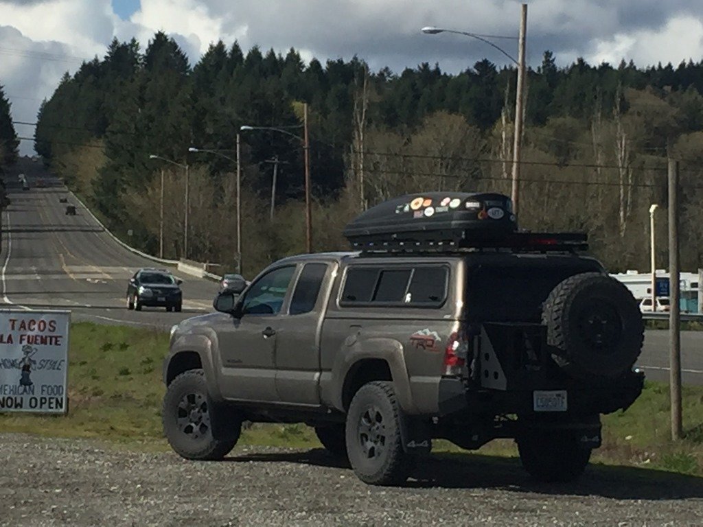

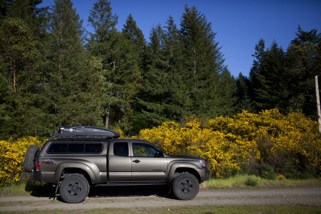

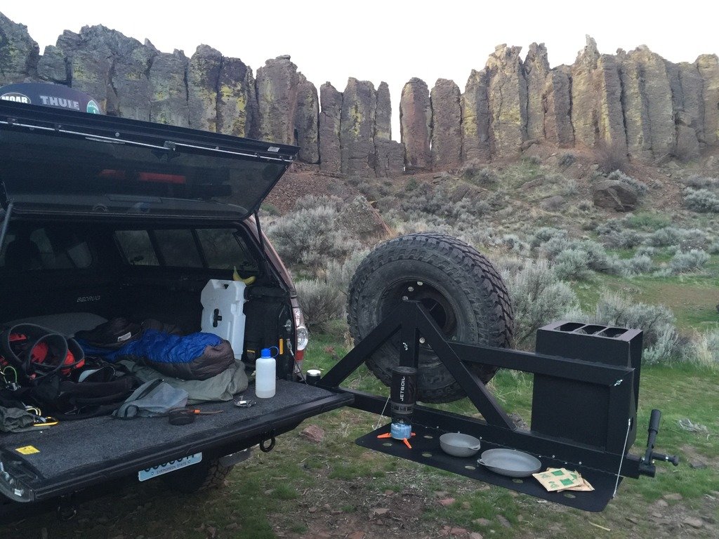

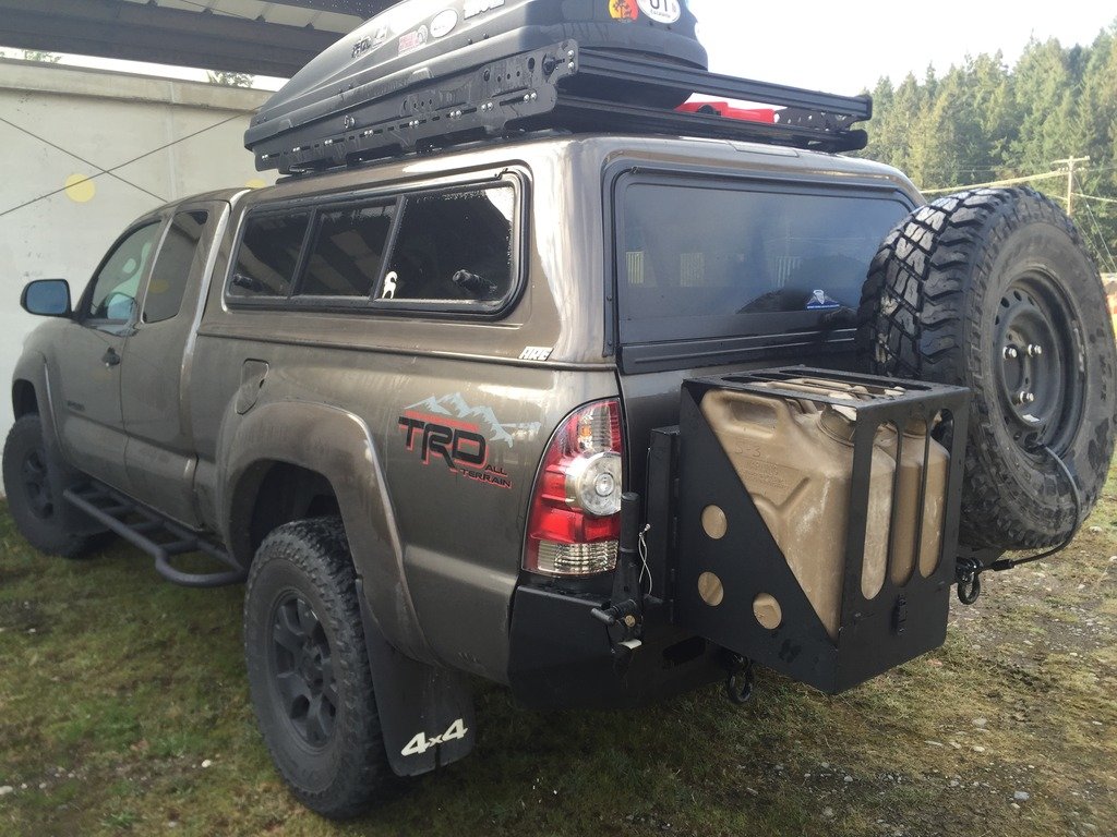

    Got the Pelfrybilt rear swingout bumper in after months of waiting haha worth the wait. Only complaint I have is that the swingout mount could be a bit more stout, it tends to flex around a bit. To their credit they did say they would be sending out gussets to weld on and strengthen the mount. Looking forward to that. Sorry for the crap photos, I'll be taking some better ones within the week.
    IMG_6354_zpstpdd0x26_0a23852bf2cf76676b40354e9dbc7d13fec21a50.jpg IMG_6356_zpsidljx9wy_5df8b54bc849c0dcc056ed34453b120266bd5f9c.jpg IMG_6655_zpshnyv6pso_7115a6b78ef2f4c7111c07f6e5ea57fefb738292.jpg IMG_6571_zps2k5tr6js_c262481894cbba824bab206d58c4ee6830c92b6e.jpg IMG_6444_zpsljcpzdvn_310b613d9bba2440210598adfda54c9e1bb95396.jpg
    Also got some 4x Innovations sliders on right afterwards. Bad photo of them but oh well. More will come.

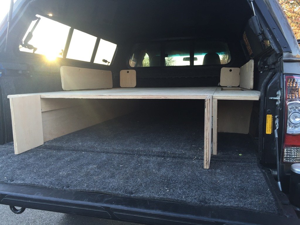

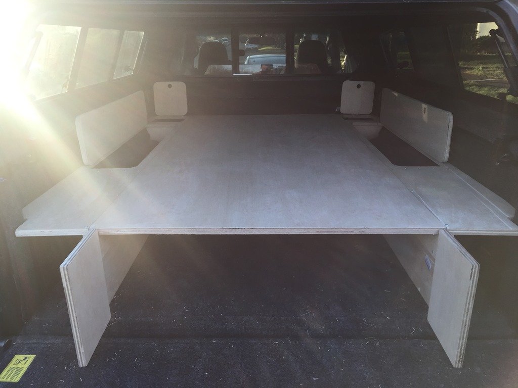

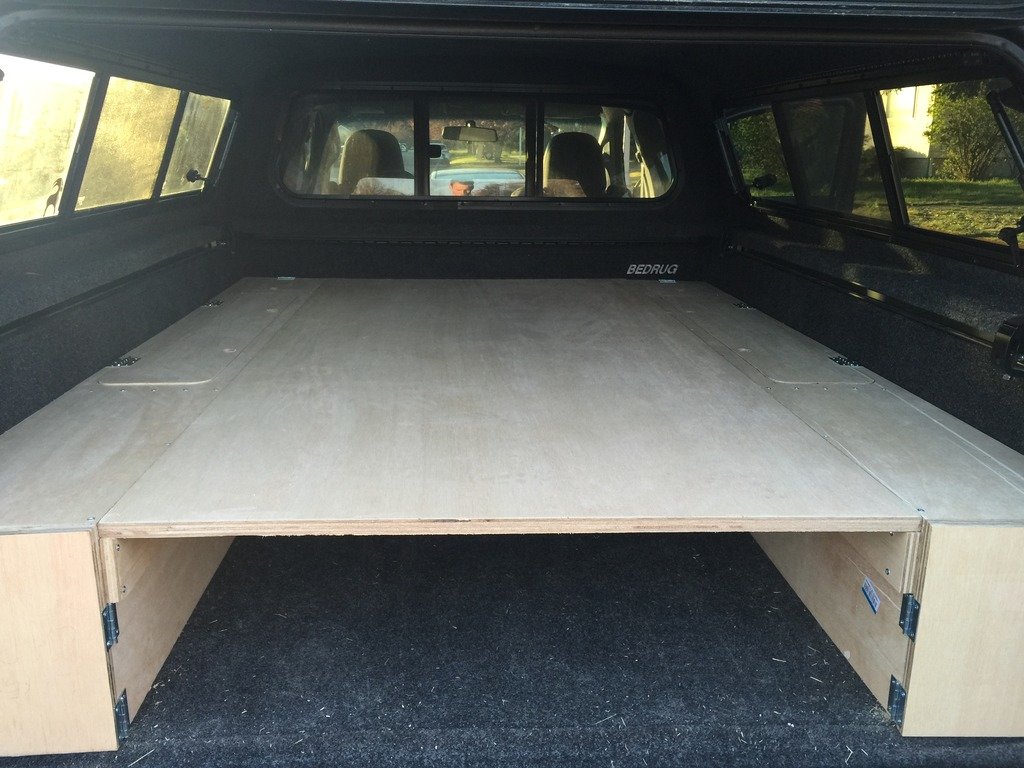

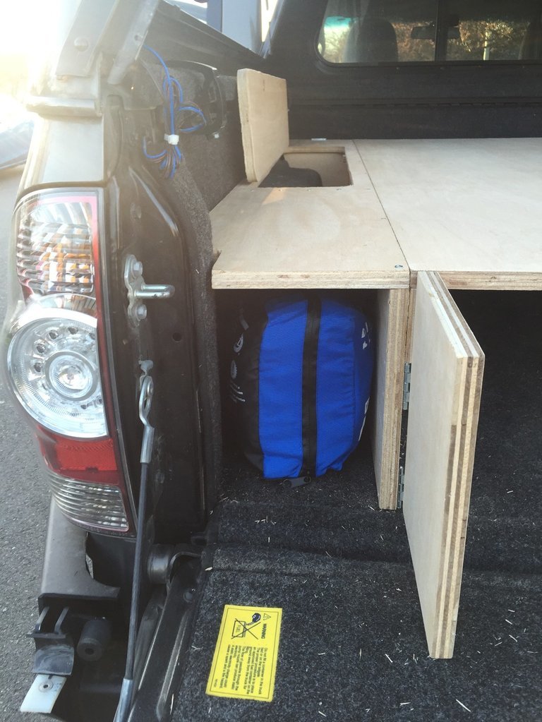

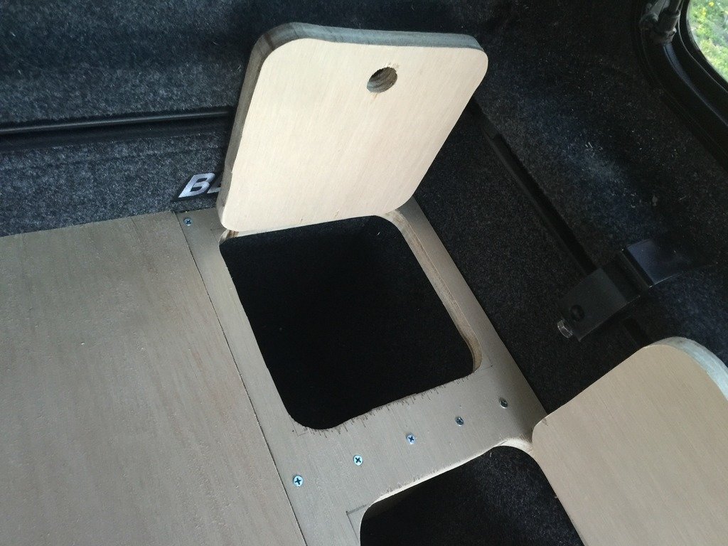

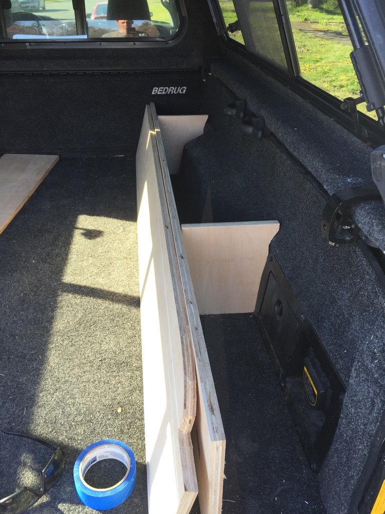

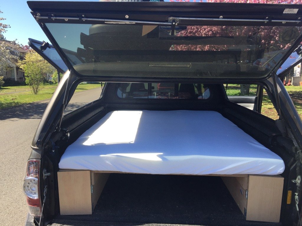

    Then the latest project that took a few days to get done was my storage/sleeping platform. More work is needed on it for sure, needs to be cleaned up and I want to carpet it to match the rest of the back. The center section sits on rails and can be easily pulled out allowing the two wheel well boxes to also easily be pulled out so the whole system is removable. I didn't really have any idea what I was doing with all this cabinetry stuff so it's pretty amateur hour but it turned out alright all things considered. Very overbuilt so it shouldn't be breaking anytime soon. All the top doors are accessible from the windoors so there isn't even a need to open the rear gate. Was much more complicated to design and build than I anticipated though haha good learning process. If you have any questions about it feel free to ask. Total cost was about 125 bucks for materials.

    do you feel like the swingout is a little shaky when swung out? I just picked up a used pelfrey with the swingout, and when I have it opened, i can tap on the gate, and I think its swaying just a little bit. Im not sure if its the welds where the pivot is, or the rear suspension that I am feeling
    *edit* I just read your description. Glad Im not the only one that feels like its not as sturdy as it could be

    Great pics! Good looking taco... The sleeping platform looks great also.
    What are you using as a mattress?

    Yea the metal has some significant bend to it especially when it's in the open position. You could contact them and ask for some of the gussets they're going to be making. Easy weld job, might fix the issue.

    I think I'm just going to get some memory foam and egg crate combined and cut to the right size for it. Car camping is car camping, might as well make it super comfortable haha

    Memory foam mattress is in. Thinking I may want to add a little more cushion underneath but we'll see after I spend a night or two on it.

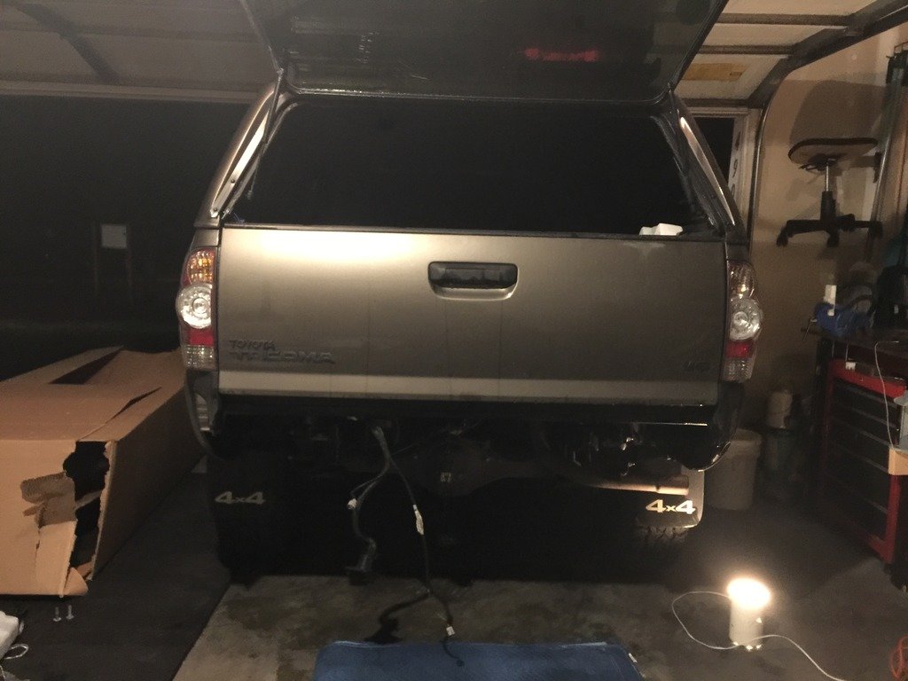

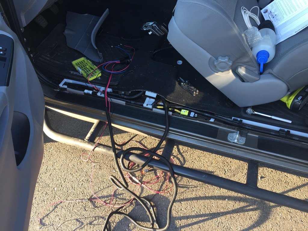

    Finally installed and wired up my Rigid SRQ reverse lights into my Pelfeybilt bumper. These things are SO much better than the stock reverse lights. Bonus, if someone is tailgating me I can turn them on and blind people.
