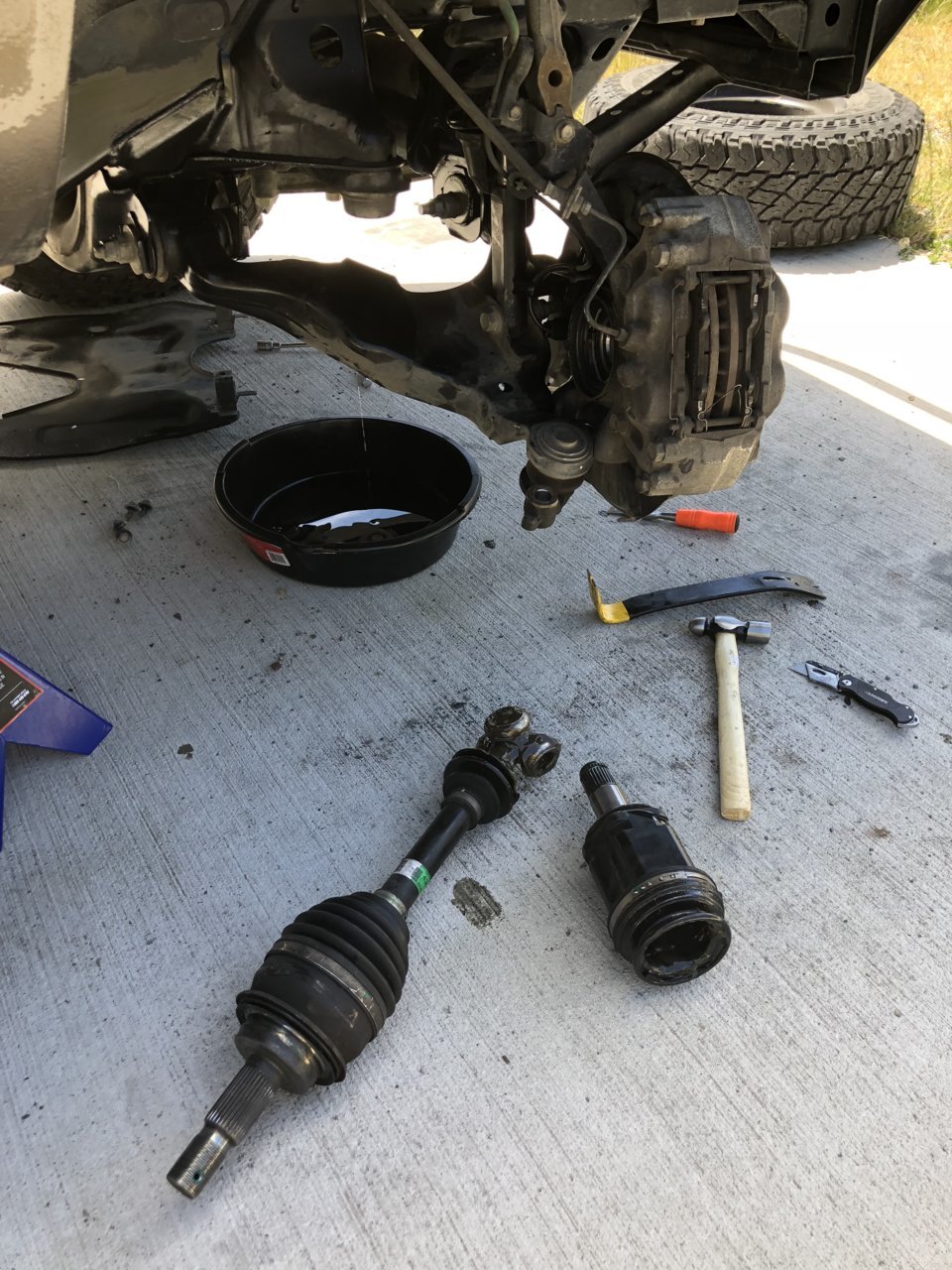

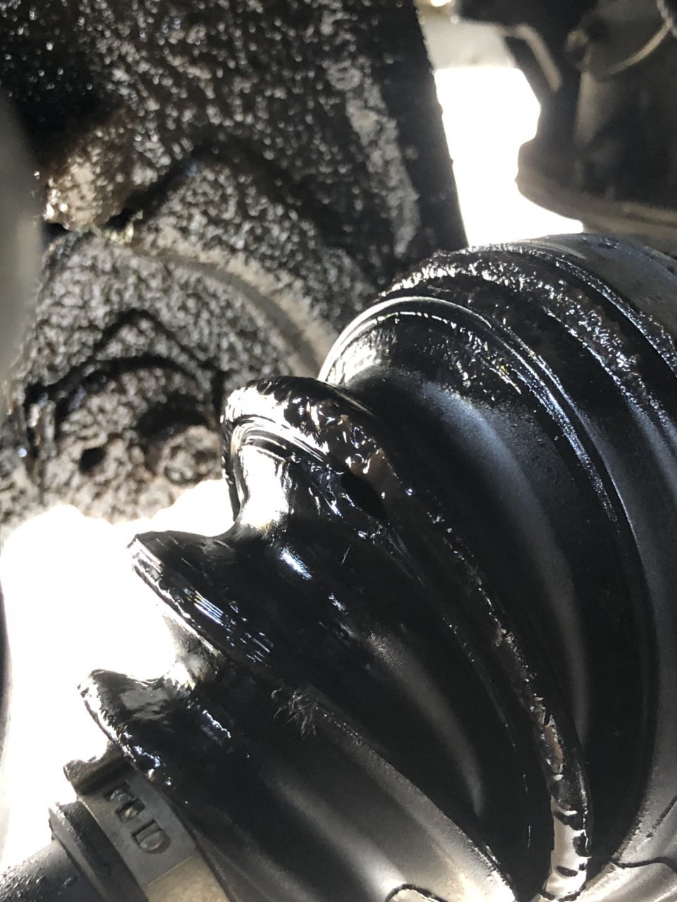

    9C1A01AC-B63A-416F-AC72-3BC45F5CF2FB.jpg So I finally tore an inner cv boot. Decided to go with CVJ Axles and went with their purpose built boots for Tacoma lifts. Pretty happy with it so far.

    The inner boot of my driver side has just torn as well. How hard was it to swap the boot out? I've never done it before, and have read that it's just easier to swap the whole axle.
  12. Jun 4, 2018 at 8:38 AM
    #152
    I3uller
    I3uller [OP] Well-Known Member
    Jan 18, 2009
    #12709
    393
    Too far South
    I swapped the entire axle out. It wasn’t that much more. I got a rebuilt OEM axle with the upgraded boot from CVJ. Install was relatively straight forward. You’ll get a hundred bucks back for your old core when you send it in

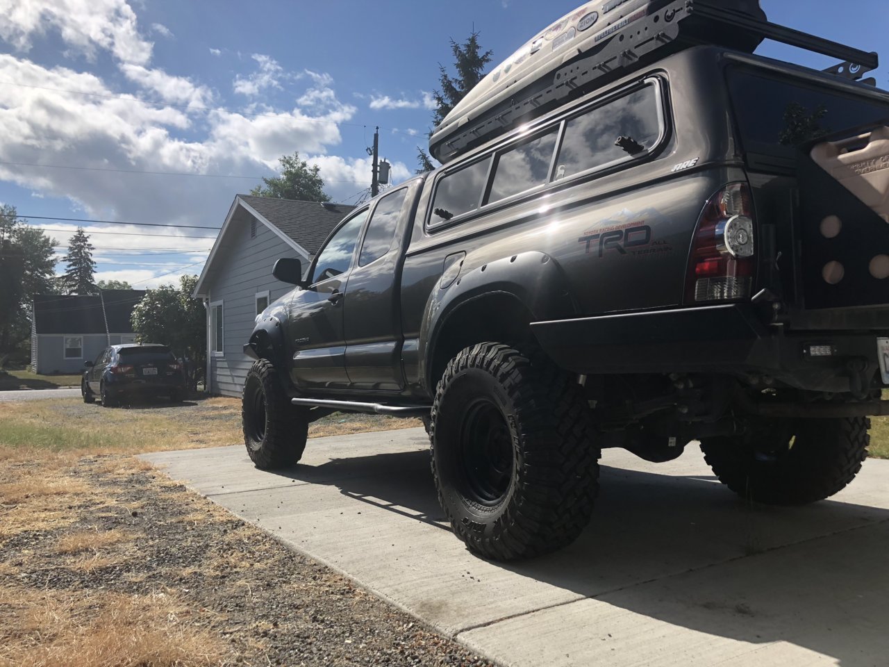

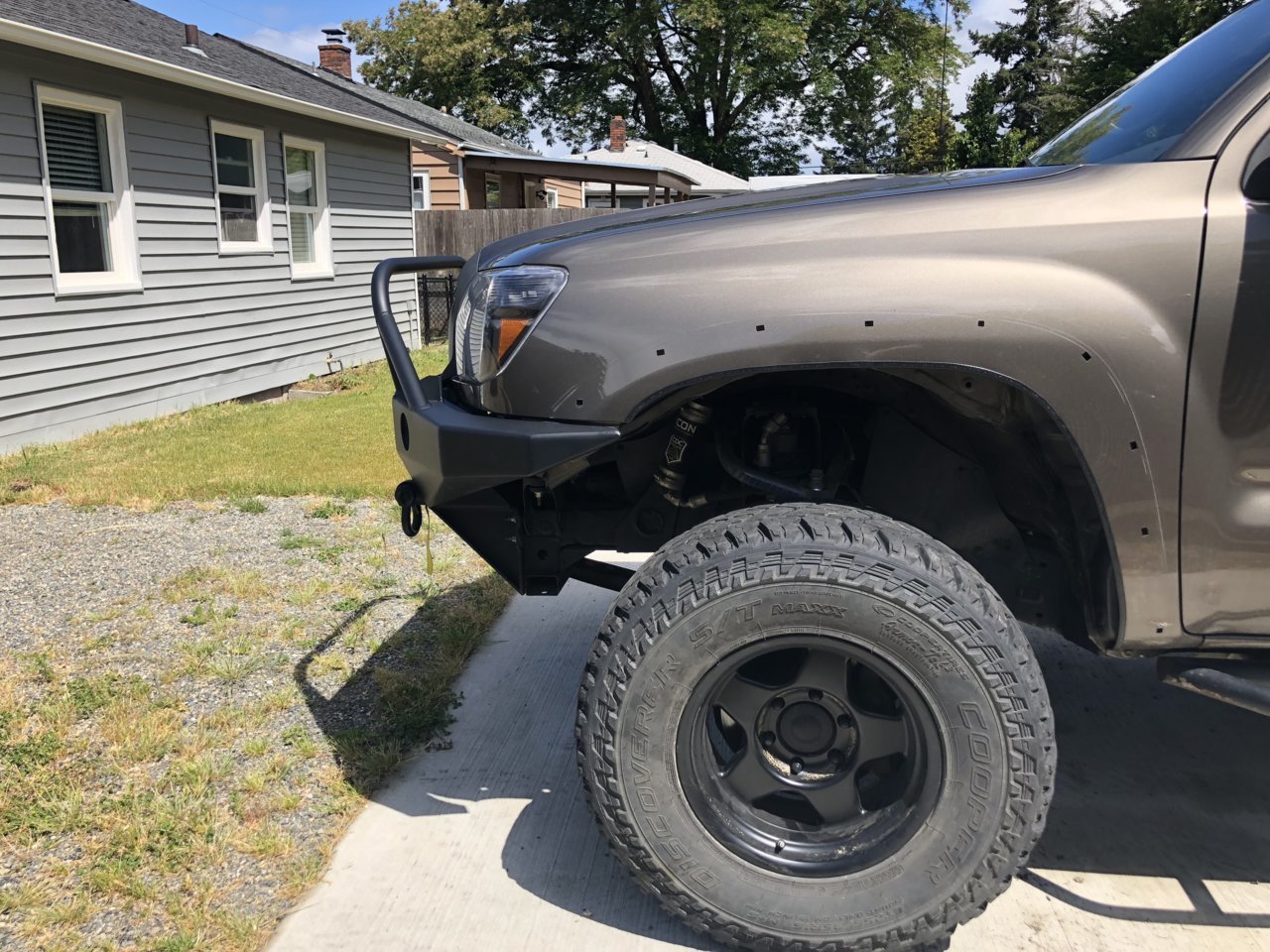

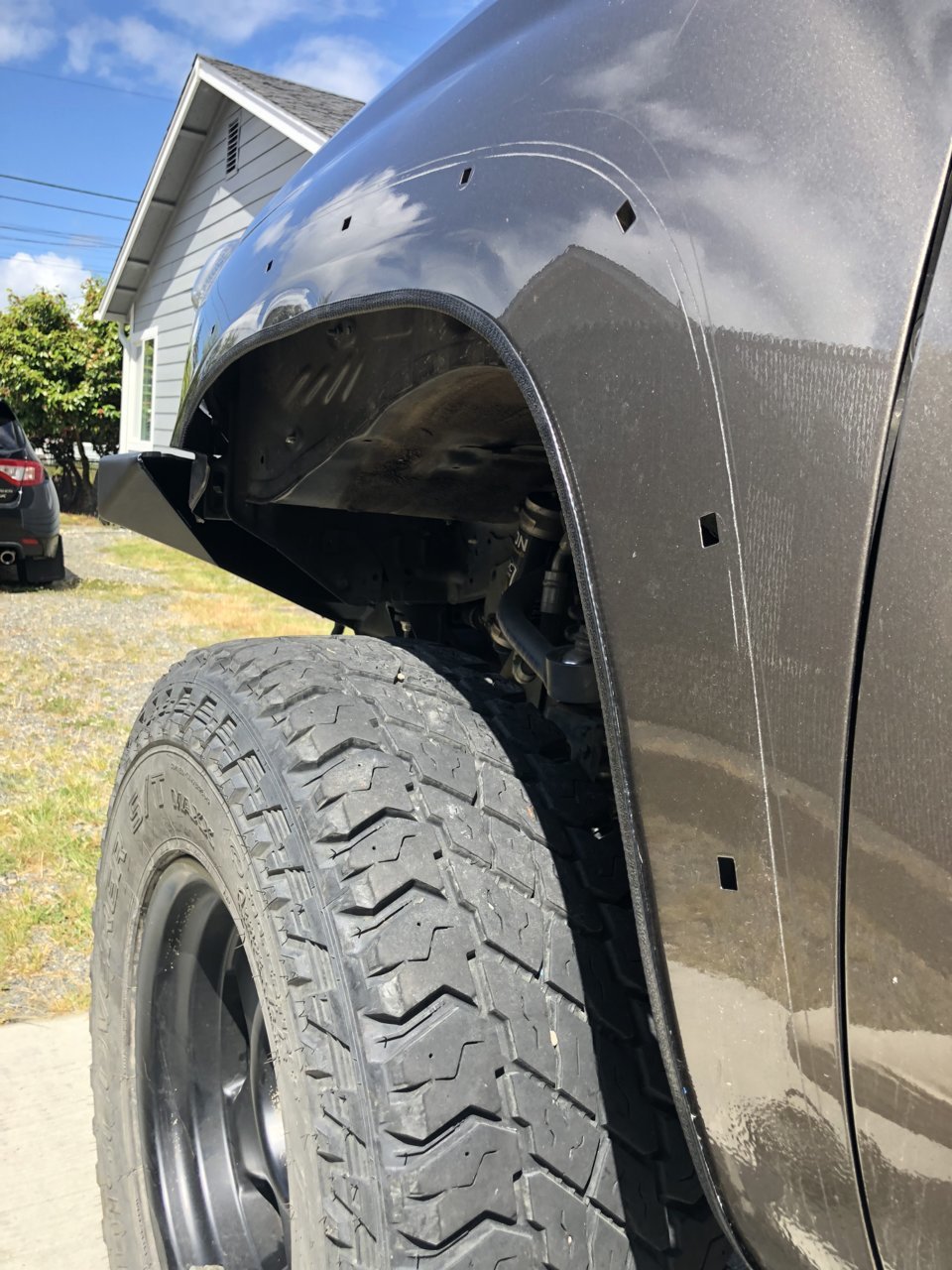

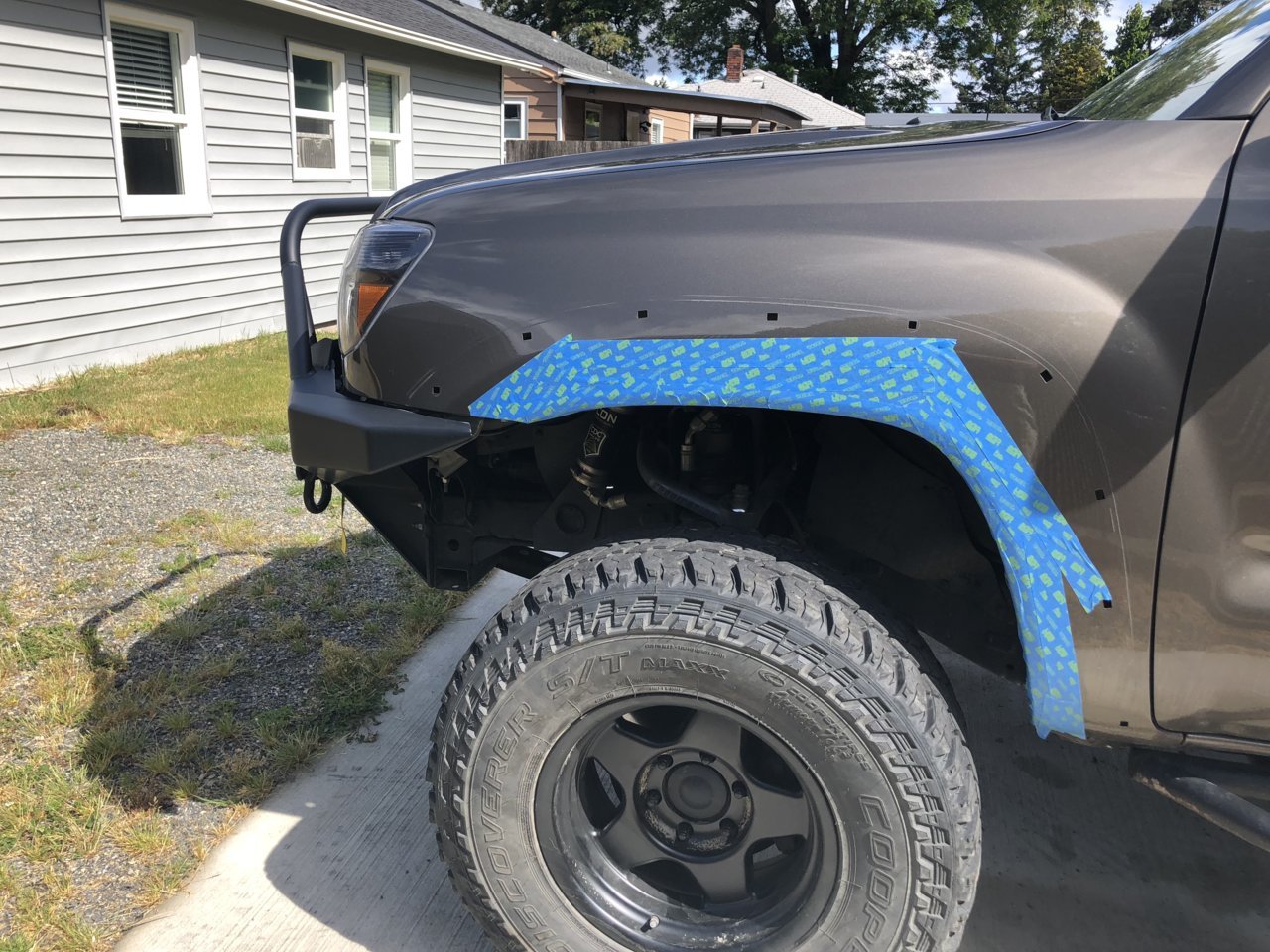

    Finally made the jump and cut the fenders to fit the 35’s. Really wasn’t as bad as I thought it would be. I taped it out and measured 2” and started getting after it with a sheet metal nibbler. Worked pretty well. The nibbler did kind of tweak some of the thin sheet metal in spots but with the flares back on you’ll never notice it. Added some hefty weather stripping to protect it as well. Just need to cut up the flares and drill them into the fenders...then I can flex it all out and realize I still rub haha

    Haha I was going to wait until I had it all done but oh well. Still need to trim the rear fenders and flares...looks kinda silly with the fronts done and the rears not.
    So far no rubbing at all on street and minor flex. Doing the WA BDR over the week of the 4th so I’m sure I’ll have some spots to work on when I get done with that. Overall very surprised at how well it still drives. Minor noise increase, barely noticeable power loss with the 6 speed manual, and it actually drives a bit more comfortably with the 35’s. Very happy with the MT01’s so far.

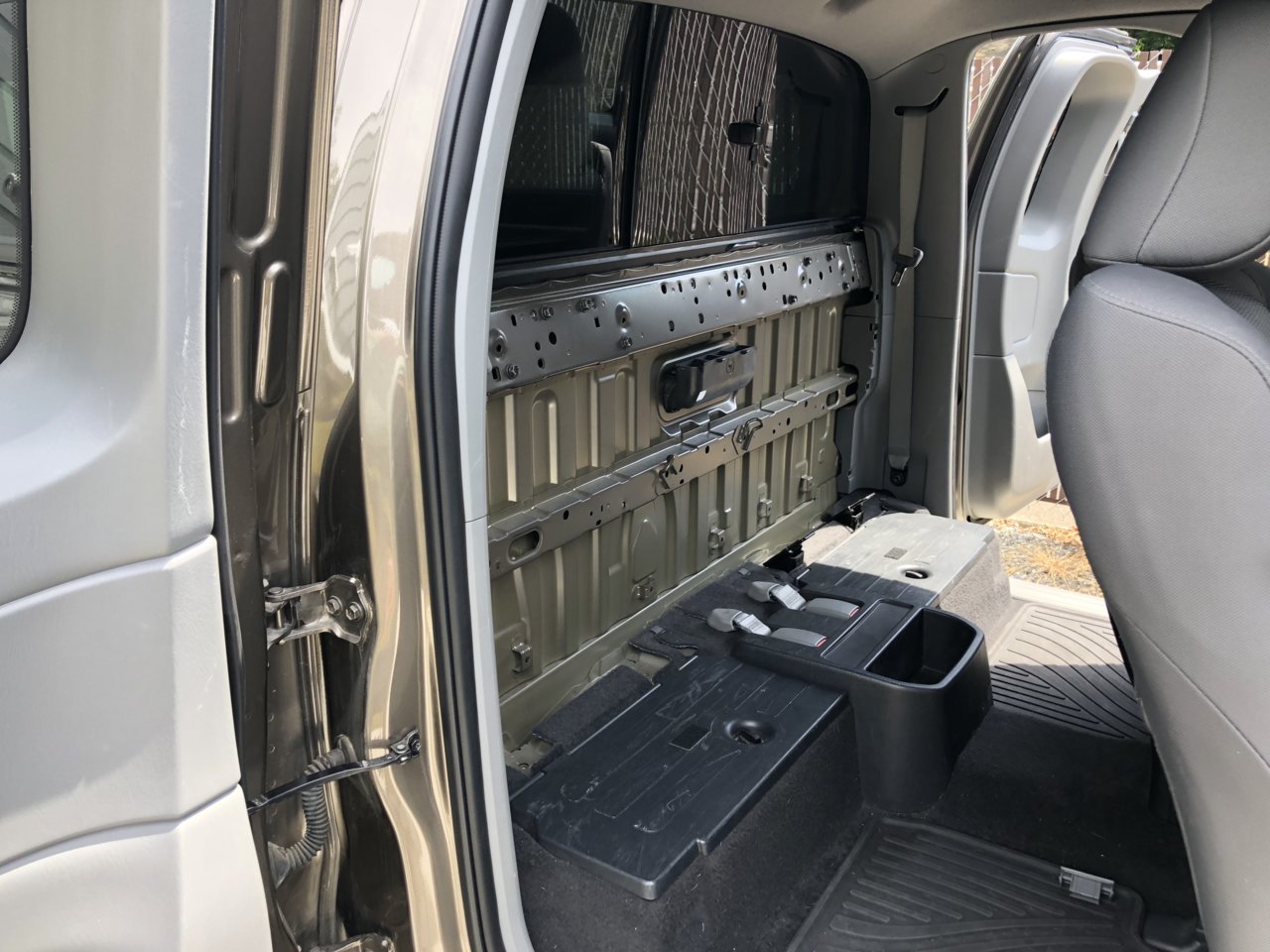

    09F4E9F9-CB2D-4B67-B6DF-31C7200E348E.jpg Also ripped out the rear seat backs finally. Significantly more room in the access cab. Once I build a flat platform in the back I’ll look into sound deadening and making it look a little nicer. For now practicality wins.

    Awesome! Shaping into one of the baddest access cabs out there :cool: Pelfrey's front bumper looks absolutely perfect proportionality wise with 35's. It's been 7 weeks so I should be getting tracking info this week for mine. Will you have to trim the rear bumper at all?
    I'm really liking the seats pulled, too. Looking forward to seeing what you do with that space.
