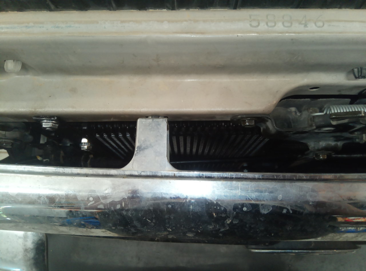

    Add a transmission cooler.
    I'm in AZ as well and it dropped my temps about 30 degrees.
    Here's a not so great pic.
    j4roe[QUOTED][OP] likes this.
