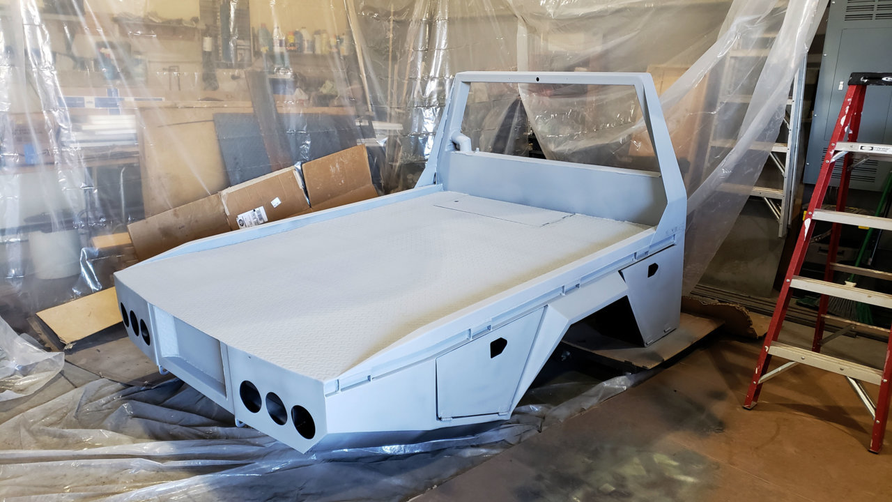

    2004 Tacoma Access Cab 4x4 V6 Standard
    Mid travel lift. Cold air intake. Flatbed in progress.

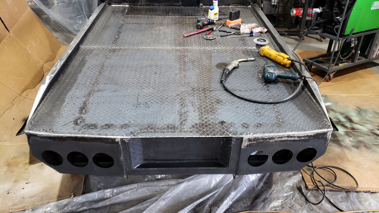

    Primer and paint on the bottom of the flatbed. Best place to figure out the paint mix and gun setup. A little orange peel here and there. I need to get it flowing better for the sides and top, where it will be more visible. Satin finish, so quite a bit of wiggle room.

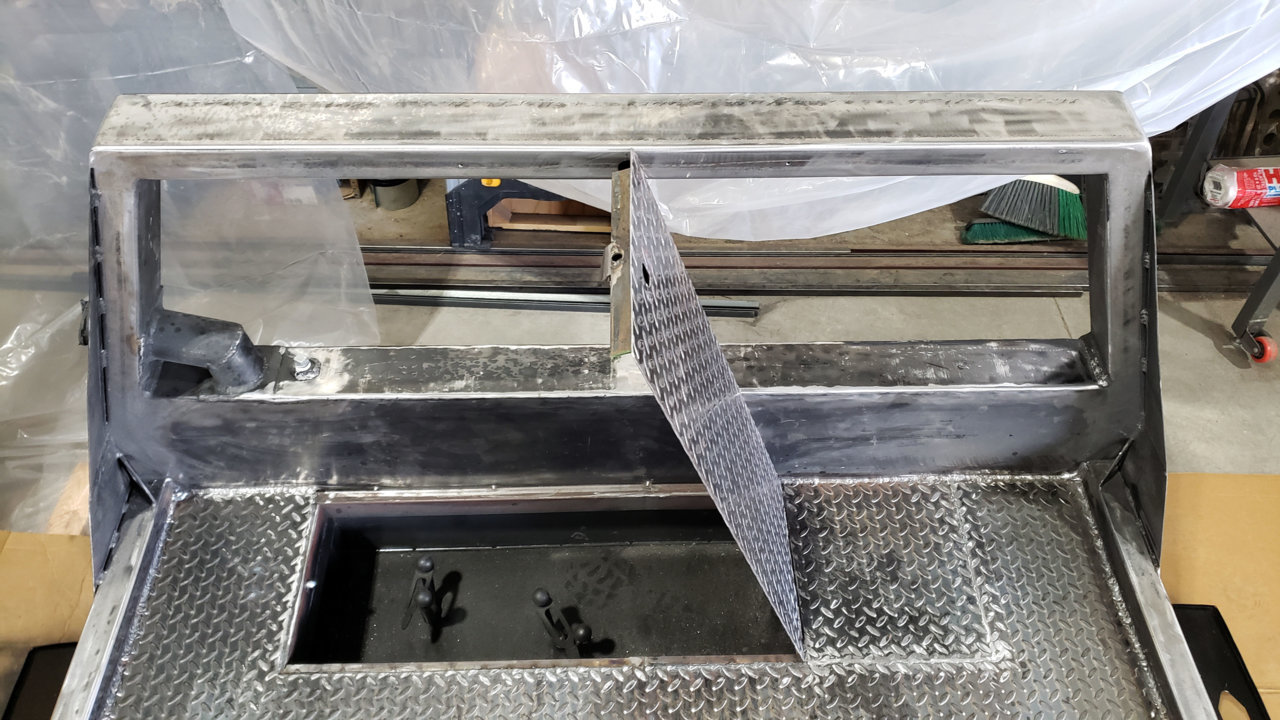

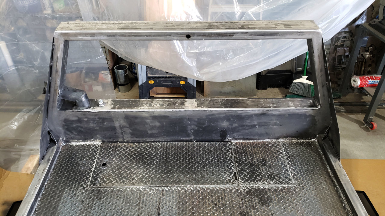

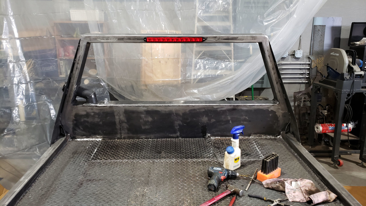

    Today, I wrapped up a few details on the top, before painting. Finished up the door and latch for the front deck storage box. Drilled and tapped the headache rack for the center brake light. Finally, I cleaned up the rear deck weld, now that it is down where I can see and reach it easily.
    I have one more detail to add on the toolbox door that covers the fuel filler neck and cap. It needs a slight bump out so that the stock filler neck works without any modification. I'll take care of that tomorrow and then start prep, prime and paint for the top and sides.

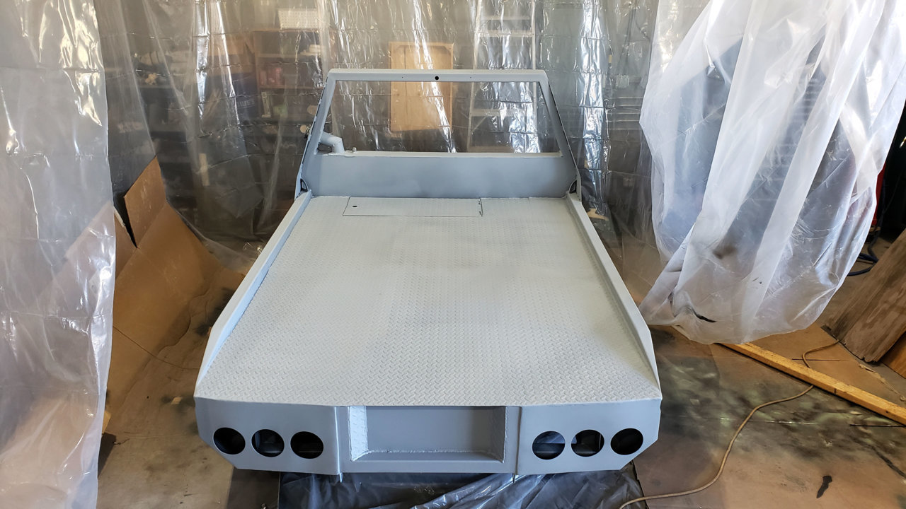

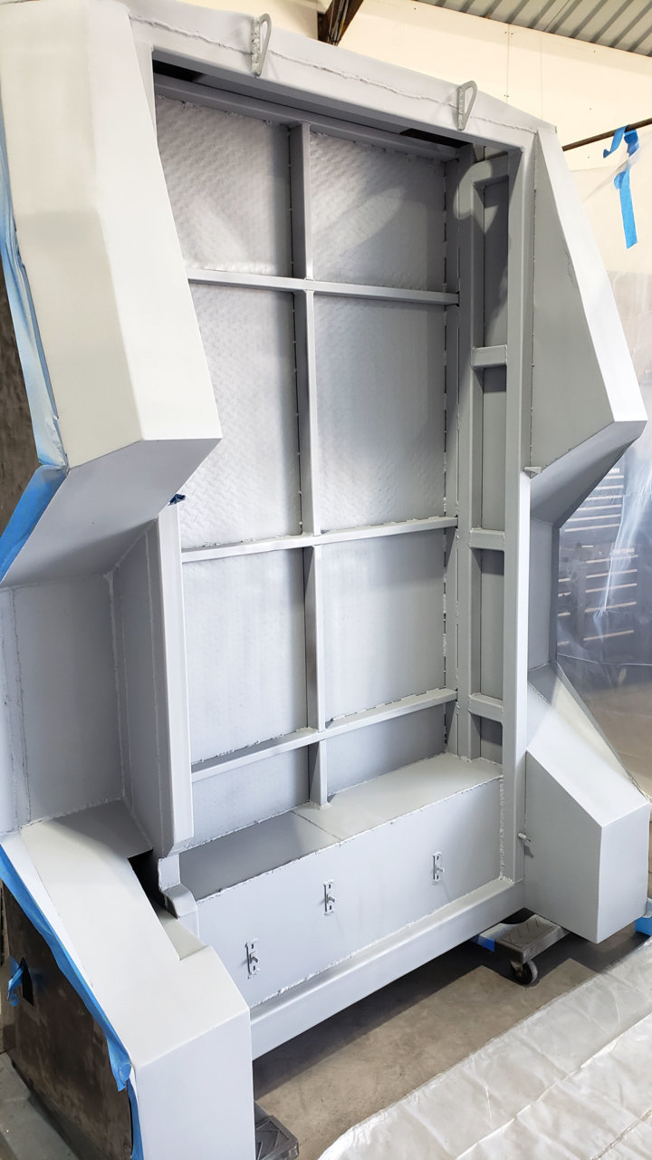

    Primer done on the top and sides. Getting close to wrapping this up.
