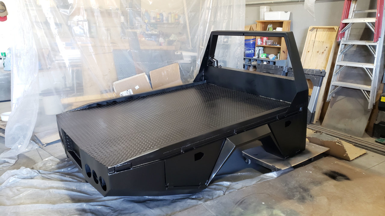

    Even with the same look and features, I'd change up the methods as well as the weight reduction. Building the boxes directly onto the frame was interesting, but much faster to build them separate and install them after. Same with the transfer tank. I'd go for an overall reduction in parts count and simplify quite a bit. Faster, more consistency and less expensive. We'll see.

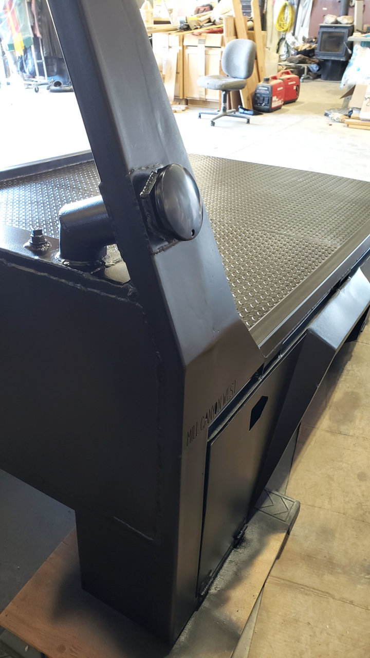

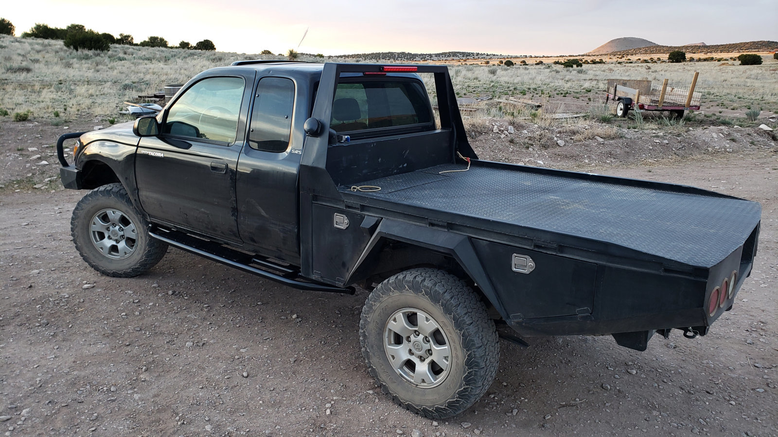

    And with paint. I like the results, but not the process so much.

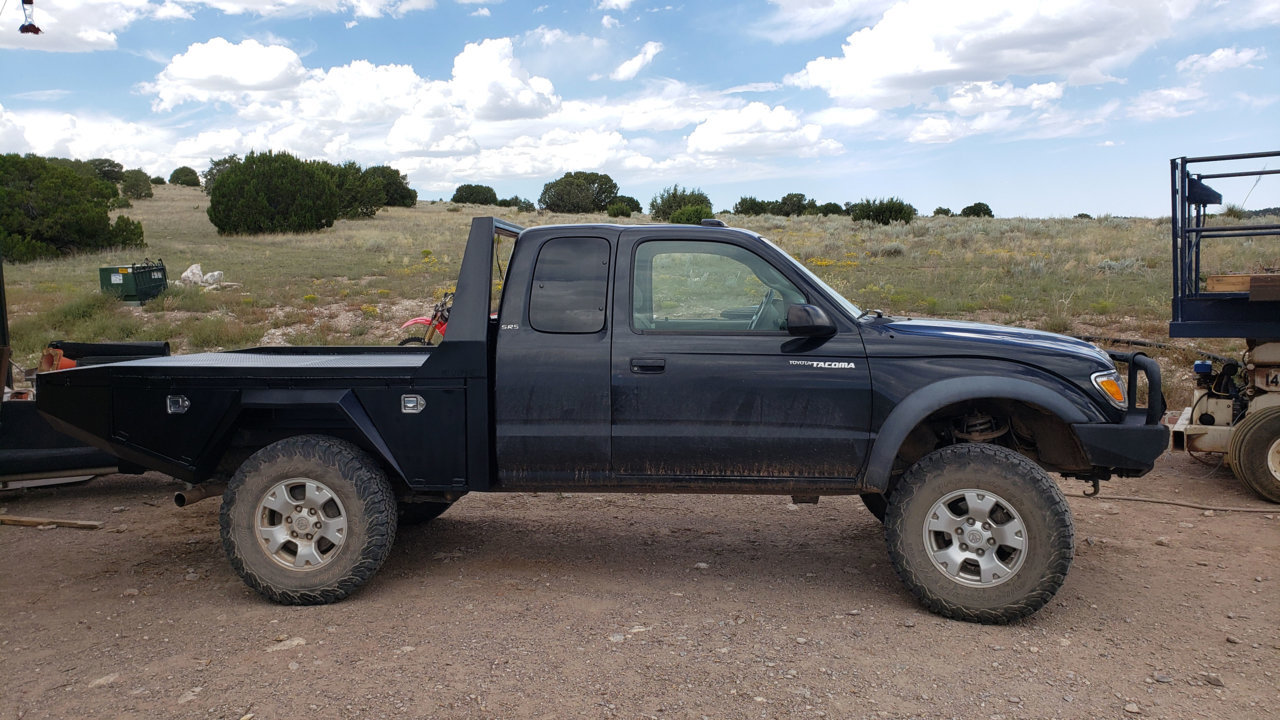

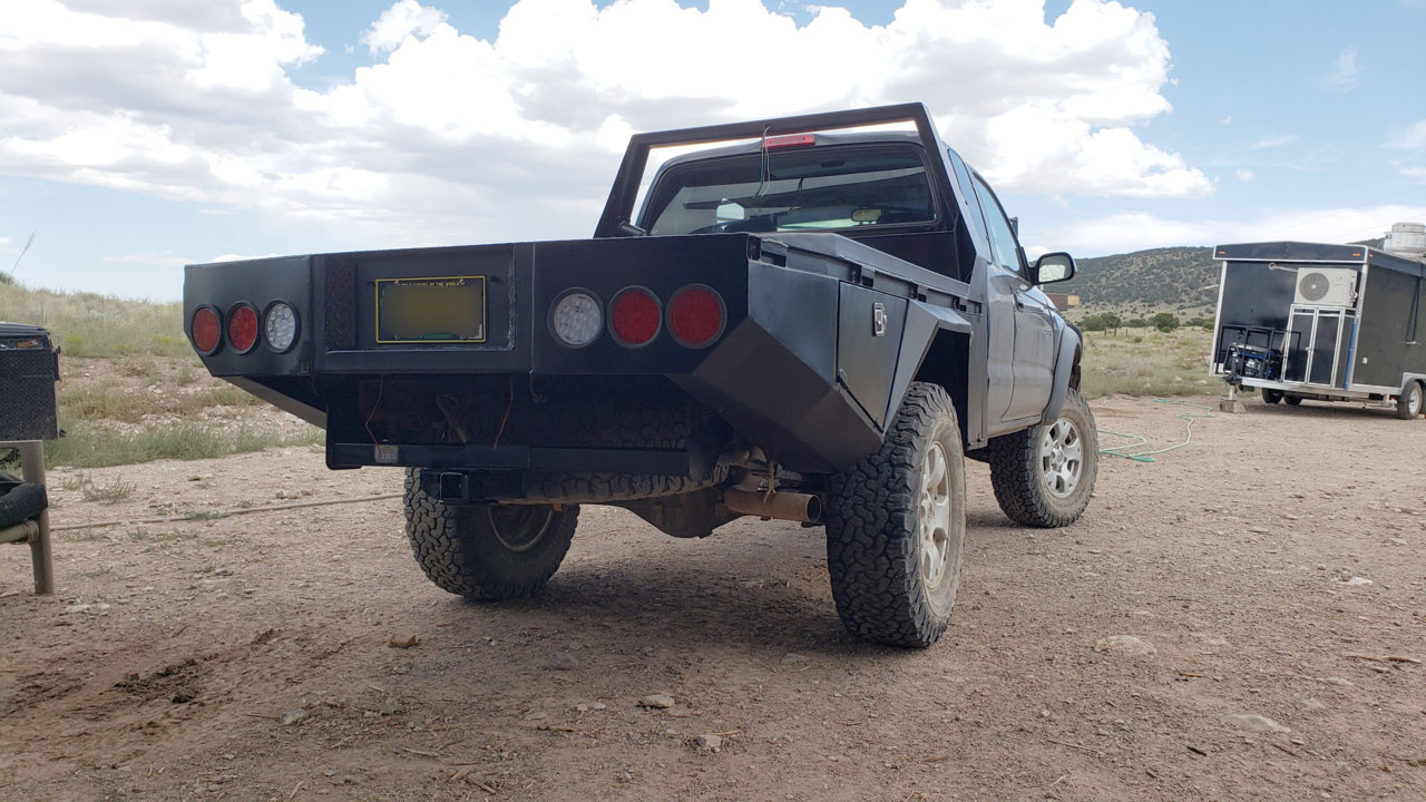

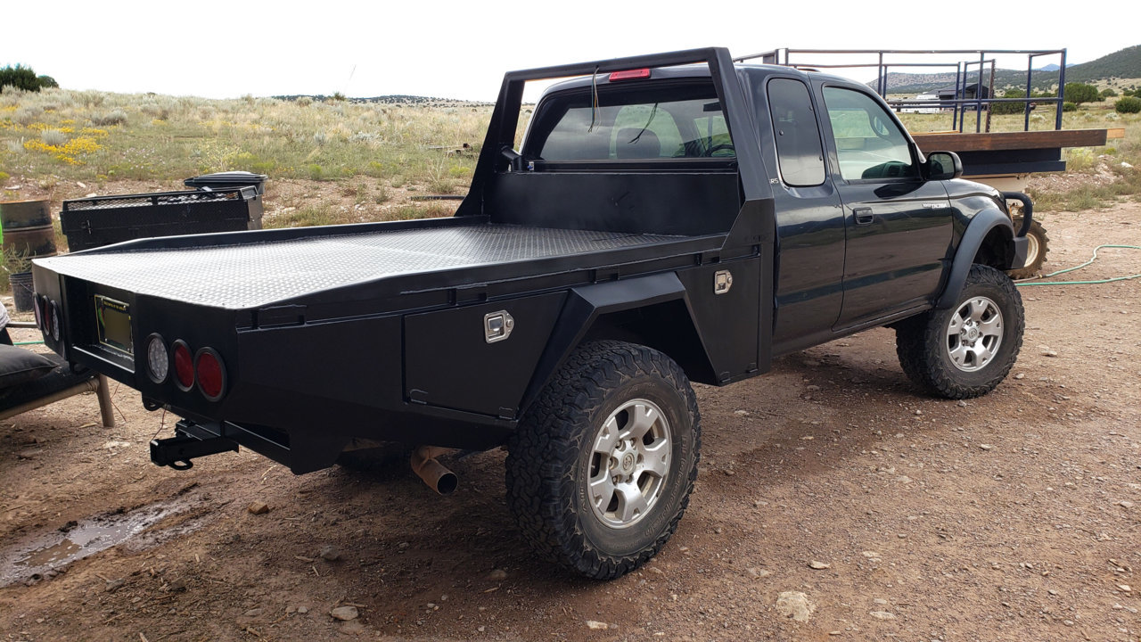

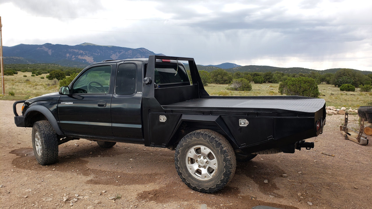

    Got the flatbed on the truck today. Did the toolbox door latches, weather stripping, installed the plumbing for the transfer tank, hung the license plate and finished all the wiring about a half hour ago. Good day.

    It's surprising you didn't design in or add on any side stake-pocket option. Seems like that would be very useful, giving the option to add stout wooden (or even metal) temporary bed sides of whatever height in future. What was your reasoning for omitting them?

    I guess it's not something I've used much. When I did the tie downs, I wanted to keep the sides pretty clean, so built them into the channel. Most flatbeds have the combo stake-pocket/tie-down running around the outside. Easy to do, but didn't want that look. I guess the answer is vaguely aesthetics.
    I agree that there are many ways to add them and they can be very useful. It just didn't rise to the top on this design.

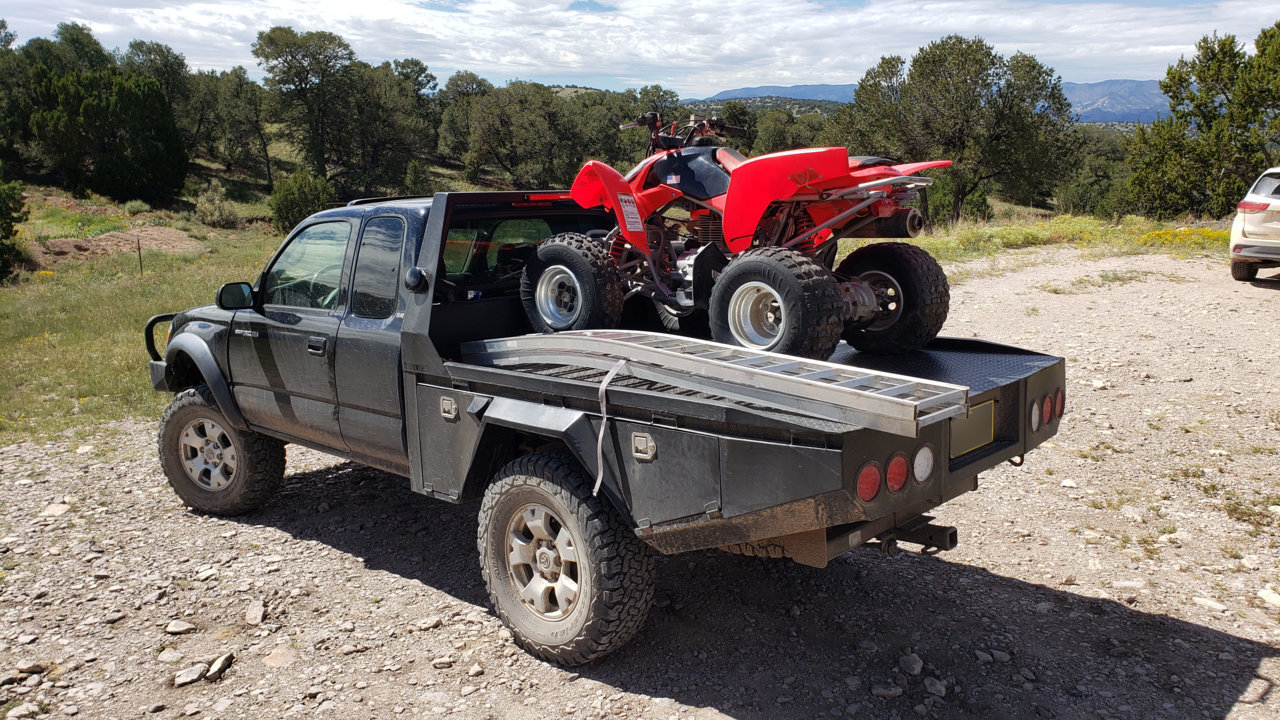

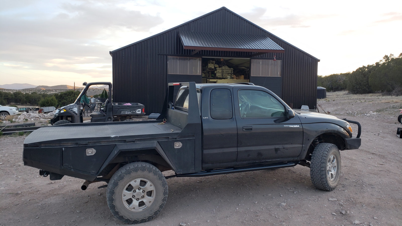

    Working out so far.

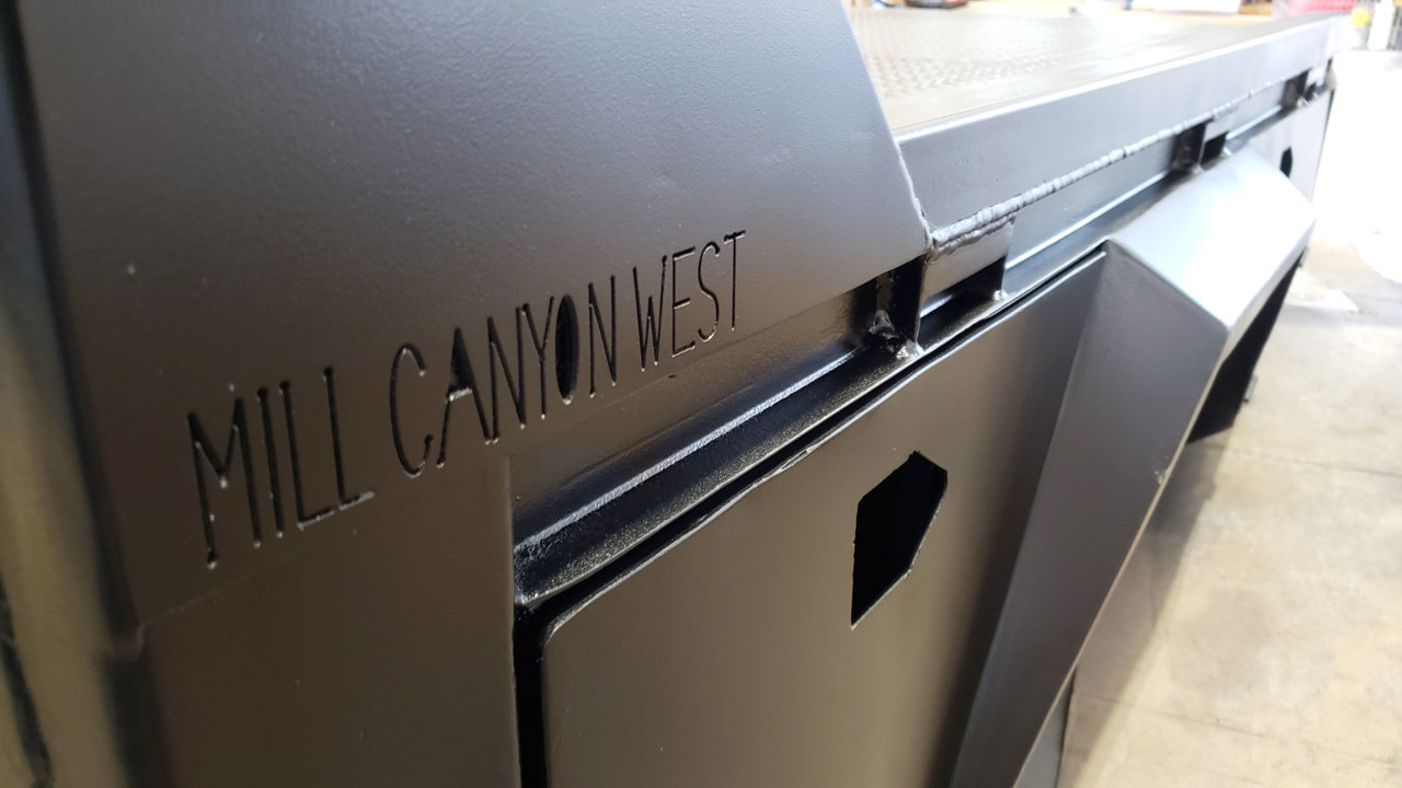

    Did this messing around with some scrap on the plasma table yesterday. Paint went a little sideways. About a week of driving out here and it will match everything else on the truck.

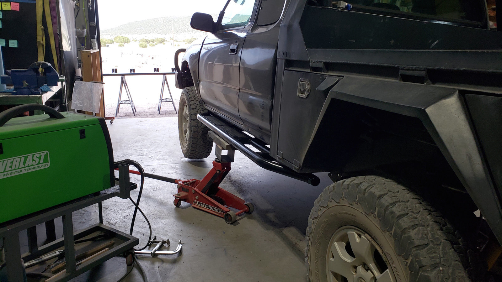

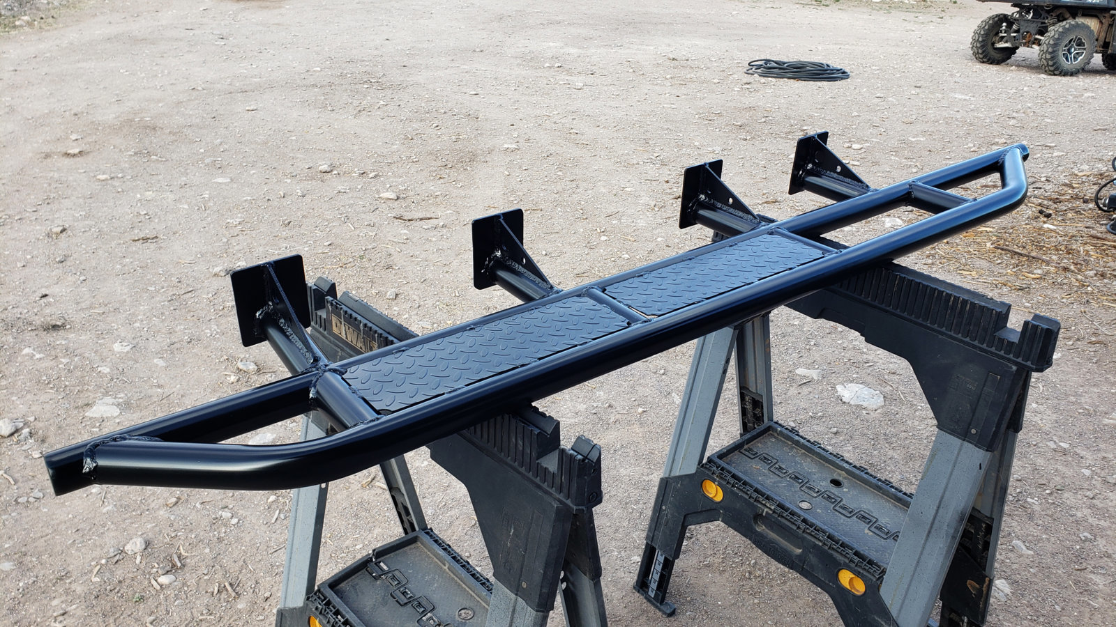

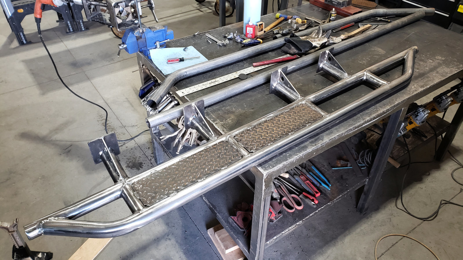

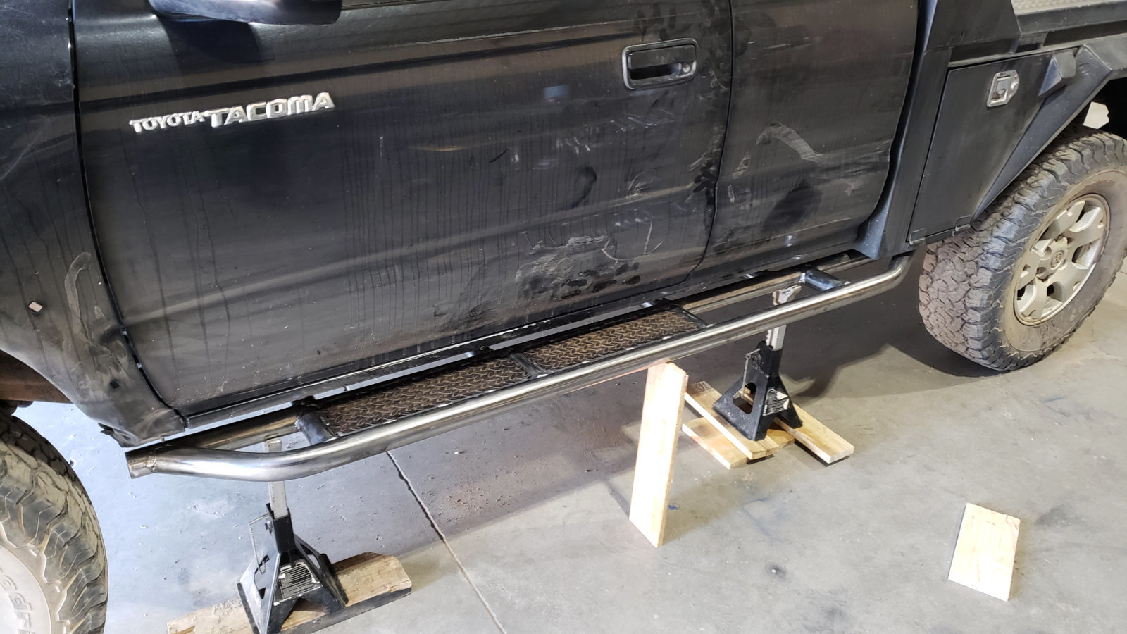

    Added some tube bending capability to the shop a few weeks ago. Felt obliged to make a set of rock sliders.
    One side done, should get the other side welded up tomorrow. Maybe painted and installed, we'll see. 2" x .120" tube, so pretty beefy. These would be the weld-on configuration, but I could have made the mounting plates for bolts. Less trouble to weld for now.

    Didn't have much time today, but got the driver's side painted.

    Finished up the rock sliders and got them installed today. I jacked up the side of the truck using the outside tube. The deflection on the inside tube was about a 1/4". That leaves another 1/4" - 1/2" clearance with seam on the rocker panel. Should work pretty well.
