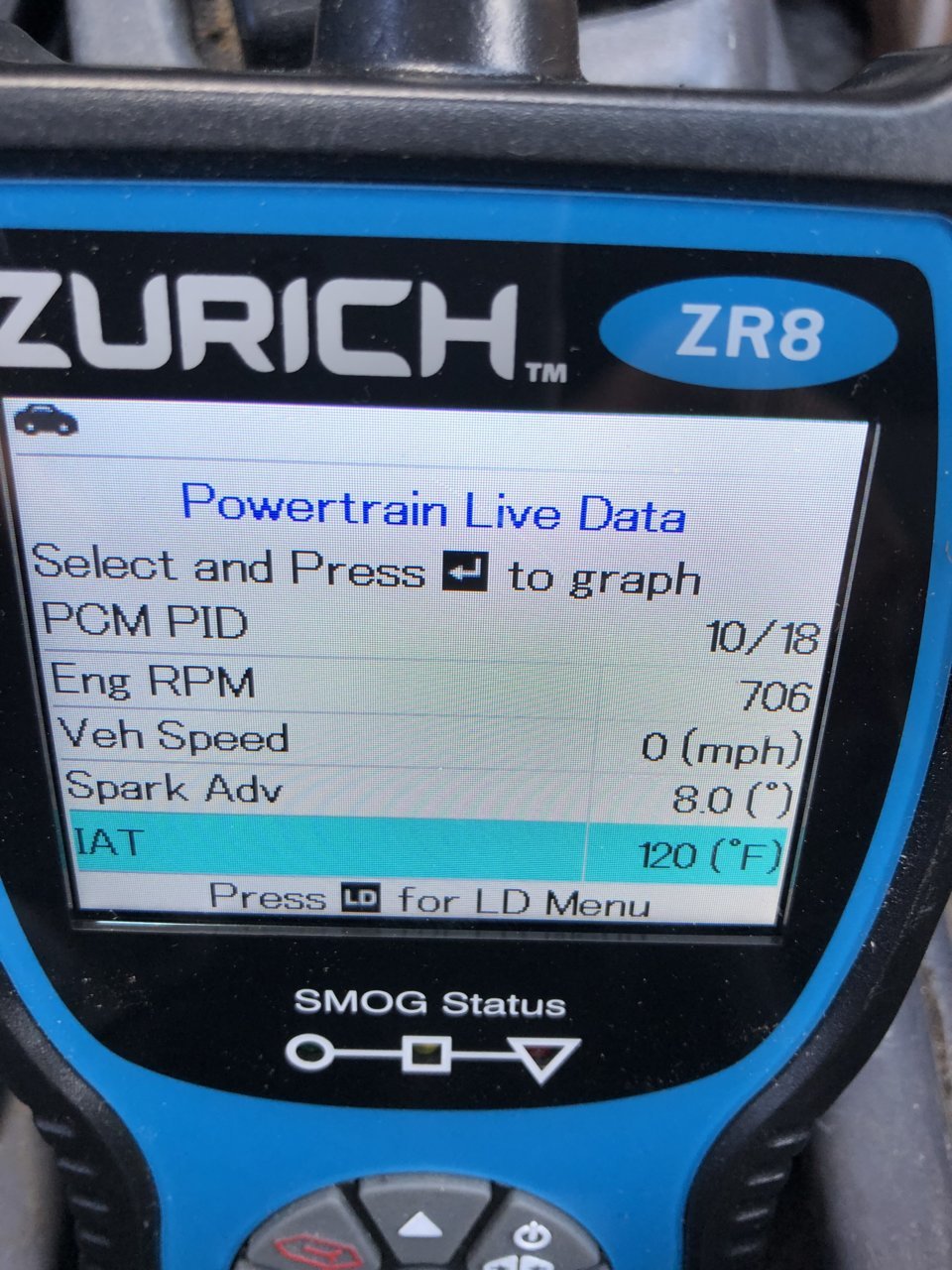

    412DBC0B-B5D3-4141-8F00-9083F87796F5.jpg Soooo, truck running crappy. I assumed it was due to exhaust leak at front pipe in proximity to the upstream 02 sensor. I finally have a nice sealed exhaust and it does run better but not quite right, and I’m anal about it. I notice the smaller things. Lol, anyway I was cruising around in my not quite right truck (stumbles a smidge) with my scanner running to check it out. I looked down and noticed (for the first time) that the IAT was reading 120 degrees. Bouncing around. It’s 70 here. This leads me to believe the MAF is screwed up. It dropped to 88 at one point. If you were me, and ain’t got money falling out of ass, would you replace it? How important is the temp in relation to fuel mixes? Could this be my angst?The trims are around 0 and 3-5 and seem pretty stable. Thank you.

    Hmm I don't have any advice other than to say 120˚ IAT when it's only 70˚ outside does sound way too high. I get IATs in the 120s sometimes in the summer when it's triple digits out, but never when its in the 70s.
    Have you tried cleaning the MAF using MAF cleaner? Easy to do and cheap. No check engine light codes?

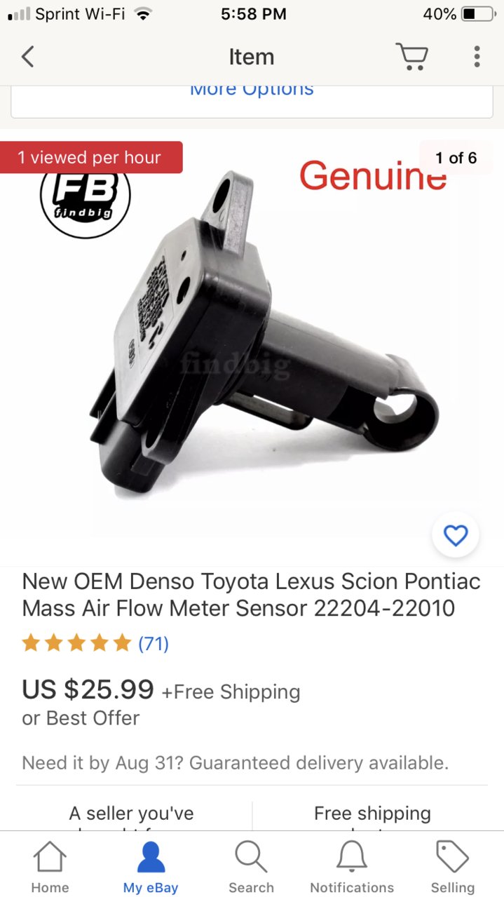

    7E1799C4-1C31-4473-B803-4FFD689909B4.jpg I did clean it, and no codes. I just ordered a OEM Denso for 27 bucks on EBay. I remember buying the one that’s in there from AutoZone for well over a hundred bucks a year or so ago. The Denso looks remarkably different than the Autozone one. The one that’s in there is square and the filaments are kinda hidden and hard to get to. The Denso is way different. Hopefully this is what is supposed to be in there.

    Yeah you only want to use Denso sensors on these trucks, Toyota builds them around the exact specs and parameters of Denso sensors so aftermarket ones can be very hit or miss (usually miss).
    The only thing I find concerning about that purchase is how cheap it is...eBay is notorious for selling 'fake' Chinese sensors that are made to look like OEM ones but really aren't. If you have any trouble after you install that thing I would be sure to take it out. Save the old one just in case.

    True, I thought the same so I bought the most expensive one. Every Denso on EBay regardless of seller is right around the same price. The Denso number is the same for nearly every Toyota in that yr range.

    Only one way to find out lol, at least MAF sensors are easy to swap out so if it turns out to be no good you can just put the old one back in until you are able to source another.

    Not just high, nearly 50 degrees, occasionally anyway. I’m curious what the computer does with the temp information... thanks again

    I aint wicked smaht or nothin, but before you go throwing money at it that you might not need to.. read the IAT after you've been driving at speed for like 5-10 minutes.
    Occasionally Ill monitor the IAT on my 2nd gen via a ScanGauge and there is a huge spike when the truck is standing still (heat soak from the engine bay)
    I can see you're not moving when you took that screen shot in your first post, so you might want to confirm that the 120 reading inst artificially high due to limited air flow through the engine bay before buying new parts :thumbsup:
