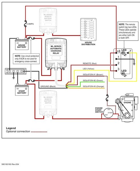

    Good points on the lack of waterproofing of the NL and IBS systems. I might be missing something on the price comparison though. On the Bluesea wiring diagram it shows the ML-ACR wired with 2 x ML-RBS modules which puts the (Amazon) price over $600 without in cab monitor. Retail on the NL kit is $312 at several stores. IBS without RBM retails for $380. Bluesea is great equipment but are you saying ML-RBS is not required?

    Which diagram are you looking at? The diagram I see for the ML-ACR is this one. Shouldn't need an ML-RBS since those are for single battery installs.

    True that the IBS goes to 12.8V. I missed that looking at the picture the first time. But you can wire up the ML-ACR to stay disconnected for 3 or 5 minutes. There are 3 wires on the unit for that feature but most don't use it because it's unnecessary for our applications. My understanding is the feature is there because in some boat applications people have to crank for longer than the default 30 seconds before it starts up so it's there to keep the batteries isolated for a longer period of time.

    Ok I see where that diagram was. This is the one from the installation instructions:image.jpg

    The blue sea unit allows for self jumping, hence the manual over ride feature to force them to parallel. The unit also isolates the main battery from the aux battery when the engine is shut off and the aux battery runs low as to prevent the engine battery from being pulled on.
    Further, the schematic pcbuilder posted up top is from the blue sea site and is the one we use on our rigs and does not require an ML RBS inline. Thus, keeping the coat to mere couple hundred bucks plus a 20-30 dollar add on monitoring doohickey for your cab.
