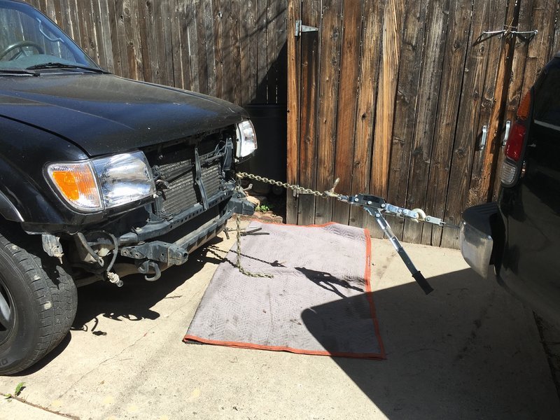

    Got most of my front end shipped in. A few various clips we had to wait for from Toyota (I'm glad they are only a couple blocks away lol).
    Opened up our own body shop business to attempt to pull out and straighten some of the radiator support.
    After playing with it for 30 minutes it was still kind of ugly. Then I discovered rock auto sells new ones for $50 so ordered that and it should be in Friday. So now I have to take everything off the front again. Lol

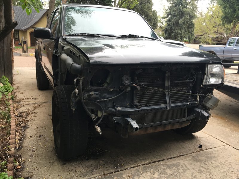

    Here is its current state since @AR15xAR10 was curious lol
    Poor thing. Was slowly removing stuff to prepare for replacing the radiator support.
    AR15xAR10 likes this.

    You doing a front end swap or something?

    ADS Racing Shocks 2.5" Extended Travel Coilovers with Reservoirs, 3 inch All Pro rear suspension kit, factory E-locker, Trail Gear sliders and front stinger bumper, CBI Offroad rear tube bumper, XRC8 Winch, 33 inch BFG KM2's, 16 inch Ivan Stewart Wheels, Uniden CB radio, flip up license plate, white tail lights, LED front signals, Tundra front brake upgrade, new radio, rock lights, sub woofer, remote start, satoshi grille with Prius emblem, Rigid DOT/SAE Fog Lights, 12" Light Bar
    Nah, same front end. Previous owner scraped into a wall turning into the driveway and bent things up pretty good. You can see how that center support is bent in that last pic. It's not horrible but enough to bug me. Hard to tell initially because he duct taped, zip ties, and epoxied everything back together. We tried pulling the metal back out (see post with chain lol) but it's still ugly. Fiberglass is hard enough to fit when everything's straight, let alone bent lol. So found a new support on rock auto and just going to put that in.
