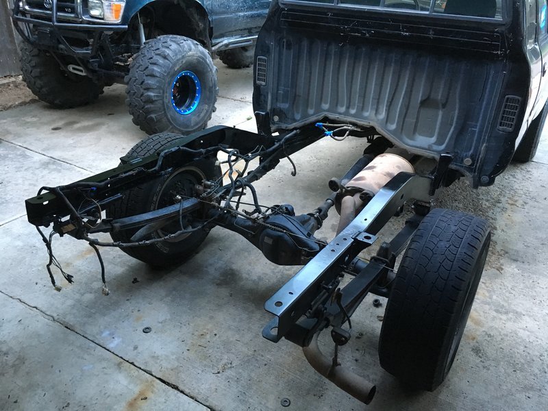

    Shock mounts gone, rust gone, and painted.

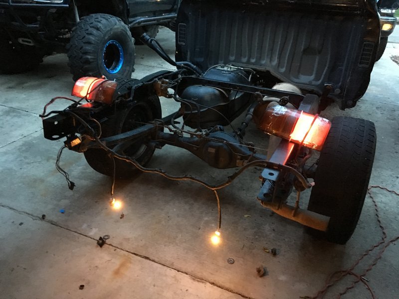

    I'm sure you're going to be building a new rear crossmember(s). But as it sits right now without the old crossmember, I guarantee you the rear of the frame has shifted.
    Pro tip...put the old crossmember back in to line everything back up. Then weld a temporary piece of square tube/rectangle tube/angle iron off the backside of the frame to keep it from shifting so you can remove the shit x-member and make your own.

    We're putting the old one back in the front. We just had to pull it to get some rust spots out. For the moment at least lol
