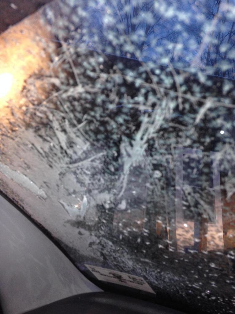

    Is this normal to have ice on the inside of my windshield. It was -9 this morning but to me that indicates I have a seal problem. Just curious
    13' DCSB TRD Offroad
    Thanks
    drivers side

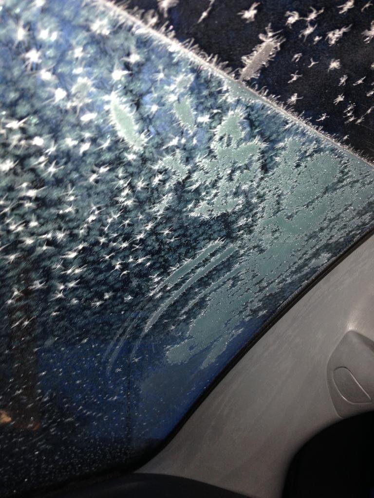

    pass side

    Did you leave something liquid in your truck ? Maybe a drink or something? Doubtful but could have evaporated to the Windshield

    Check your windows and seals around your truck and seriously did you have a drink in your truck that evaporated onto the windshield?

    no drinks but with snowy boots yesterday. Maybe the snow melt from the floor mats. I didn't think about that.

    I have had this happen occasionally living in Vermont in my vehicles.
    It has happened this winter on my 2013.
    If your mats are wet/snowy, dew point, just had the truck in a warm garage or serviced, the weather just right...
    than it is ridiculously stupid cold afterwards. It is crazy.
    My truck has iced up on the inside windows after being warmed up while I was driving...
    :eek:
    Weird winter this year for sure.
    not to worry is my vote

    Anything that brings humidity into the interior will cause condensation on the cold windshield and icing when it freezes.

    It's the humidity. When I lived in MN I got it frequently. What I do is lower the windows for a bit to exchange the moist air with the dry outside air (assuming the outside humidity has dropped with the cold weather). If it's wet floor mats bring them inside to dry. Or once the ice melts I'll just take a towel to the windows if it's bad enough.
