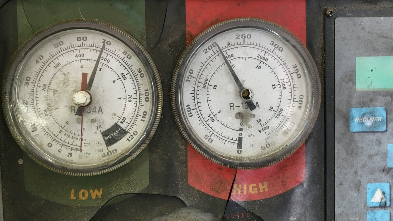

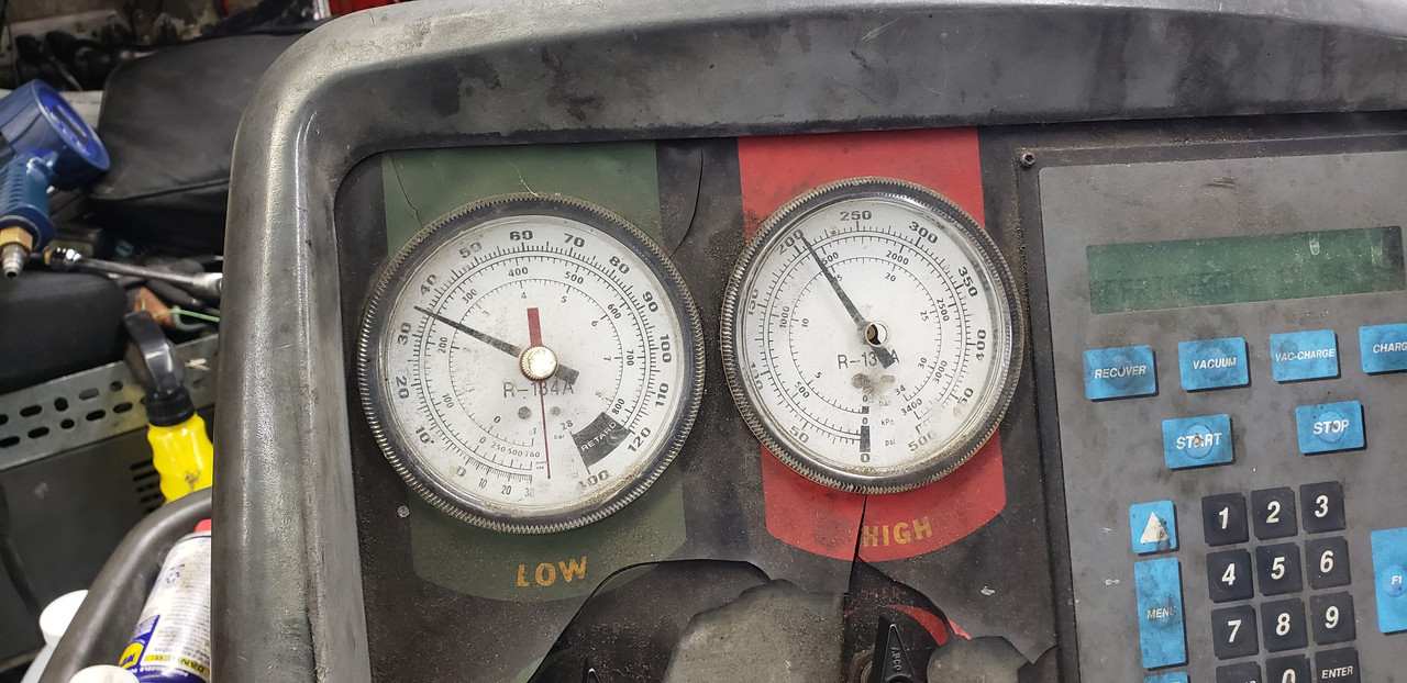

    Anyhoo, a couple weeks ago I put my daily beater (2016 Sienna Limited ATP) on a set of gauges cause the A/C wasn't blowing nearly as cold as it used to.
    It read way too high on the low side
    Since she had 311,xxx miles and the A/C had never been touched, I decided to do a service and recovered 1.68lbs. of refrigerant (still within spec) and pulled 3oz of oil
    After a good vacuum and leak check, I added 1.5oz of PAG oil, 1.5oz of the Ice32 additive and recharged with 1.91lbs. of refrigerant (max spec)
    The results were the same, which indicates a compressor issue.

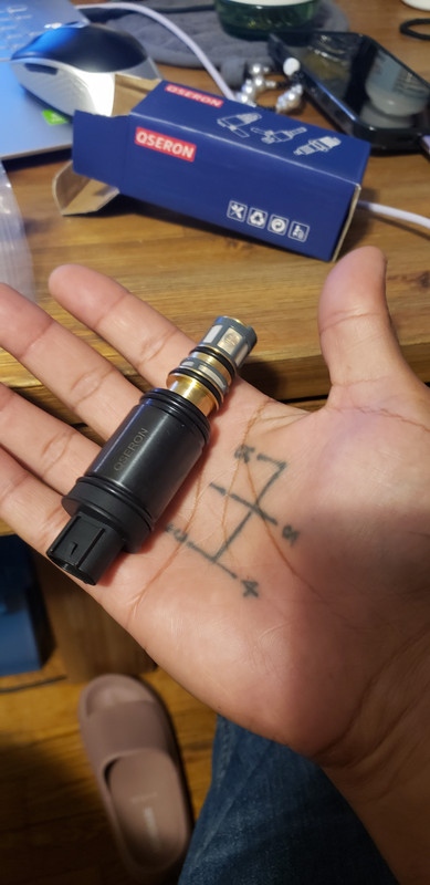

    Since these compressors rarely ever fail completely, I decided to throw a control valve in it.
    Not available separately from Toyota and I wasn't able to source a Denso unit, so I just ordered the cheapest one I could find on Amazon ($24 bucks)
    Honestly couldn't tell the difference between the new one and the original
    Now the pressures are back to normal and she's blowing ice cold again
