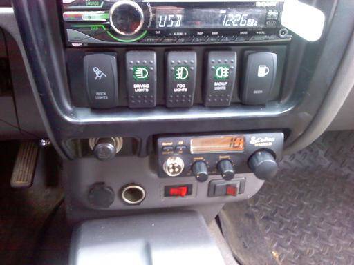

    Hey Brent. Yes, Meatman and I made the switch panels in our trucks. I was made out of fiber board, and it was cut to fit in inside of the radio trim piece. The switches are from OTRATTW.com and the fit perfect in the pocket area. I did cut the back of the pocket and notched the bottom for the wires.

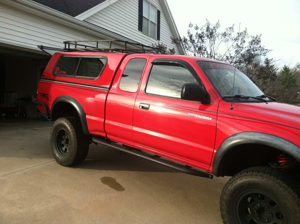

    Finished up what little bit of work I needed to the shell and pick it back on.

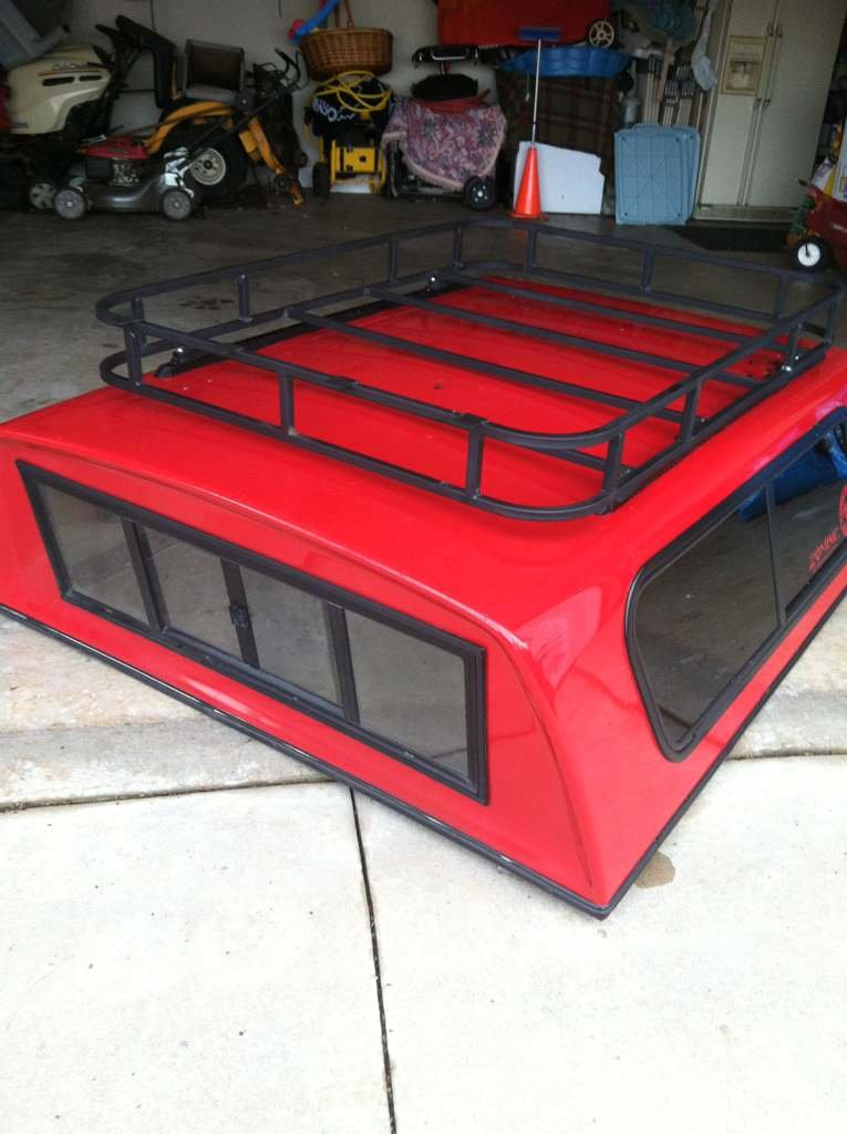

    So what tracks and towers are you running on the shell that are holding the basket? If you have any part numbers that would be greatly appreciated!!

    The track are from prolineracks.com! They're a univ 50" tracks. I'm not running tower bc we made custom low profile lower that welded onto the bottom of the basket. I really wanted a low profile basket, I hated that the others I could buy were 6-7 1/2" tall. Mine is just over 5 1/2.

    Sweet that panel looks great, and makes it to i dont have to cut the shit outta the dash! Just one more question i saw that its screwed in but what did you screw it too? through the cubby bottom?

    It doesn't bolt up to anything. It's wedge between the pocket and radio dash trim. The panel was cut to fit the shape of the backside of the trim. It's very tight and looks better than having to bolts sticking out.

    That rack looks nice man! When you gettin the new tires mounted up?

    Thanks man. Next Friday I hope if all go as planned!!!

    If I were you I'd cut the rack down even more. I think you could get that thing to 3" tall and it would look better and fit in your garage. I really don't think you need that deep of a basket to keep things contained. as you know my roofrack and bedracks are all flat with no lips and work just fine.
    Totally up to you, I'm just a guy that thinks the lower profile the better.

    I might just have to do that Adam. 3 1/2 inches would've been perfect. But I'll run this one this year and see how it goes. Thanks for the ideal man, now you've got me rethinking it!!!

    NP. Would be easy to just cut the vertical peices down a little and reweld the top hoop.

    That's what I was thinking man.

    Awesome thanks for the pics and explanation meatman!

    It was truly very easy to do. Plus I think it's looks clean.
