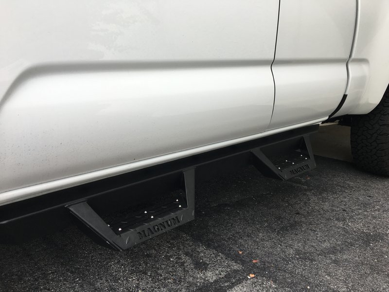

    Any issues with the hardware, mainly the bolts snapping. Seems to have been a concern with some users here. I purchased the Westin HDX which look very similar. Haven't installed or taken pics yet.
    https://www.youtube.com/watch?v=40Y479OJ7NA
  3. May 24, 2017 at 3:32 PM
    MaidenTheTrooper
    MaidenTheTrooper [OP] Well-Known Member
    Apr 27, 2017
    #217503
    398
    2017 Tacoma SR5 2.7
    So far wheels & tires
    None. 30 minutes job by myself.

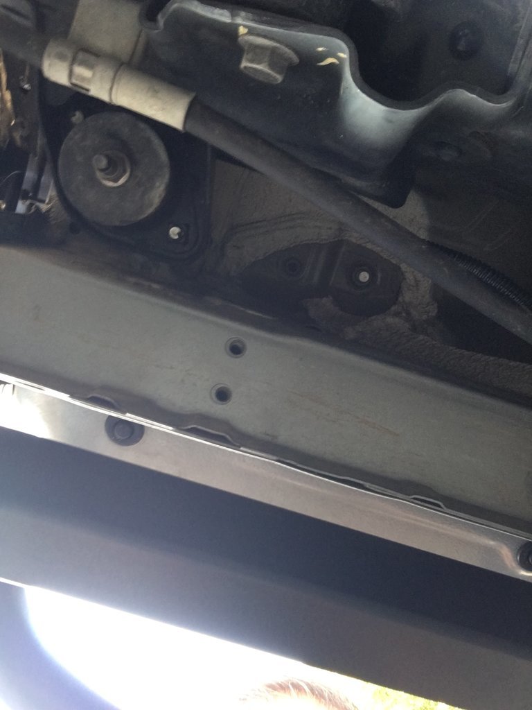

    I just received the ICI step and I was looking on my chassis and I don't see the threaded nuts we are supposed to use. Did you come across the same thing, did you use the existing holes and use the nuts provided with the steps?? The instructions mentioned to use the threaded holes, but looking thoroughly I didn't find any threaded nuts anywhere.
  5. Aug 13, 2017 at 5:41 AM
    dskakie
    dskakie Well-Known Member
    Jul 19, 2016
    #192352
    969
    Dan
    Northern CA
    2016 TRD OR DCSB
    When I installed mine ('16 DCSB) I had to remove some rubber plugs to uncover the threaded holes for the bolts. If you put the steps under your truck and look up from the steps mounting brackets they'll probably be more obvious.
    Got mine for sale BTW if anyone reading is interested :hattip:
  6. Aug 13, 2017 at 6:02 AM
    guahan671
    guahan671 Member
    Aug 13, 2017
    #226694
    24
    2017 TACOMA DC LONG BED, METALLIC GREY, 18X10 MOTO METAL 962 SATIN W/33'S.
    3"LEVELING KIT,TRD PRO GRILL
    Okay, sounds logical. Ill have to look a little closer. I saw the rubber plugs, well it looked like it. Through the center of the chassis I didn't see any threaded holes. I hope with the 2017 tacoma's its different from the 2016's.

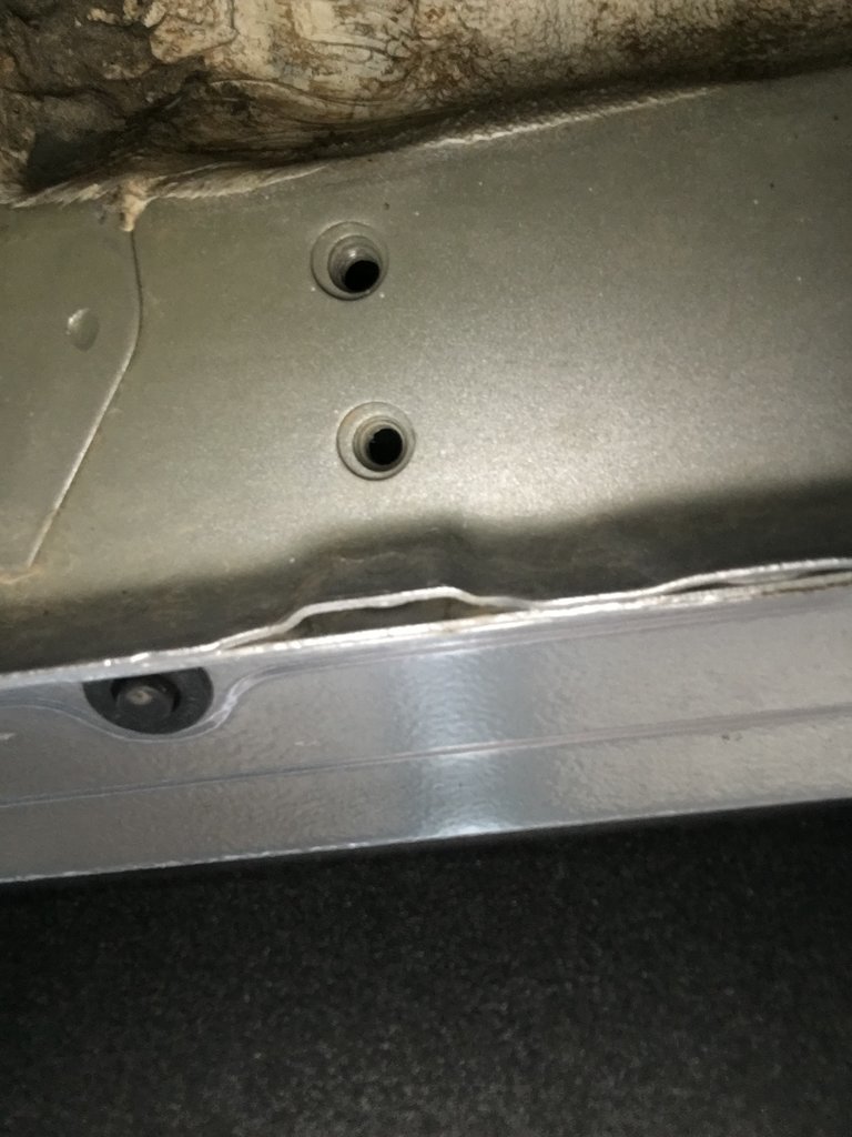

    Alright I got 2 out of the 3 mounting spots, the first was too hard to get a decent pic of. These are both taken from driver side facing up, the bottom of the pics is towards the exterior of the truck (you can see in pic 2 the top of my head-was using the rear facing camera to take the pic upwards). If you get under there on your back and look up it should be real clear if it's like mine was
    First pic is mounting spot #2/3, around where the drivers side doors meet up
    Second pic is maybe 12-16" up from the rear wheel well

    Okay now it makes more sense. The pictures really explained more of where to look for the threaded holes. I was looking at it from the side. when I get home from work Ill look upwards. LOL Thanks Dan.
