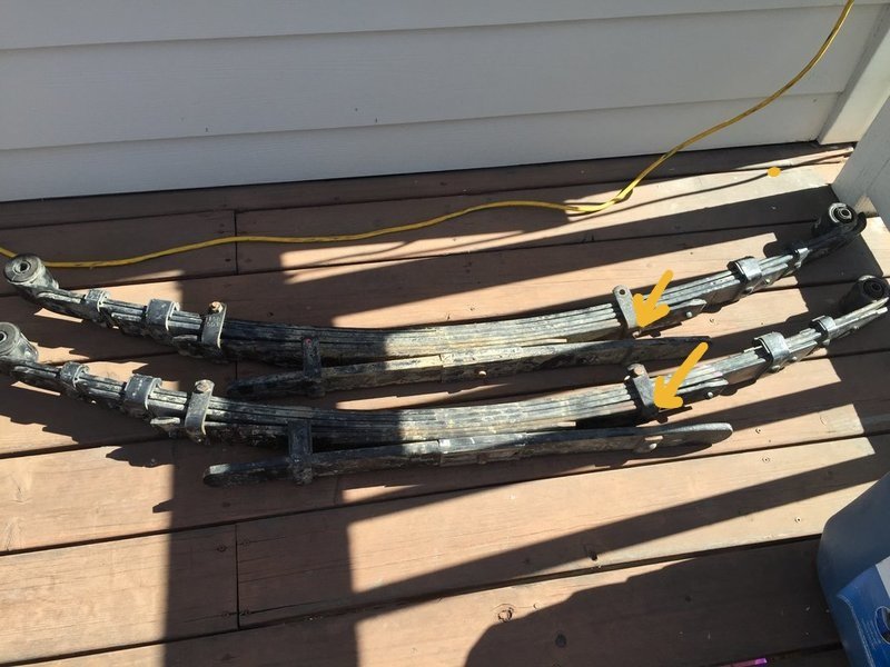

    Yeah, this was kind of a do-over for me. Started with the OR 2-leaf pack with just the AAL. Sagged and broke a pack clamp in a year. Icon replaced the one AAL under warranty. Bought a factory 3-leaf pack from a local member, put the new AAL on the drivers side, transferred the old AAL to the new-to-me pack, added the overloads, good to go.
    If you use the overloads, be prepared to cut the forward clamps off them at installation.
    The only thing left from the original install is the shocks. :)
    Here is an assembled picture showing the cut overload clamps.
