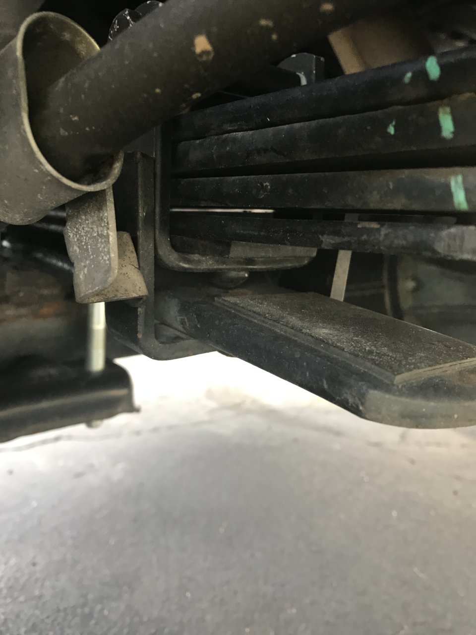

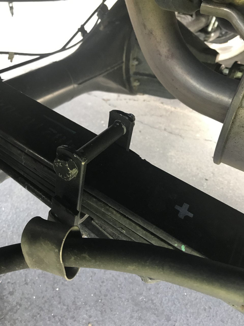

    Does anyone have 3rd Gen pictures of their installed progressive 3 leaf pack showing how their front overload alignment clamps line up with the leaf pack?
    I am about to install the Wheelers 3 leaf pack and I want to keep overload in.

    Here you go this is Icon 3 AAL 8CA6BDE1-B5DF-4299-BB1D-4C05C1737E36.jpg19DFB879-D570-4E17-B2EA-B7614C4D8329.jpg

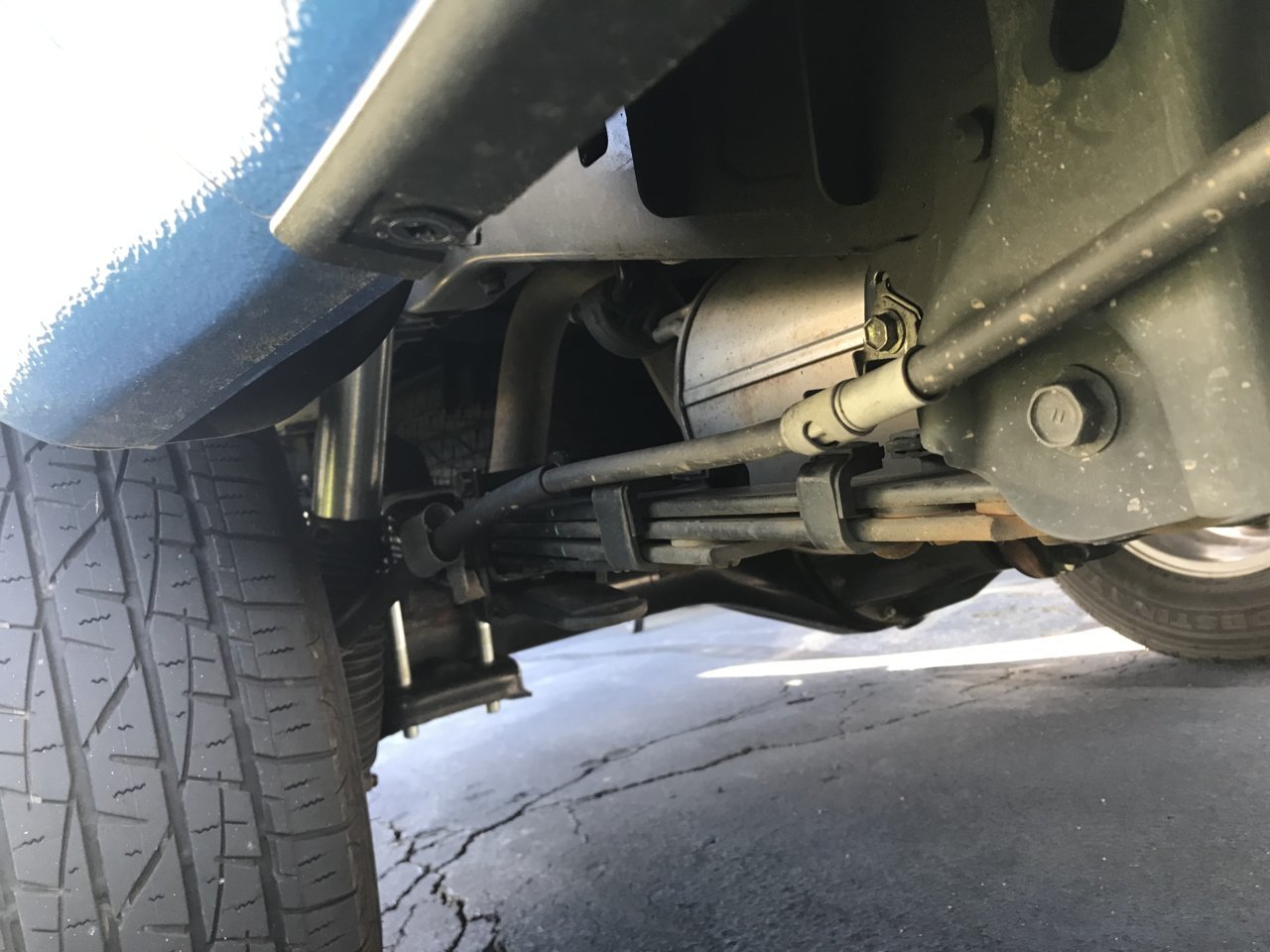

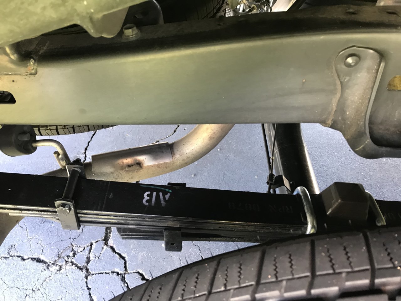

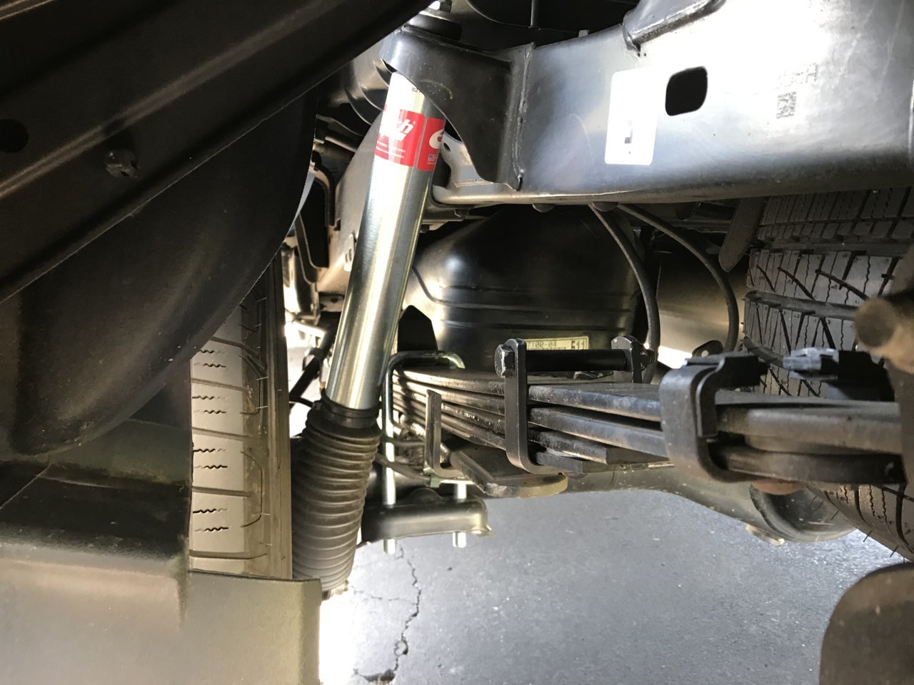

    Hi there, wondering if you could take a pic of most of the spring to show its new arch? I just installed and only got about an inch of lift. Looking like I'll have to go back in and put the overload just to stop a Bro lean

    This is the best I can get. I wound up with just under 2” of lift 741F6C69-B601-43C2-8622-54A3ADFA54A7.jpg58CEA9E5-3298-4D04-B848-7914FD8B3A02.jpg 991E5F35-300D-4DF7-97A4-4237C2BE909A.jpg

    Thank you so much ! I really appreciate the images. They were exactly what I was hoping for. I am going to put in the overload and a toytec shim . All together I should then be closer to 2 inches and get away from a bro lean that has developed :annoyed:
