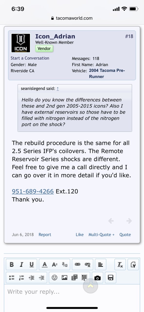

    I cant remember the depth off the top of my head...you can hit @Icon_Adrian up tomorrow 91C40BE9-59A3-47E5-9F5A-A84A4145A14E.jpg
