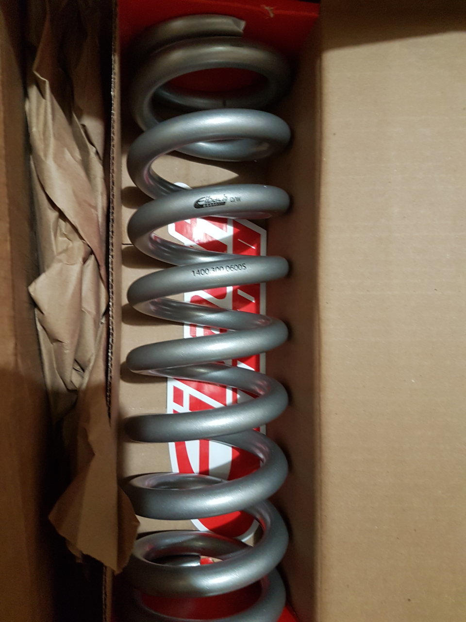

    Hate to resurrect an old thread, but I have some updated information. I've been living with my 14" long, 700 lb/in King coil springs in the front for several years. The suspension in the front always seemed a bit stiff, even with my steel bumper, winch, and steel skid plates. But I was never sure if it was my coil spring rate or my ride height, which limits down travel to some degree. In other words, ride height, down travel, and preload adjustment are all the same thing with these adjustable coilovers. More preload = higher ride height / lift = less down travel.
    In other words, if we increase the preload adjustment to increase ride height, we decrease down travel by the same amount. If we have a sufficiently low amount of down travel, the ride will feel too firm / sucky / horrible, regardless of spring rate. However, if the spring rate is too high, the ride will also feel too firm / sucky / horrible, regardless of ride height / preload / amount of down travel. So, how do we figure out which it is? How do we pick the ideal spring rate for a given ride height?
    I stumbled upon this video: https://www.youtube.com/watch?v=udgrGGKQcoM
    This video states that the optimal coil spring should be compressed 25% - 30% of its free length at ride height. 25% is on the firm side, and 30% is on the softer side. Anything less than 25% will likely be too firm of a spring, and anything more than 30% may be too soft of a spring.
    So, I measured how compressed my coilsprings were @ ride height. Driver's side measured: 10.4" compressed, and Pass side: 10.75" compressed (both are 14" long uncompressed). So the driver's side is compressed 25.7% of its free length, and the passenger side is compressed 23% of its free length. Both on the firm side.
    So, how would 600 lb/in springs look like? Doing the math: Driver's side: 700 lb/in * 3.6" compression = 2520 lb force. Pass side: 700 lb/in * 3.25" = 2275 lb force. Switching to 600 lb/in springs would = Driver's side: 2520 lb / 600 lb/in = 4.2" compression @ same ride height. Pass side: 2275 lb / 600 lb/in = 3.79 in compression. For a 14" spring, this translates to Driver's side: 30% compression; Pass side: 27% compression.
    So, I left the world of theory, and entered the world of reality, and bought some 14" long, 600 lb/in coil springs. During installation, I adjusted the collar on the coilovers to give me the same ride height (0.6" more on driver's side, 0.54" more on pass side).
    Result: Ride is softer @ same ride height. And, for me, this softer ride is preferable. So, if you want to know the ideal spring rate for you, pick the ride height you want by adjusting your collar, with all the stuff installed you want (bumper, winch, plates, etc). Then, measure your compressed spring lengths. Remember, the ICON spring is 13" long (free length), 650 lb/in, unless you ordered differently. Then, calculate your percent compression. < 25% may be too firm; > 30% may be too soft.
