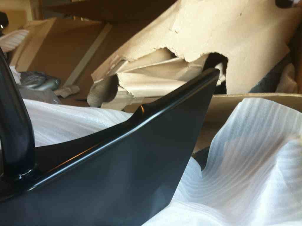

    So the development is that my bumper got here and was bent; so i have to send it back and get a new one...[​IMG]
    I did however get my springs today so I will install them tomorrow and see what happens with the stock bumper...

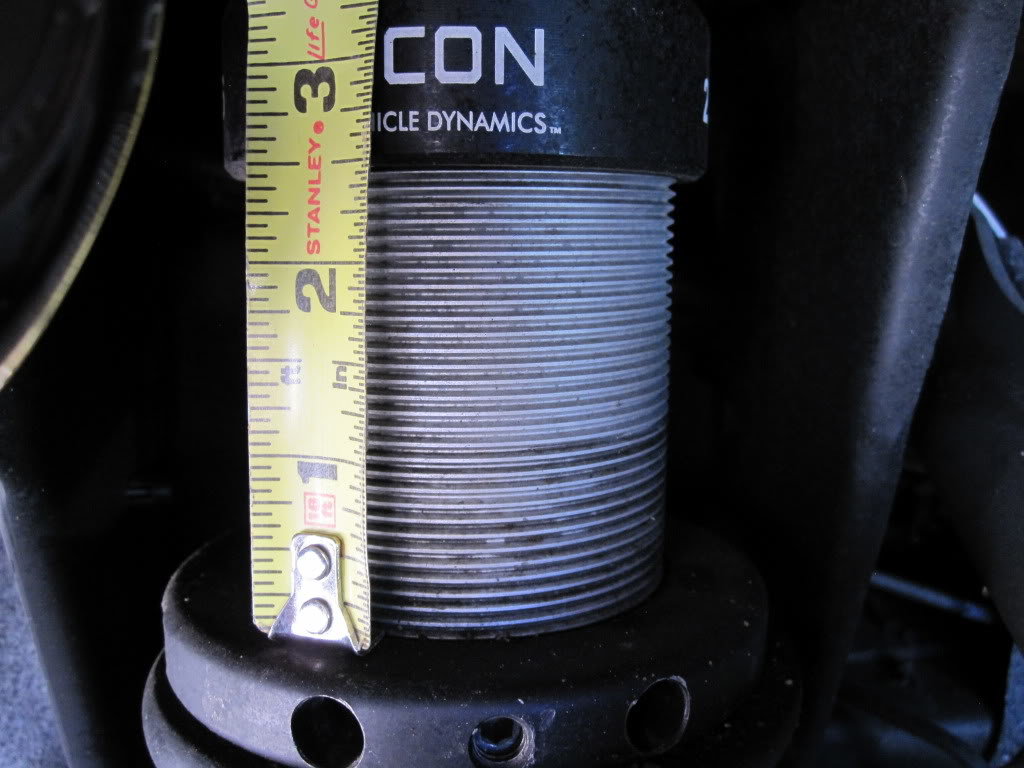

    I got everything installed today and to tell you the truth, the ride is the same without the bumper on. It may be a TAD stiffer, but WOW do I have a lot more preload to go! Check it out...by the way, I love the blue...

    For comparison purposes, here is the preload on my Tacoma. Granted, I have a Warn 8000 winch and All Pro steel front bumper adding weight. I have about 2 inches of preload left I could use.
