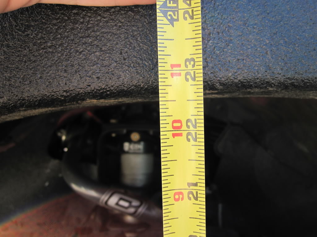

    With this preload, here is my lift measured from center of wheel to fender edge:

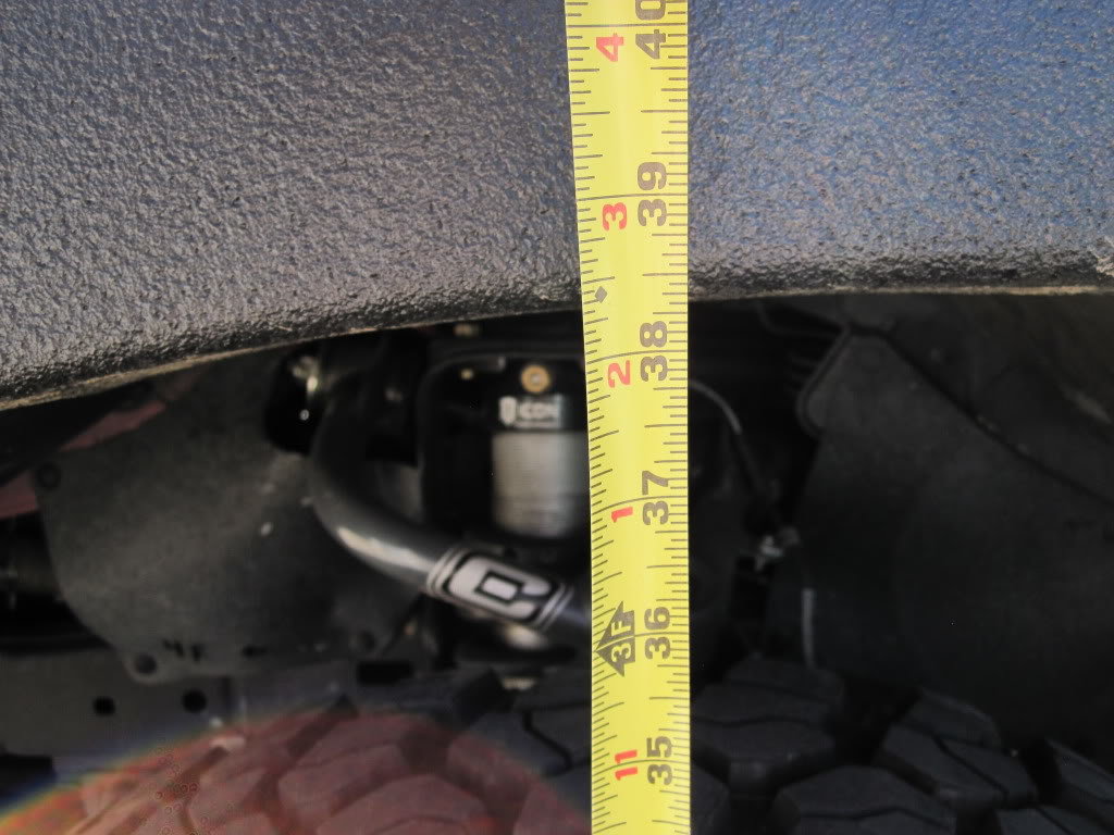

    Same lift measured from ground to fender edge, with approx, 33" tires:

    That is about where I was with a stock bumper in the front :eek: I think I will have maybe an inch and a half of preload when the bumper and winch are installed...

    So I got the bumper and winch installed today. I had to crank on the coilovers a little, but they sill have aBout less than 2" of threads showing. I drove 75 miles today, and I have to say, it is a tad bit stiffer than with the 650lb springs, but still way better than with my 5100s set at 2.5"...I will post some pictures of the threads tomorrow :D
