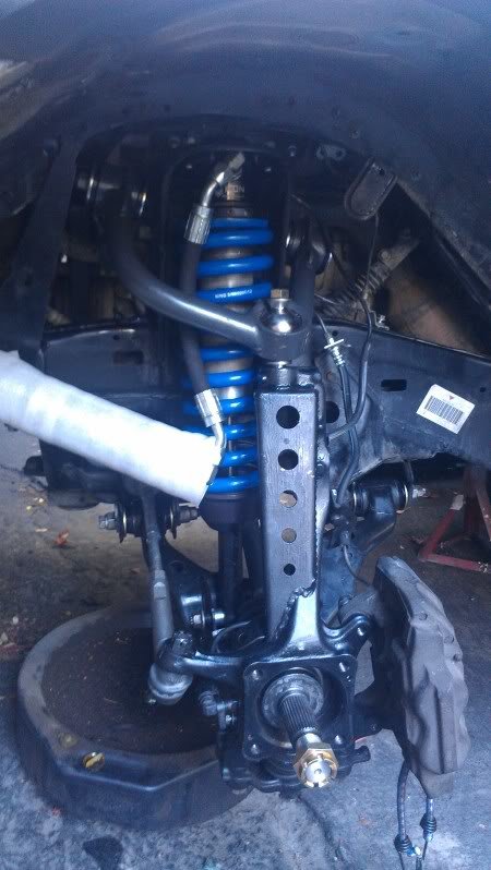

    Changed out my 13" Icon 650 lb/in coilsprings with King 14" 700 lb/in coilsprings. I also painted the blue King springs red, and I got the Icon CDC upgrade.
    I can tell you that with the CDC setting on a softer (lower) number, the truck rides nicer/smoother less stiff even with more lift and with the higher rated coilsprings.
