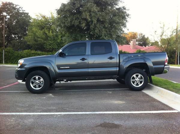

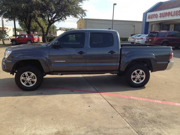

    Ordered the ICON 3 Leaf Progressive AAL yesterday from DSM. Should be here this Friday or on Monday. I'll get it installed ASAP. Currently I am running 5100s at 1.75 in the front with stock coils. I am hoping my rig will be sitting level post-install...you can see for yourself the bro lean I got going right now...
    If all goes well, next up will be some some 265s...although I may ride these factorys out until they are bald. No use in spending the money on a new set of tires if you dont NEED them....comments/thoughts are appreciated.

    That looks like you gained a lot more than 1.75" up front. Could just be the angle of the picture or the camera but that really jacked the nose up quite a bit. Are you sure you used the 1.75 setting and not the 2.5 (or that the coil seat is right-side-up?
    You're going to love the Icon AAL. I've had mine in for over a year and it's holding up great and still rides like it did on day 1.

    Yea bro I made sure if was at 1.75 prior to install..It's probably the angle of the photo although I did get some significant lift in the front...thanks for posting both pics like that.

    Cool, just making sure. It certainly wouldn't be the first time it happened on TW! Are you leaving the overload in place with the AAL or no?
