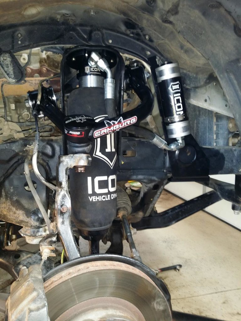

    Jlottes762
    Jlottes762 Active Member
    Apr 1, 2012
    #76076
    29
    Jordan
    Livingston MT
    06' White Tacoma
    ANZO LED taillights (clear) All Pro Bolt-on Sliders Powdercoated 30 inch Double Row LED lightbar Icon 2.0 VS series rear shocks
    I ended up going with a similar setup on my 06' double cab. Went Icon ext. travel w/ reservoirs and 2.0 Icon ext. travel with reservoirs in the rear.
    So far so good on my Camburg UCA's....they have been money well spent. Have put approx. 200 miles on them since install. No issues whatsoever.
    I didn't want to deal with keeping UNI-ball cleaned up all the time....especially on the roads I drive sometimes.
    Still waiting on Icon extended travel....Wheelers custom orders them for guys running 3" leaf packs such as All Pro, Deaver, etc...
