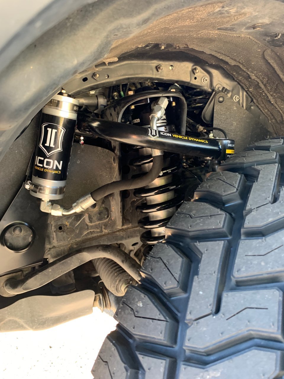

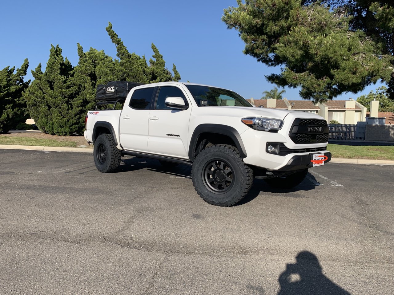

    So...I've been reading a few threads on this topic but can't seem to find the right answer. I'm in a little predicament now and I'm hoping someone can lend me some advice.
    I recently just upgraded my truck to a stage 5 Icon kit. When I first placed the order, it was for just the standard kit with 650lbs springs. After researching online and reading some threads about the possibility of needing the added spring rate if adding winch, bumper, etc., I decided to call the shop and see if they could upgrade them to 700lbs in anticipation for the bumper and winch that would be coming down the road.
    I then was at a tacoma meet-up where I was talking with several people, whom were running 650lbs with steel bumper/winch and said they are happy they didn't upgrade to 700lbs. So, me being as indecisive as I am called the shop back and had the order reversed to original.
    Well... I ended up with 700lbs due to the guy handling my order being let go because of customer service problems (long story). He told me that he called Icon and had them switched but never actually did. The shop ended up giving me 700's at no up-charge and said to drive on them for a while and if I didn't like them, they'd switch them back to the 650's. I took the truck out this weekend and I will say it does ride a bit harsh, currently.
    If anyone could shed some light on the benefits or negatives of the 700's vs 650's, It wouldbe much appreciated.

    Put on a front semi hidden metal bumper and winch and you’ll be all set.

    side note: with the 650# you have about 1 1/4" of threads showing for preload against your 1/4" you have now

    The 700lb spring is an inch longer allowing you to run less preload than the 650lb.
    I currently have 700lb springs and run a full steel bumper and full skids and I'm glad I upgraded. I can be at the same height as before with less preload and the truck rides fine. New bump stops will also help smooth out the ride as well.

    If you’re going to add any front weight stay with the 700lb springs. I have them with just 130lbs in the front and they ride fantastic after about 1200miles of settling.
    You don’t want to sag over time and a lighter spring may do that. Typically the 3rd gen is a heavier spring due to the front end being several pounds heavier than the 2nd gen
