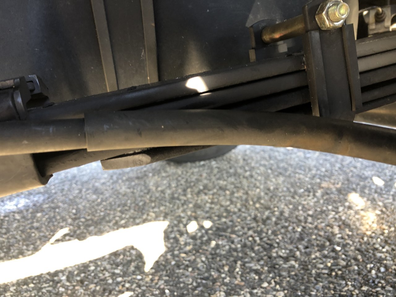

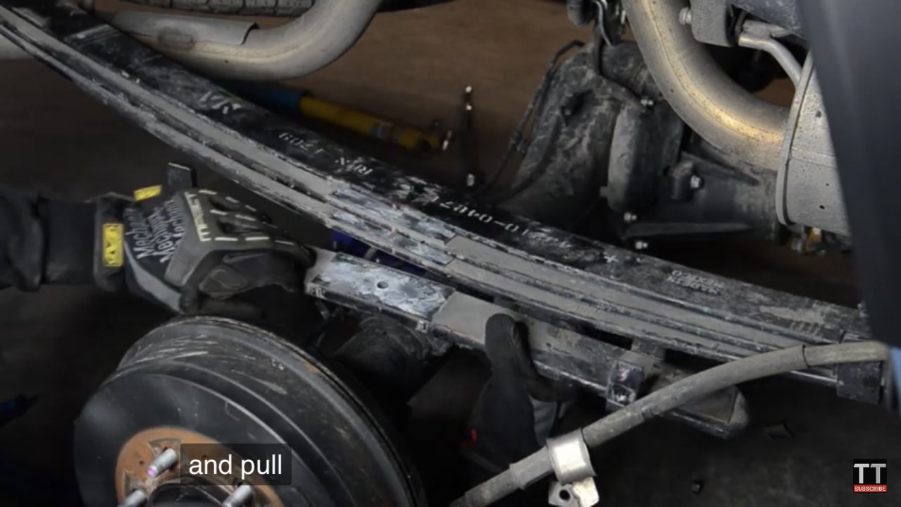

    I’m getting ready to install the icon aal leafs. I’ve watched a few dozen videos and tutorials and read threads on mounting the Icon add a leaf kit. The one major thing that it seems Icon and the tutorials leave out is the brake line relocation. They always show the unmounting of the brake line attached to the prior set up. Do the brake lines simply go back to their original position? Asking for a friend. Thnx

    I just installed the Icon AAL. I just cut the bracket off and left it. The brake line doesn’t have much play in it and is snug to the leaf pack. I am not word about it at all. And I’m OCD with everything I do. Make sure you retorque the U-bolts after the 100 miles recommendation. They definitely stretched in my case.

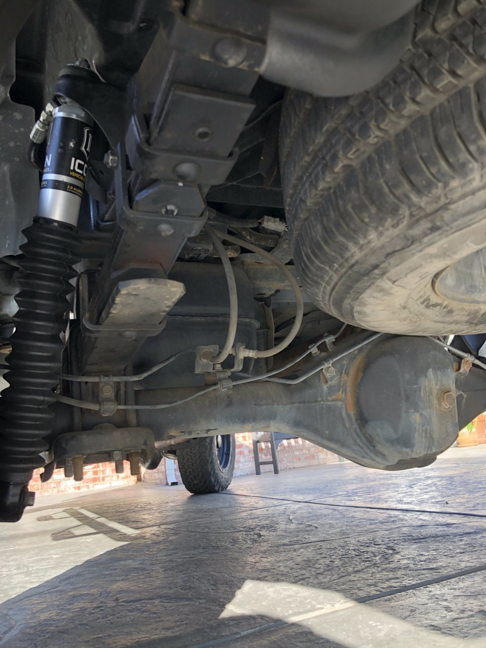

    Yes, the brake like goes back into its original position.
    this is mine with the ICON 3 leaf progressive AAL

    So yes when you unbolt them from the metal bracket to drop the axle to full droop, you then bolt them back to the same spot after. You shouldn’t need an extended brake line (unless you have a block as well). I have just the pack and I have a lot of room in the lines

    Let me clarify my question more.... I am installing the Icon 1.5” lift add a leaf spring set. This set replaces the stock overload spring. The brake line bracket hole is in the overload spring mount clip. This clip is no longer used. Thus, the brake line no longer has a mount. Looks like @Jacoma77 says that brake line bracket is no longer needed......

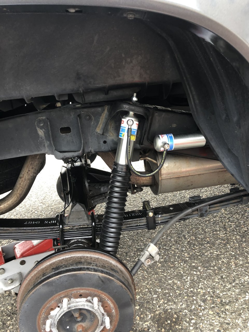

    Just did this on my truck a few weeks ago. A friend brought his 2019 over and we did both trucks. The bracket for the E-Brake line needed to be slightly bent to change the angle and then fit right in. We both got about 1.5" of lift once it all settled. FWIW, I added a 2" lift up front and it's level now. However, I have an RTT on the back and Winch/bumper up front to the amount of weight is probably different than yours.
    One important thing to note, the 2020 had no shims under the spring but the 2019 did have shims. Not sure why they were different but they were so if you have shims, be sure to note the position and replace them on the reinstall.
    And one more thing... no need to cut the rear bracket holding the springs together. The Icon works perfectly with it in place. Good luck, maybe a 2 beer job, not that bad.
