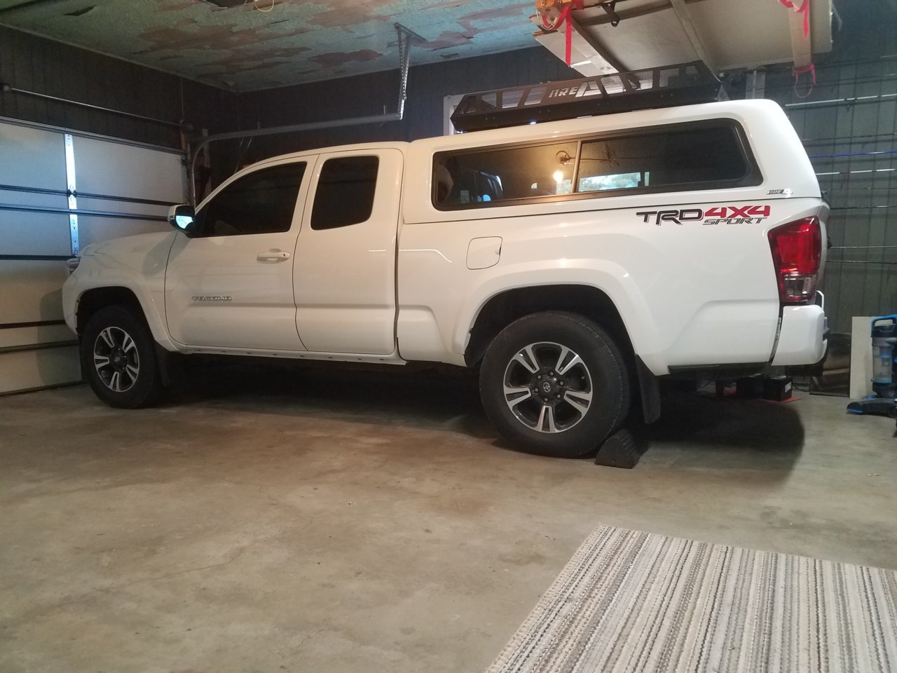

    `17 AC Sport MT
    ARE Topper, Icon aal, OEM Audio+

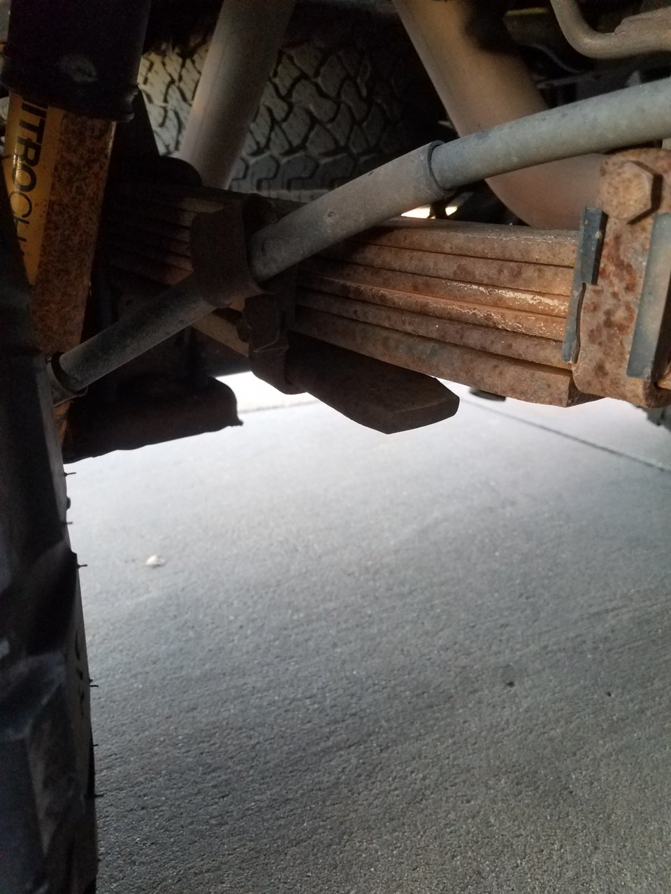

    `17 AC Sport MT
    Another picture of the stock springs...so many options, too many lol. This truck is pretty much a garage queen as some friends tease me. I use it mostly for longer trips and the Mule to haul camping gear when going on Jeep Jamboree with my other toy.20201207_112334.jpg

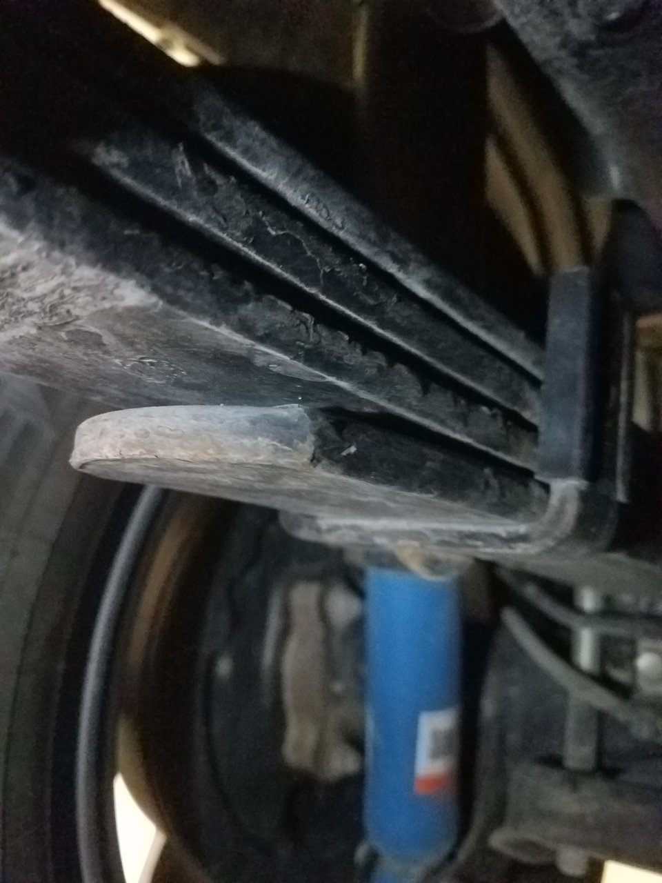

    Denver, CO

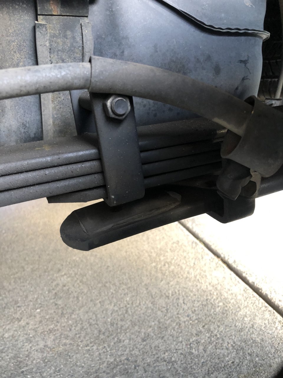

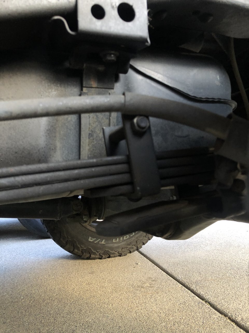

    ‘06 Tacoma 4WD TRD Sport DCSB 4.0L V6
    RR 2.5 King shocks front/rear, Camburg UCA's, Icon AAL Springs Softopper & BA Bumper
    so here’s a photo of mine as it sits (although this is a slight incline). It’s barely off of the overload. Less than an inch of space (this is the front - close towards the cab - the side towards the bumper has more room, maybe double what’s seen here). EACBFF77-F44E-4329-AA1B-3DB1331490F4.jpg
    tacotoe[QUOTED] likes this.
  18. Dec 9, 2020 at 4:18 PM
    #38
    tacotoe
    tacotoe Pastry Chef
    Nov 25, 2007
    #3593
    5,915
    Nebraska
    `17 AC Sport MT
    So it may not hurt to leave the overload in. But how much weight do you guess is added? Over empty I mean. I actually called Icon today and they were very cool/helpful. The person who answered the call put me on hold after asking me about weight I'll have with camper and extras. The returned to say the springs alone would at 2.25" minus 1.75" with total 300lbs my guess with shell and a few things I'd like to keep in there. Does that sound correct though...2.25" when this progressive add a leaf is marketed as 1.5" ??

    How much weight is added on my truck? Or how much weight does it take to cause me to hit the overload? Which are you asking?
    also sorry, it wasn’t clear in your message. The springs alone with no weight sit at 2.25” of lift? But with all your weight (300lbs) go down to 1.75”?
    I mean, if you have absolutely Nothing in your bed and not a terribly sagging leaf peach I can see if it gives you 2” as soon as you slap it on. If they actually did a calculation that’s what it is. Idk
