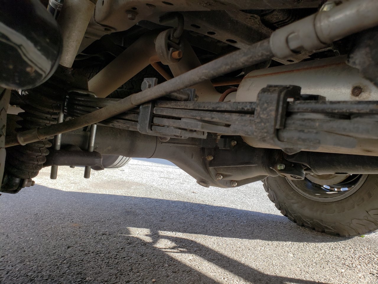

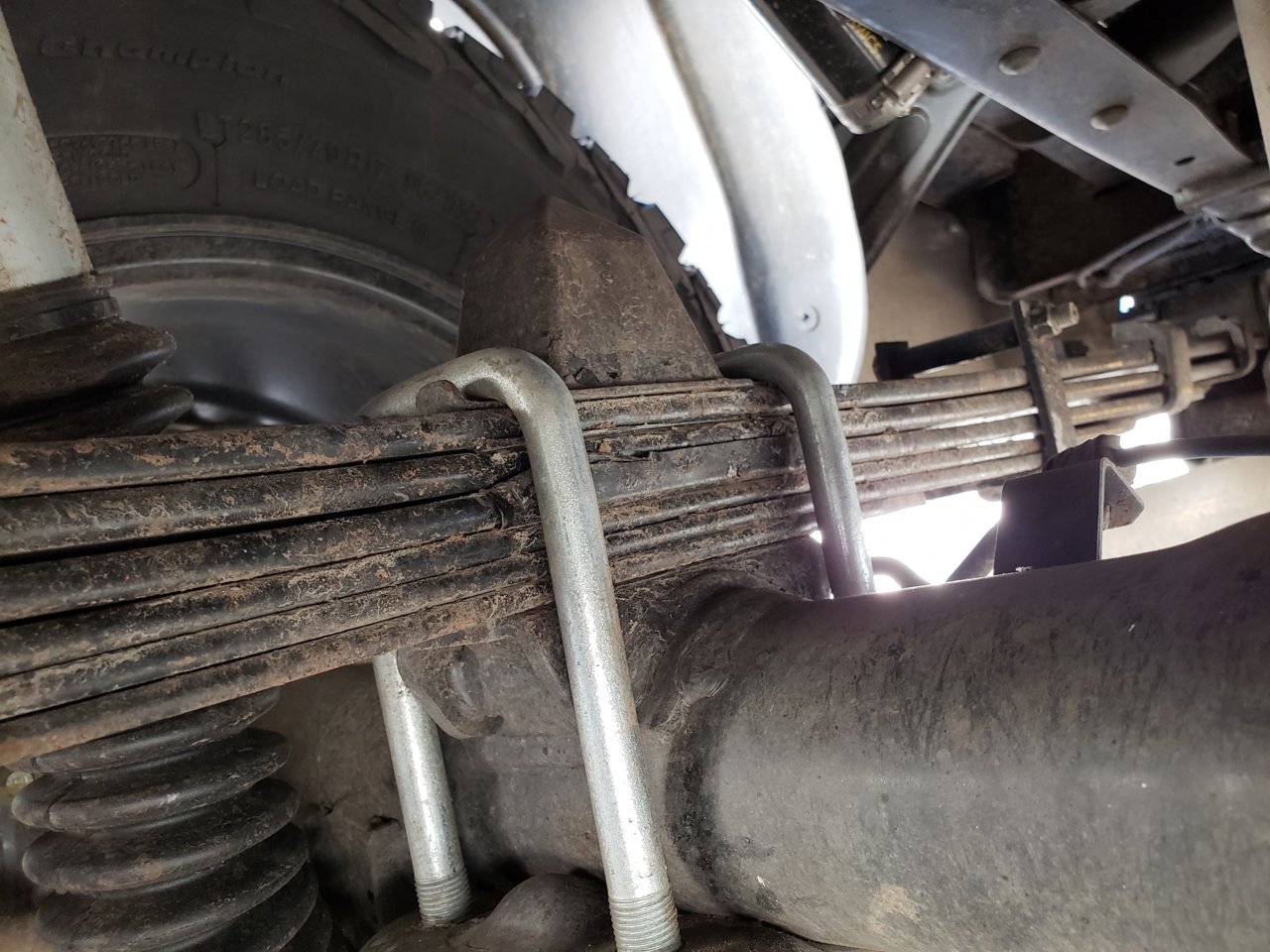

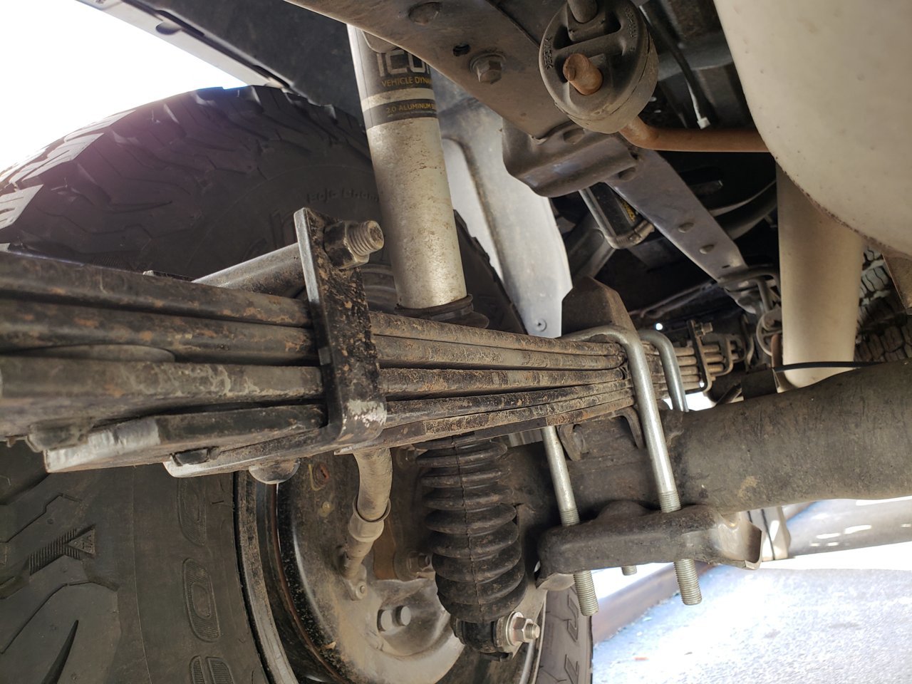

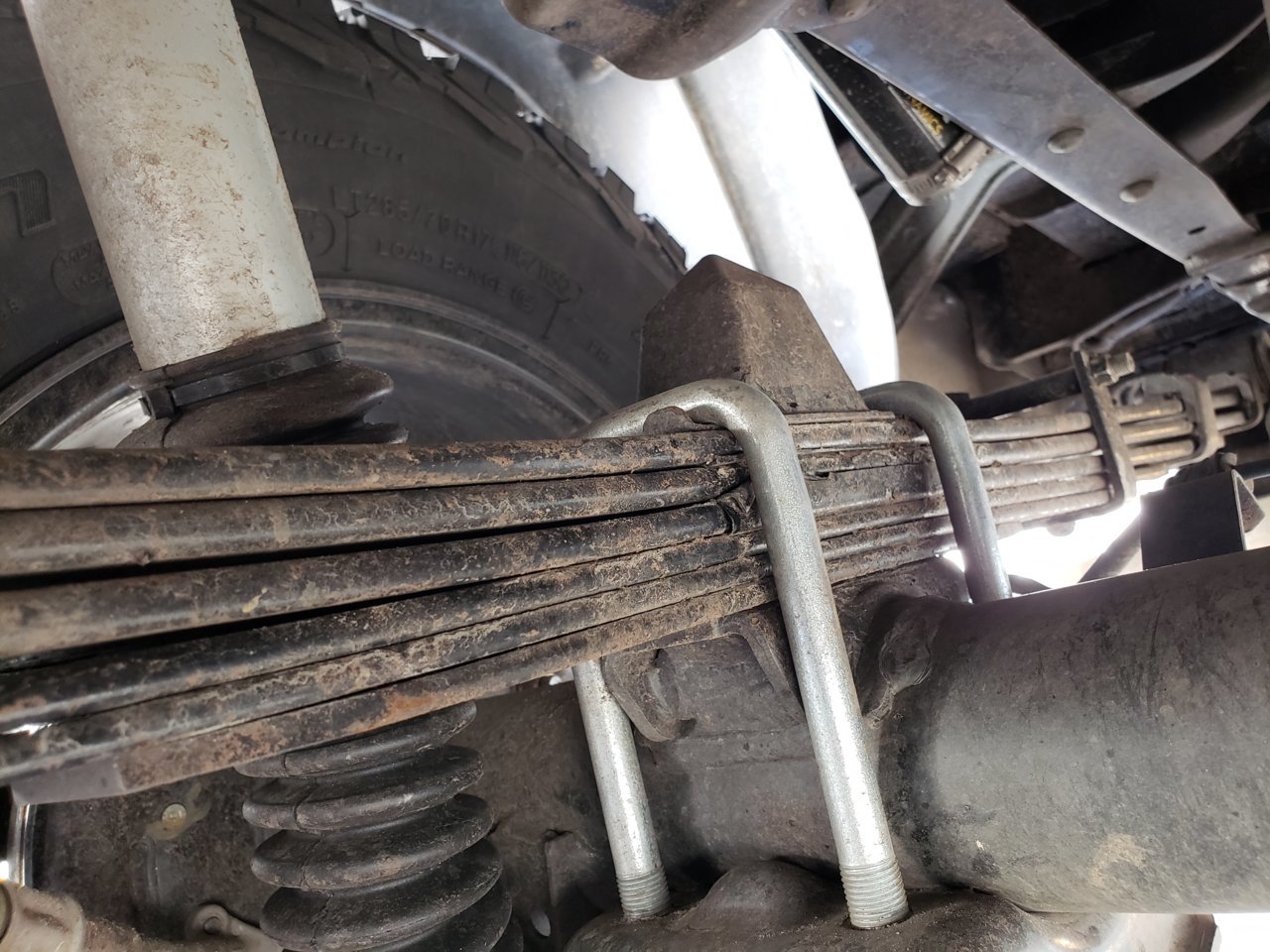

    About 3 weeks ago I had the Icon stage 3 kit put In. Its front coilovers, tubular uca's, rear shocks with reservoir and icons add a leaf (3 leaf pack) it drives great on nice roads but bumpy and pitted roads like the ones here in Brooklyn as well as the unpaved rutted, rocky roads and trails i like driving on weekends are fucking unbearable and I went from loving to drive for hours to dreading my morning commute. I'm not being a pussy either, I'm actually in pain, my neck is messed up and my ass and back are sore. I'm gonna post a picture of the rear leafs. What the fuck is going on here

    What's the fuck is going on here I got 200lb in bed

    Looks perfectly normal.

    That sucks man. I also have a 3 leaf AAL (head strong) with over load left in and my rear feels just fine. A tiny bit firmer but handles bumps much better.
    From the pics, yours looks to be installed issue free. The only thing I can think off is the valving on the rear shocks. The way you describe the “dampning” is very extreme. You dont even have your over load. Makes no sense to me.
