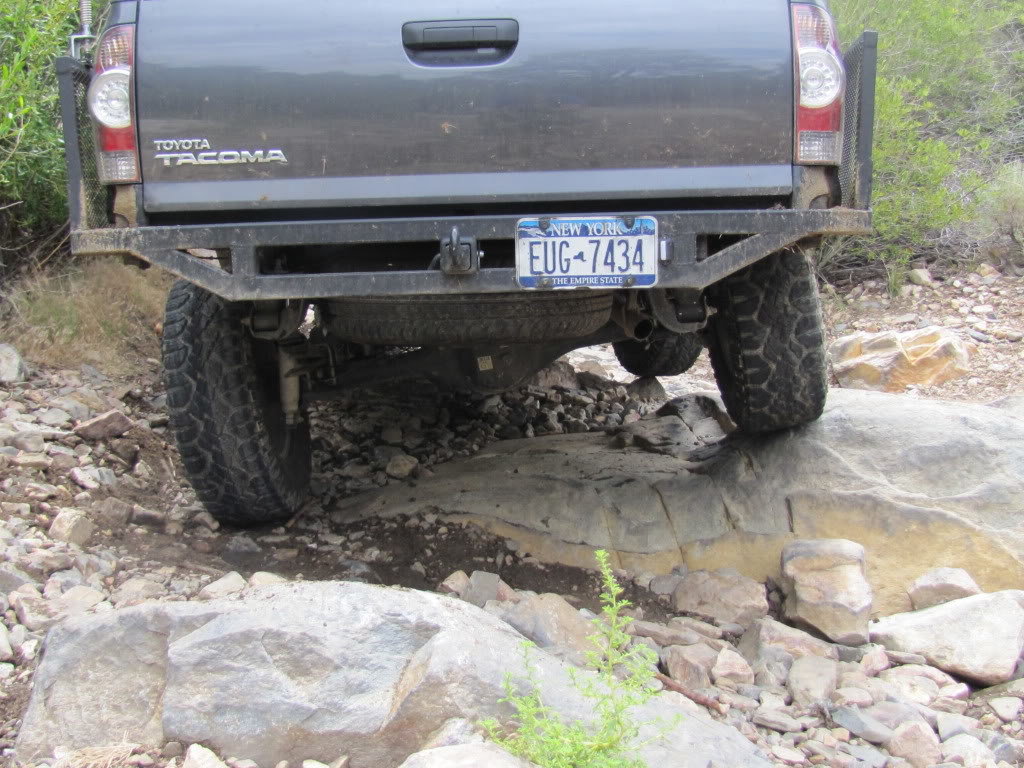

    Heres an ok pic of my flex with 3" and 3" extended travel shocks. i can get a bit more but if you tweak the bracket you can get about an inch of play out of the stock lines which equals about 2" of suspension travel.
