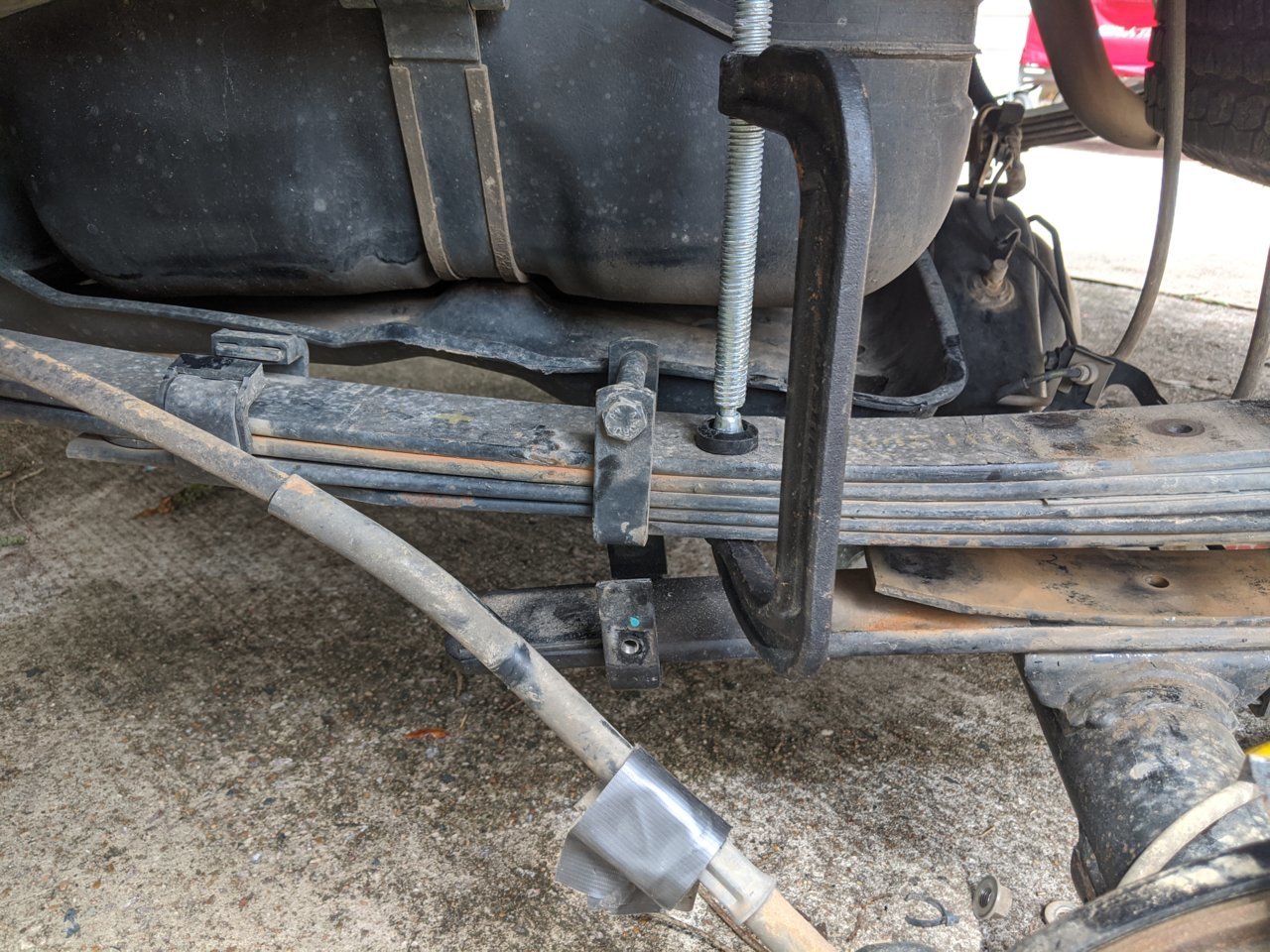

    Title says it all. I think the front bracket on the overload has to be removed, and possibly the front bracket on the AAL. Maybe reuse the u-bracket from the AAL to include the AAL? Help me out.

    AFAIK you use all original hardware including the center pin and u bolts, it'll raise about 1-1.5"

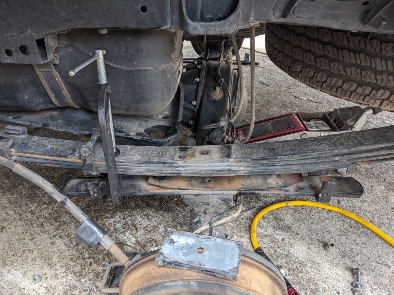

    So..I did the AAL a few months back. I've already removed what I needed to make that happen...but my truck has the slightest of sag in the rear, and when I carry my RTT, it sags a good bit. I want to add the overload back in.

    Here's my problem. The quick and obvious answer is to cut the bracket off the overload. Problem is, the bracket on the AAL will come in contact with the overload when loaded. Is that a problem?

    Here’s mine done I just spread the bracket a little DCA46BD0-8BE5-4041-BF2D-B358B46B4BBF.jpgC8524C88-7E67-4431-8294-AEE63AA46AC1.jpg
