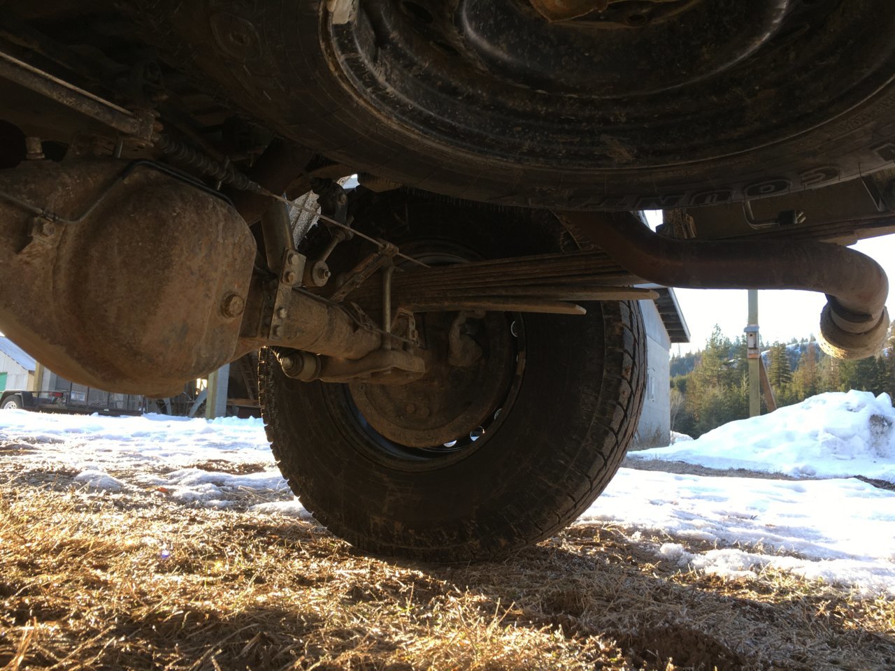

  16. Feb 18, 2020 at 7:35 AM
    #56
    Arctic Taco
    Arctic Taco Firefly, Serenity Ed. -Arctic Taco, a slow build
    Apr 24, 2011
    #55445
    859
    Steve
    Denali Park, Alaska
    98 Tacoma Xtra Cab DLX, 85 Toyota LWB 4x4
    dents and missing bits, built in the Gravel garage, hillbilly trained mechanic…
    I think the long part of the leaf pack goes aft...
    I am also considering the Icon 3 leaf pack, need a bit of support for towing. Might even have to get some Timbrens.0F9ADD79-788E-43BE-99D6-D7C7A7F09F1A.jpgIt would appear that you would need to pull your overloads- looks like I have 2- and slide the Icons in and add the overloads beneath and bolt it up, kinda wondering if the U bolts will be long enough...
