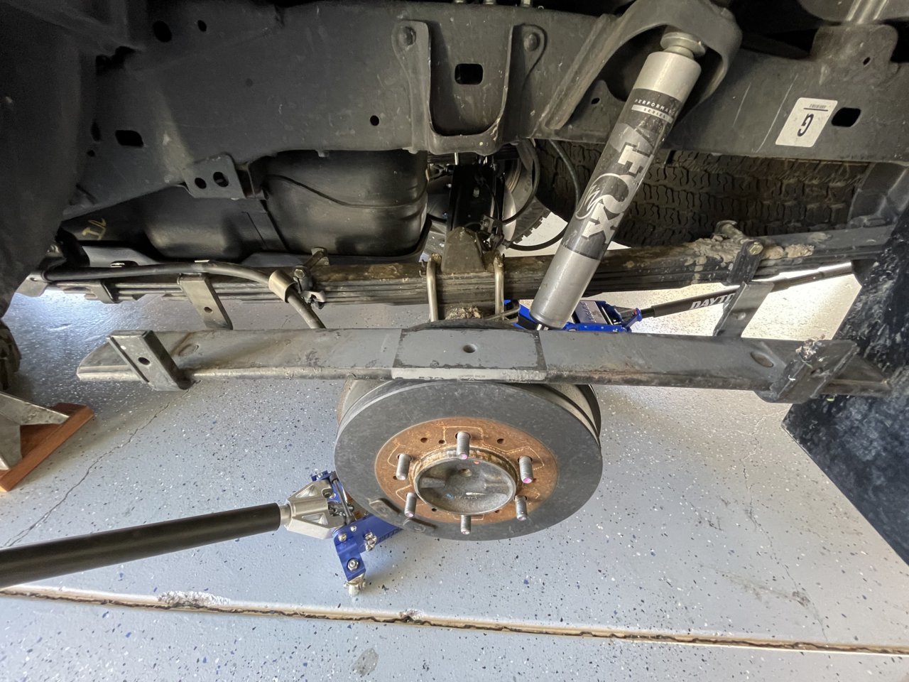

    If I want to reinstall my overload spring do I put all the way at the bottom or up a couple leafs since it’s longer than the bottom icon leaf?2A5692C4-2E6D-4FBE-8825-C90D47AF28C1.jpg
  17. Feb 23, 2022 at 11:58 AM
    #77
    RCRcer
    RCRcer Well-Known Member
    Jul 14, 2015
    #159476
    879
    2015 OR DC
    On the bottom.

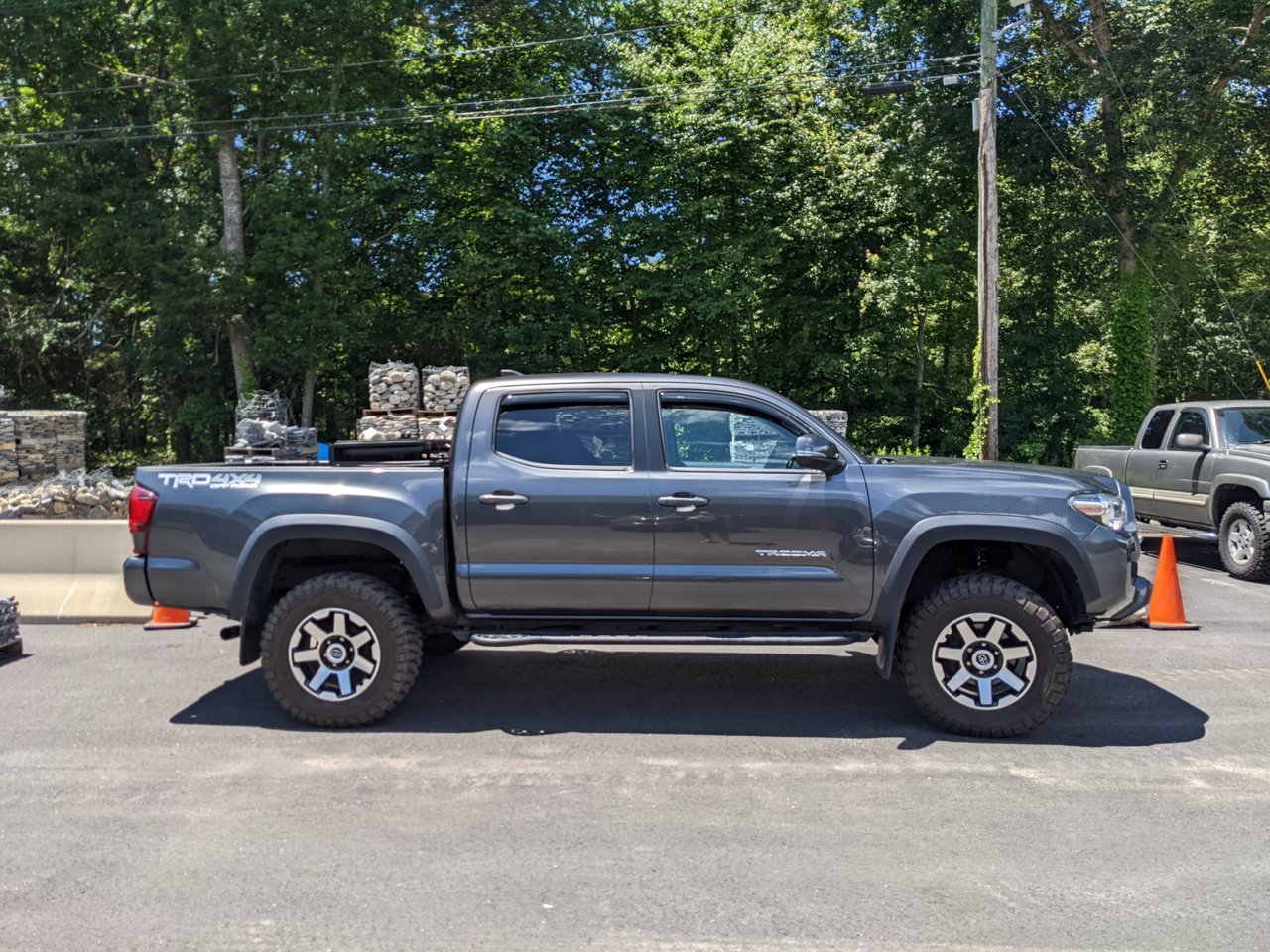

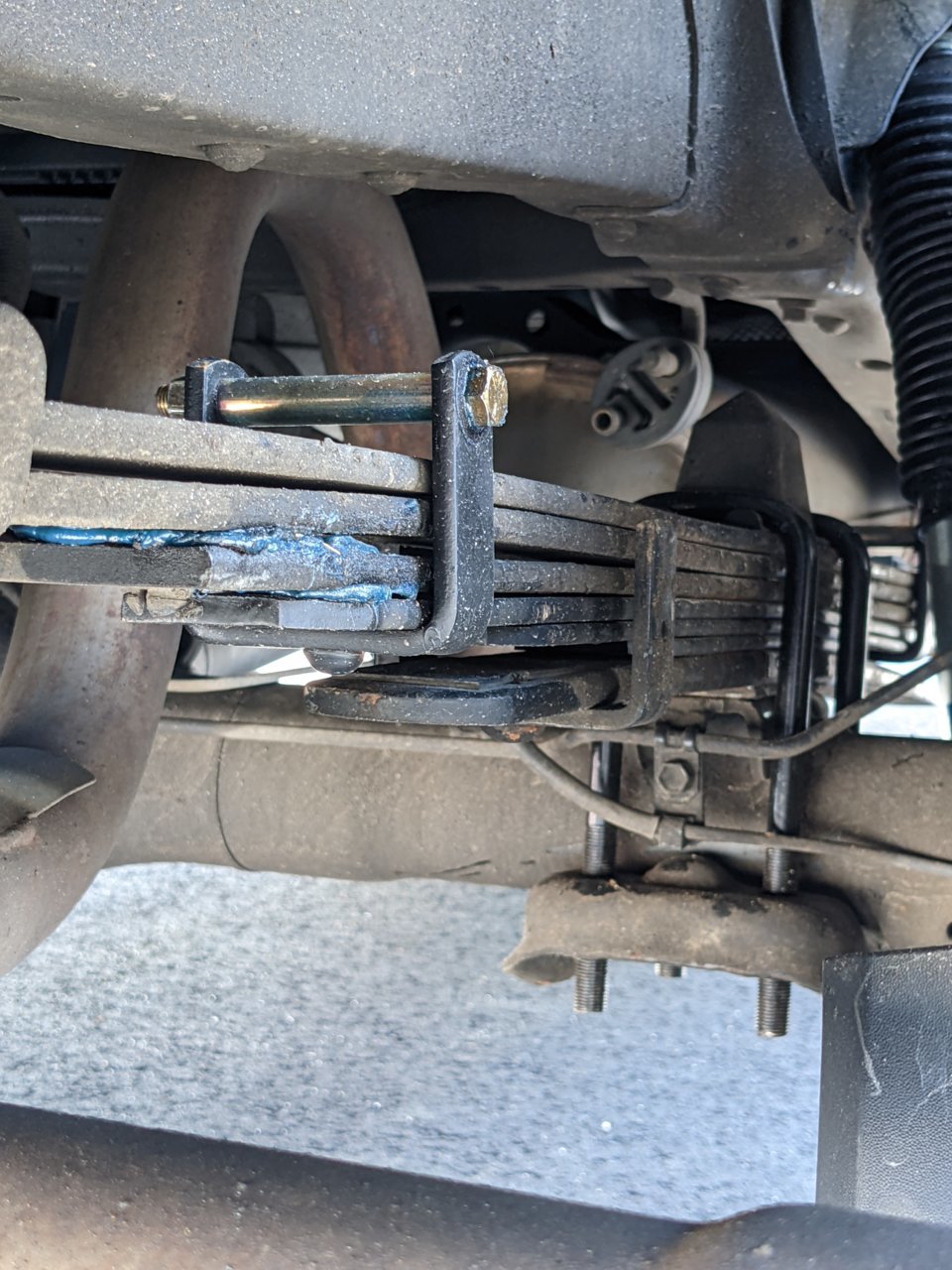

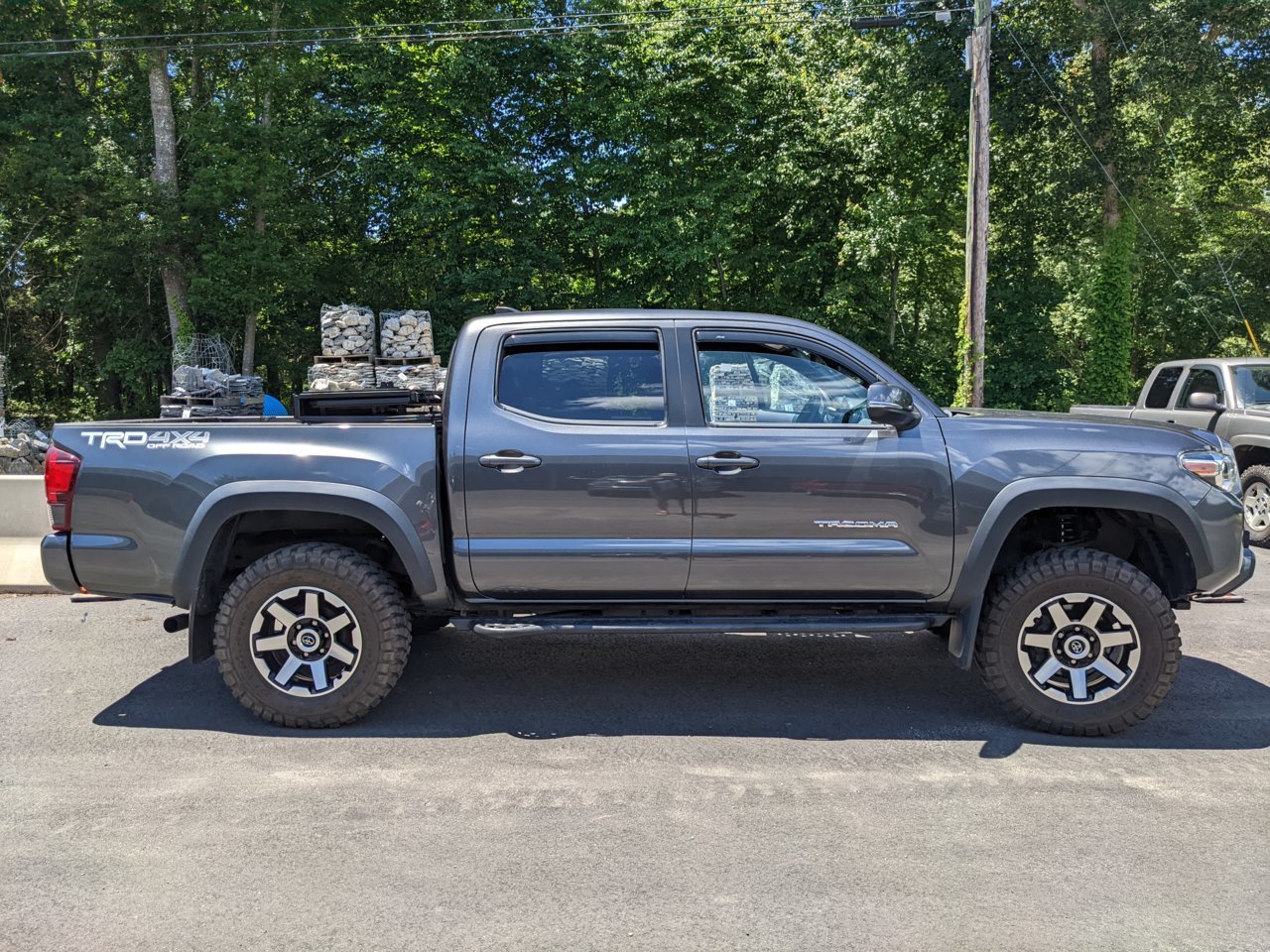

    Just wanted to add to this thread.
    First time post here: 2018 TRD off road, added the AAL from icon and reincorporated the overload spring.
    Didn't take before and after measurements but was a solid inch and a half perhaps more upon installation.
    Attached are three photos one with no load in the bed a second with about 600 lb of granite. You can see the leaf springs go about flat at this weight.
    *** I intend to add very thick anti friction pads both ends of each overload spring, such that they take up the thickness of the last add a leaf.

    I almost always insall thhe icon with the overload in. But, you should take a grinder and trim the overload so that the keeper bracket is removed with the rivet. The rivet will eventually make contact with the leaf above it and make squeek squeek noise. Might not right away but after it settles or with extra weight it will.
