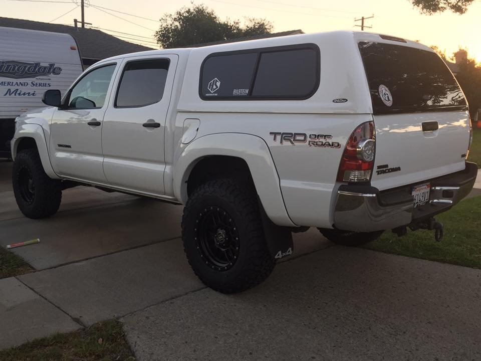

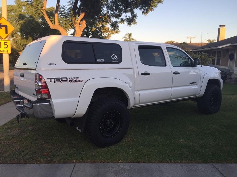

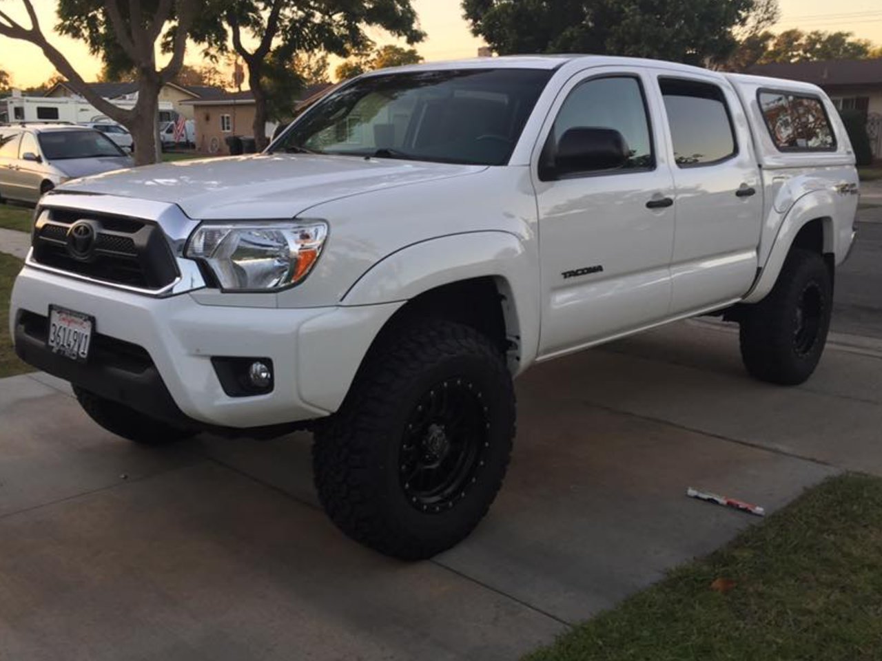

    I put on Icon Wheels and BFG KO2's yesterday.
    17" Icon Alpha's in Satin Black
    Part number:1217858347SB -17 X 8.5 BLK 6 X 5.5" 4.75" 0MM 106.1MM 2500 LBS
    BFG KO2's 285/70/17 and black locking lugs.
    There has only been a few miles of street driving but I like the ride the ground clearance (pumkin) the stability. The tires are just outside of the fenders as I planned .
    The Icon wheels are made perfectly for the Tacoma. Light and tough...
    Now it's time to get it dirty!
    And I think this setup looks pretty sweet...new wheels1.jpg new wheels 3.jpg new wheels 2.jpg icon and KO.jpg

    No rubbing? I got 285’s going on today with 2.5” front lift. Will be wheeling with them

    No rubbing so fare street, I have a 2 1/2 inch lift and I did some fender trimming before I purchased the rims and tires. I am going to take my Dremil with me when I go out so
    I can make trimming adjustments if needed.
