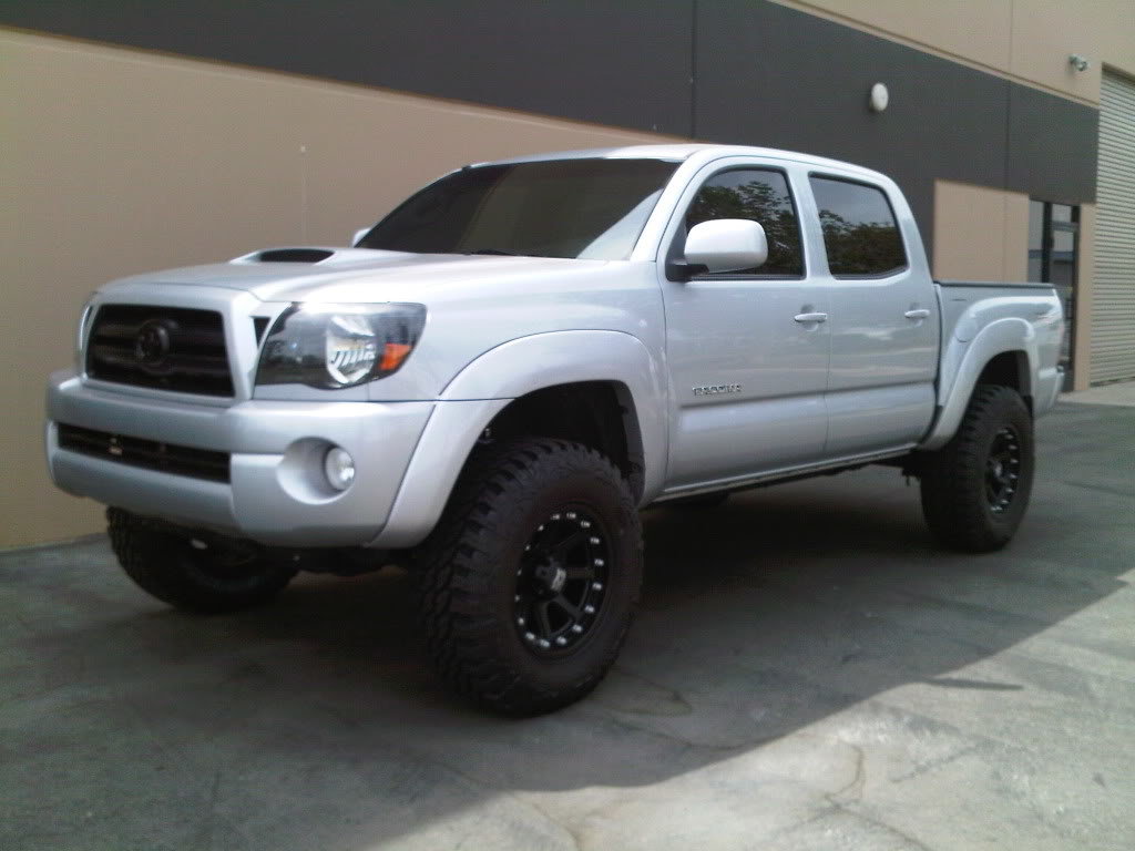

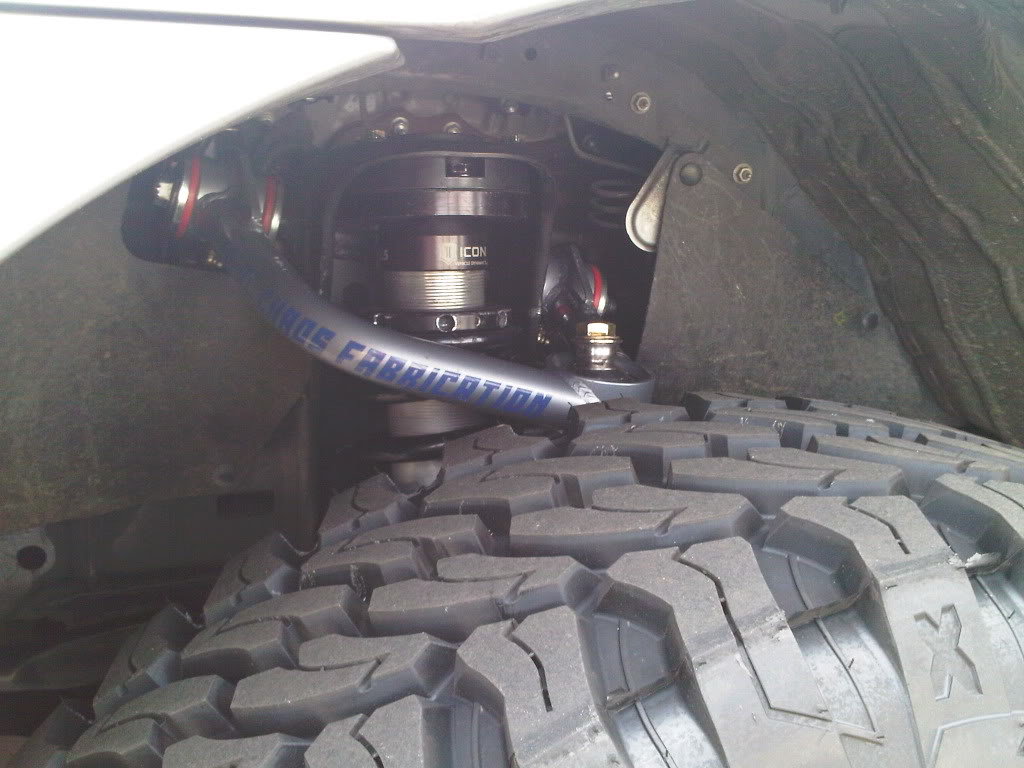

    ok well i finally got it installed and ended up going w/ the icon 2.5's w/ a 1" billet spacer and cranked the c/o up roughly 2".. Rides perfect!!! I went to Icon facility and spoke w/ jeremy.. They helped me out dramatically and are a great bunch of guys.. I used to own Las Vegas Customs and have built many of vehicles- I will be installing the Engage LT kit soon.. will post pics when completed.. Thanks to all for all your feedback and help..
