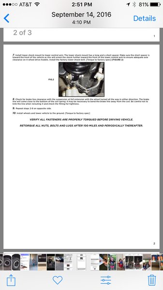

    Nov 28, 2012
    #92013
    35,220

    I know which ones you are referring too. I installed them like the instructions said. with the bigger spacer in the front and smaller in the back. Noted in the picture below. (these are random icon coilovers but have the noted spacers)

    I followed the instructions provided with the coil overs. and printed the instructions from the icon internet page. And you cant put anything on the internet unless its true. Right? :jerkoff:
