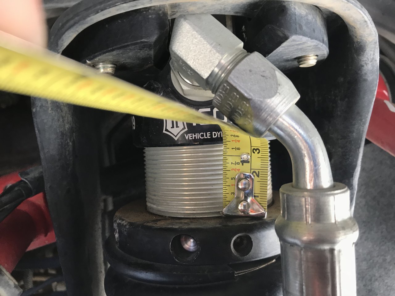

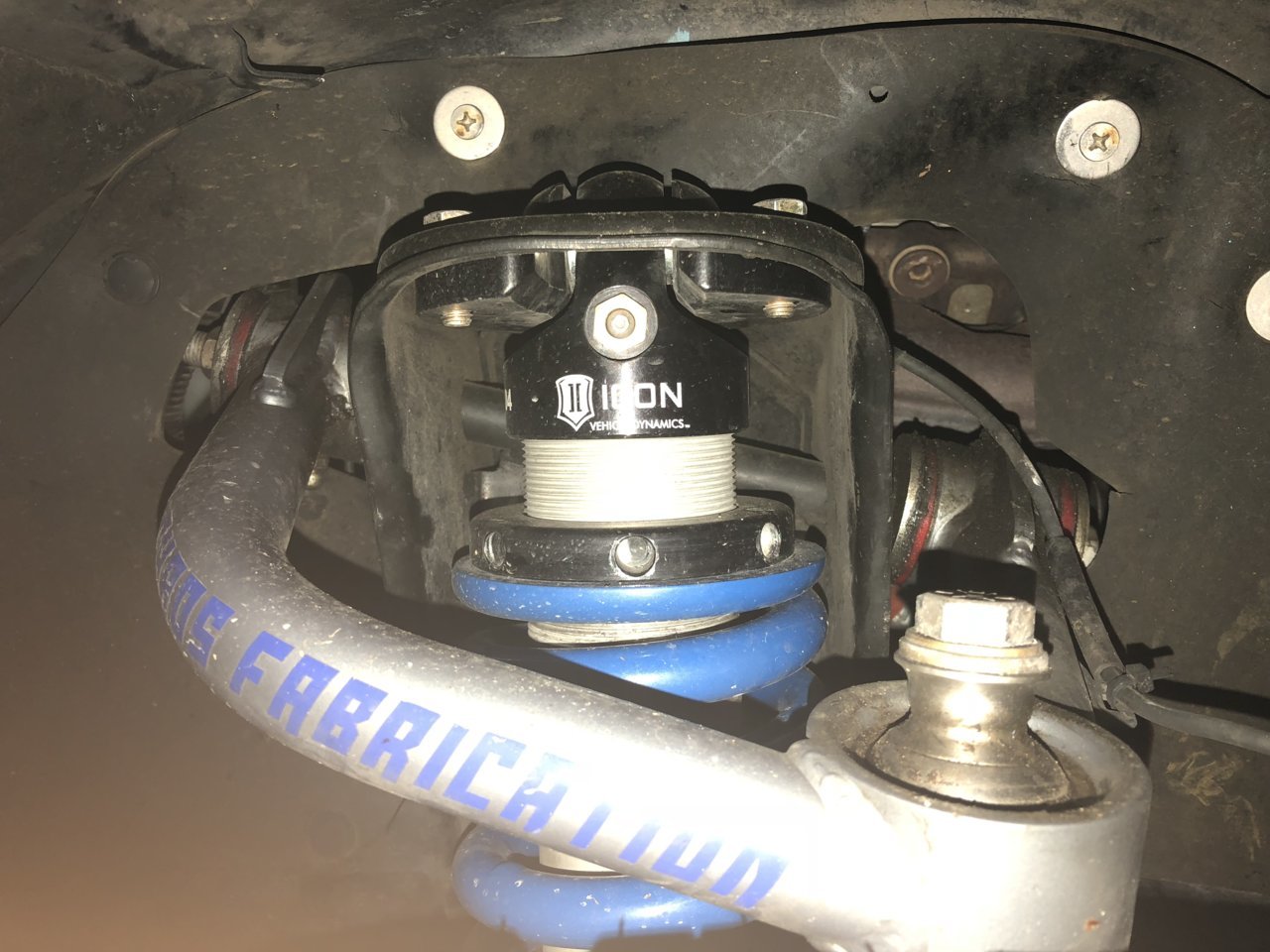

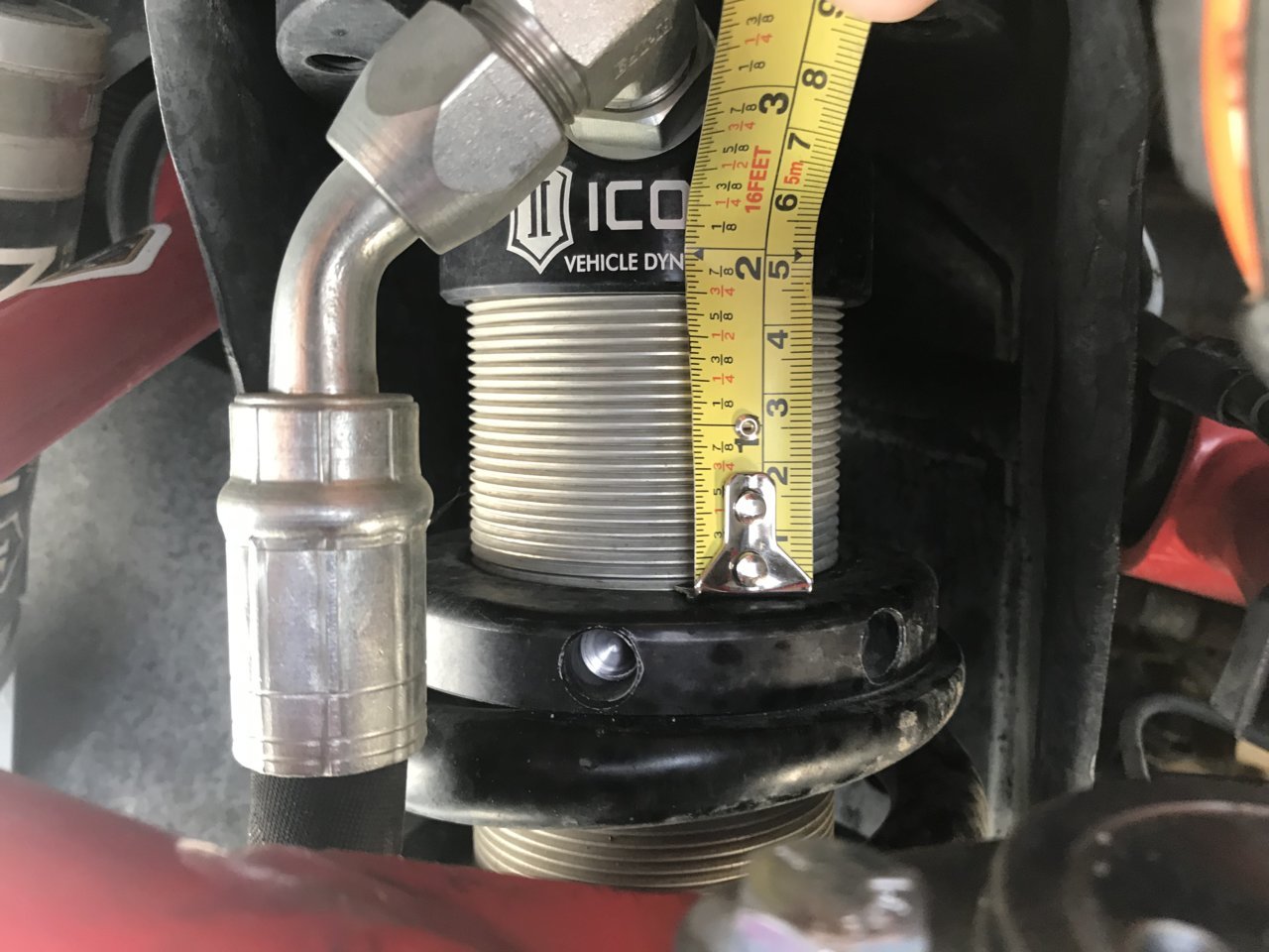

    So I purchased this ICON suspension because I read a lot of good stuff about them. Heard they were amazing on road and even Better offroad. Well idk how because they feel stiff ass sh*t! I feel almost every bump on a bumpy road and the whole cab shakes when I hit a pot hole. I thought these were supposed to absorb all these bumps! I really wish I would have gone with Kings smh! Feels like I’m riding on rough country. Honestly very disappointed.

    Tire psi is:
    30psi front
    27psi rear
    Oh and I don’t have a sway bar. removed it as soon as I isntalled these shocks.
    Also If anyone has any idea what could I do to help with the stiffness please let me know. Other than that I might just get some kings

    You have a lot of preload on those, that will make it stiff.

    Your problem is:
    Too much preload
  6. May 18, 2018 at 2:47 PM

    It’s only 1 3/4 but that’s to make up for the driver side lean and yeah I know I should have just gotten kings. If I wanted a shitty ride I would have just bought Roigh country for 1/4 the price lol

    Anything over 1" will generally ride like ass
