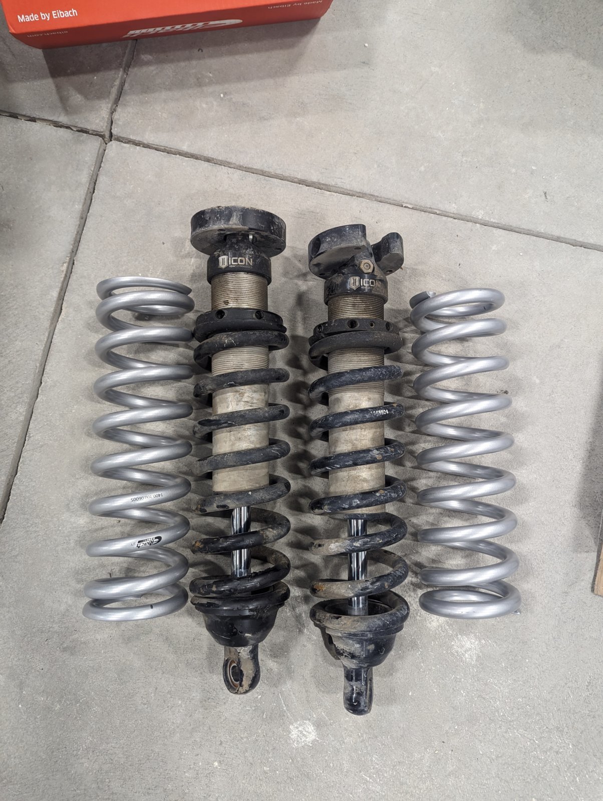

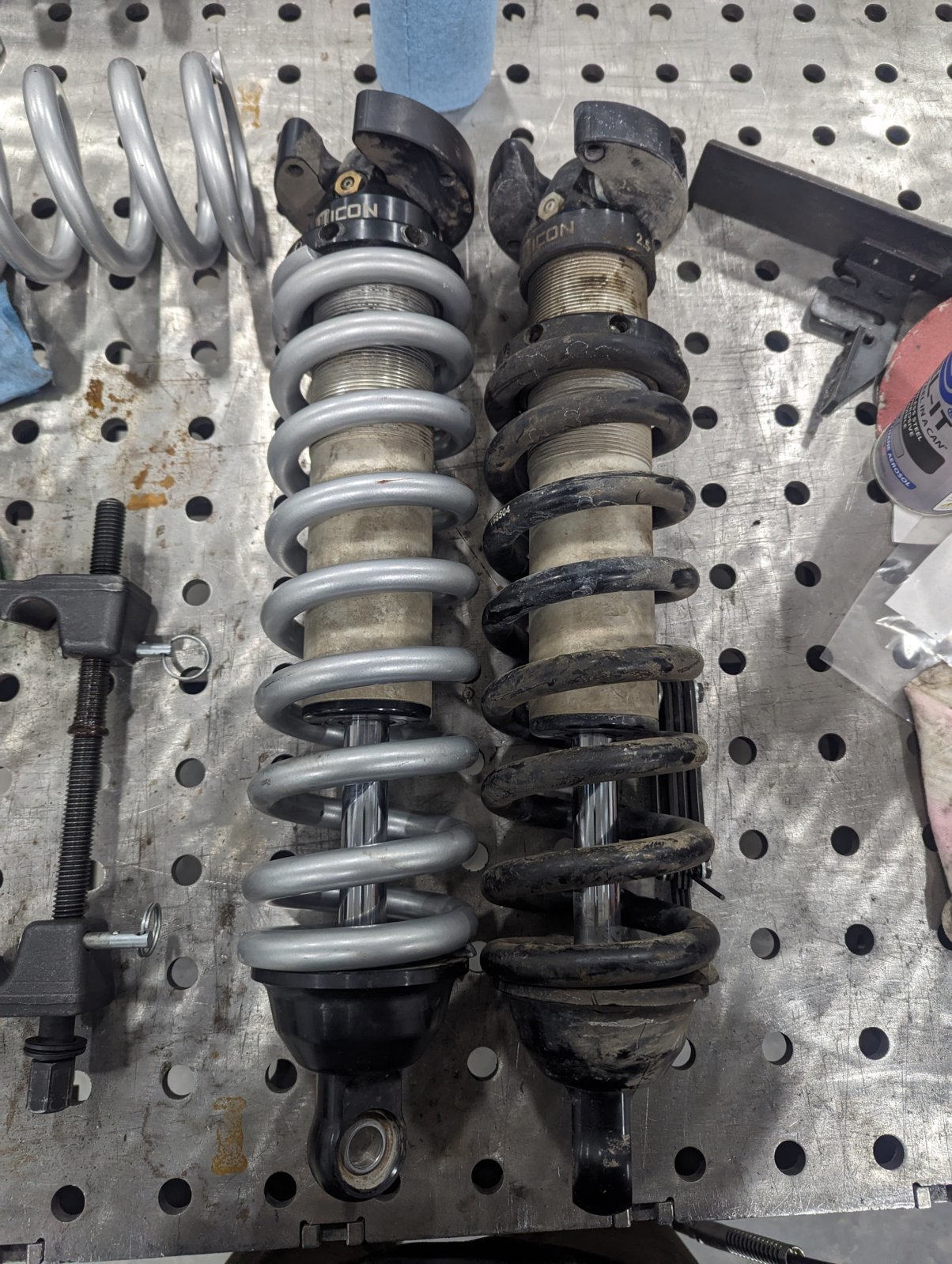

    Hey guys! I have heard a lot of people complain about how their Tacoma's with Icon 2.5 coilovers ride super stiff and rough.
    My initial impression with them, after 10,000 miles would be that I agree. My truck is a 2002, extended cab, 4 cylinder with only a coastal off-road bumper upfront. So not heavy by any means. I never had this truck from how it was from the factory, so not sure how much lift I gained when I installed the Icons. Anyways, from their suggested settings I had to add quite a bit more preload to get the truck to sit how I wanted. I have Chevy 63 leaf springs in the rear, so granted it was probably lifted higher back there than stock by quite a bit.
    After 10,000 miles with them I was just so disappointed how rough and jarring the ride felt. Unless I was going really fast on dirt roads, it just was not comfortable and it didn't felt all that confident.
    I believe kings run 14x600 pound springs in their setup so I figured I'd give that a shot before taking the icons completely out. I ordered some Eibach coils from a local supplier for less than 200 bucks out the door. They were really easy to swap out with just a spring compressor from O'Reillys.

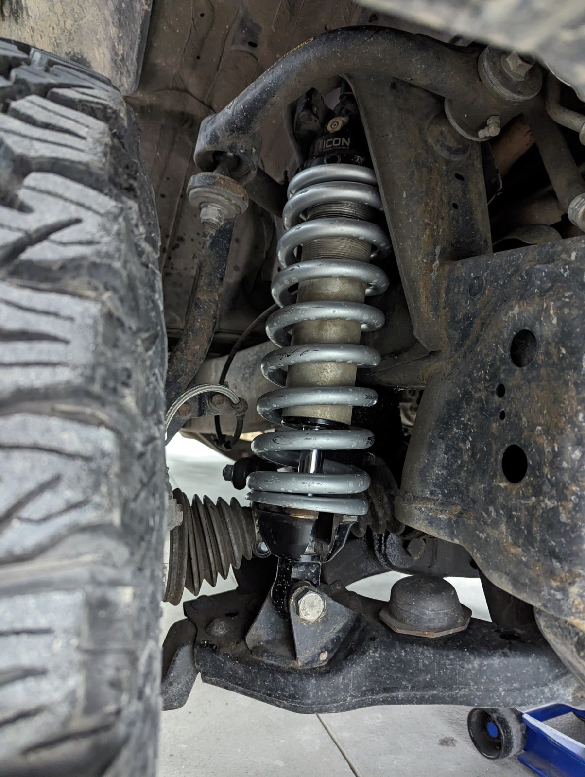

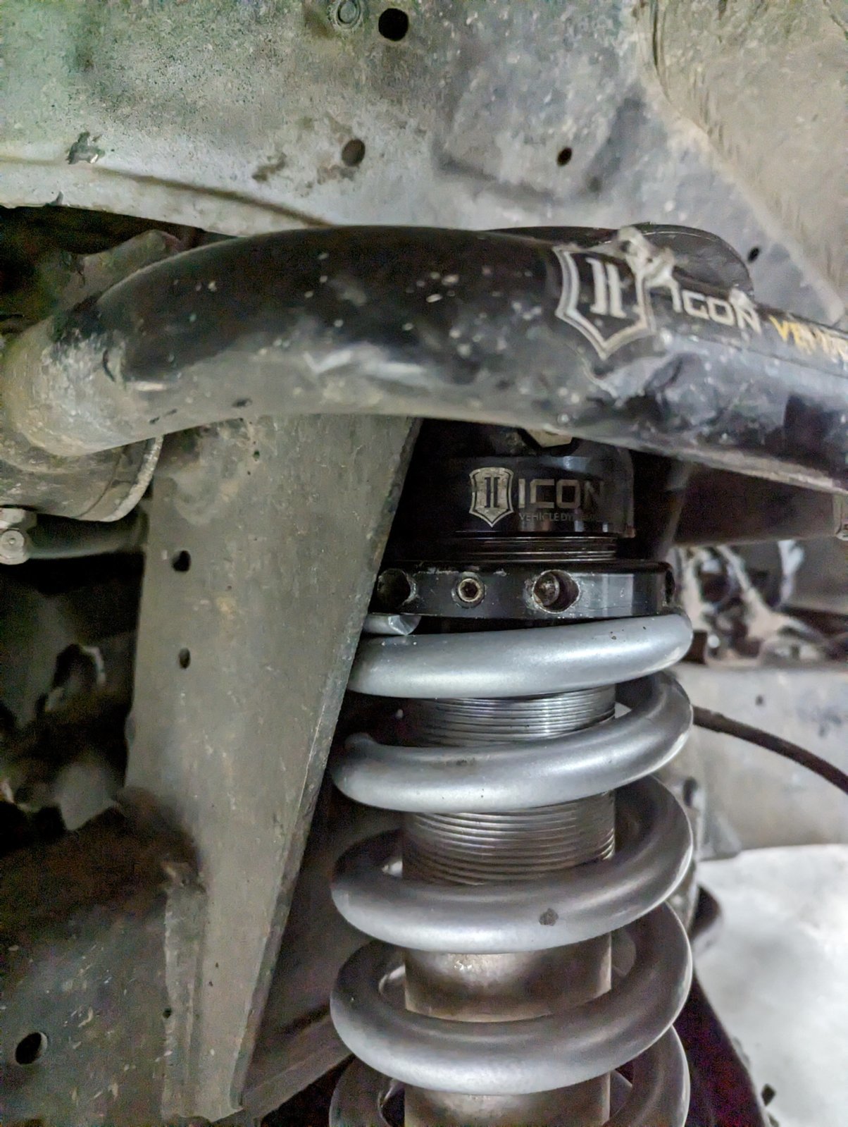

    Since the 14 inch coil is longer, when the collar was all the way loose, the spring barely touched it. I set the truck down at that setting, and it was only about a half inch lower than what I had my previous springs set at. I had to add very little preload to get where my ride height was at before.
    After driving around for a bit, it's so much better. The truck is way smoothPXL_20240301_020356084.jpg PXL_20240301_020025473.jpg PXL_20240229_030017772.jpg PXL_20240229_032012739.jpg er daily driving, and going off-road feels so much more amazing. Especially at slower speeds. Body roll and cornering doesn't seem to be affected, but I am running my sway bar. I'm curious to see how these springs settle over the next couple thousand miles, but I am absolutely happy doing this. I believe the old coils had around 1.5 to 2 inches of preload.
    Seriously, if you aren't happy with the icons, try a longer and softer spring. I bet you'll be surprised! I'll throw some photos of that the coils look like on the truck!
