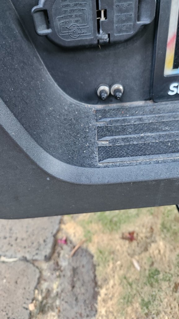

    Sorry wife had a Honey-Do Item before she got home from work and I forgot to take some pictures. Looked back at my purchase it is with Airlifter and it is the Airlifter 5000 and it has worked really well for what I do when it comes to trailering it has greatly improved that sag in the backend when trailering. I opted not to purchase and install a compressor and just ran the air supply hoses to by my license plate and I just us my Milwaukie M12 battery compressor when I am carrying a load.
    The air bags are specifically for the 4th Gen Tacoma
    https://youtu.be/qTn1pOPNqbY?si=05AXBIYuWivPQtab
    https://www.airliftcompany.com/products/air-springs/loadlifter-5000
