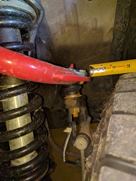

    I read about some tire rub issues from the JBA. Anybody have input on them with 265/75/16 on stock OffRoad wheels?

    I believe JBA recommends at least 4.5" of backspacing for their UCAs. The OEM off-road wheels are 5.25BS so you may encounter some rub.
    I have SCS SR8s 17in with 4.3BS and haven't had an issue (but let me run out to the truck and double check)
    EDIT
    No signs of rubbing with my 265/70r17s

    I'm interested to see how much gap you have. I have a set sitting in the shop that I'm not sure if I want to replace my LR's with.

    Not sure if this is what you wanted. The wheel is turned ever so slightly to the passenger side. I do think people who report the rubbing issue are having it occur at close to or full lock.
    1truckdriver likes this.

    That's what I was looking for
