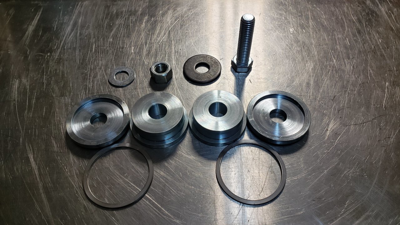

    These are the specific parts to adapt a 05+ Tacoma Delta joint to 95-04 Tacoma spindle. The link in the first post has the parts diagram.

    K, I'm looking at your pics and some of the items in your pic I can see where it might go but just need to make sure. Another thing is can this be used with the stock upper control arm?

    This is only to be used with an aftermarket UCA, it will not fit a stock UCA.

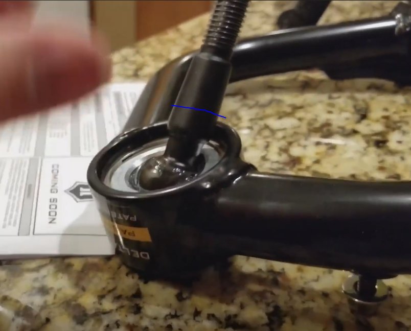

    any chance you could take a picture of how they sit installed? just watching this video: https://www.youtube.com/watch?v=j8lBYkjyFz4
    and it seems like the taper would have to seat really shallow to make sure the arm-cup doesn't interfere with the Spindle seat.
