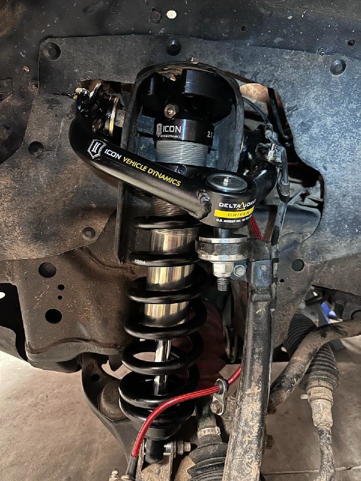

    Here they are installed on mine:

    thanks! looks like they do sit pretty high in the taper

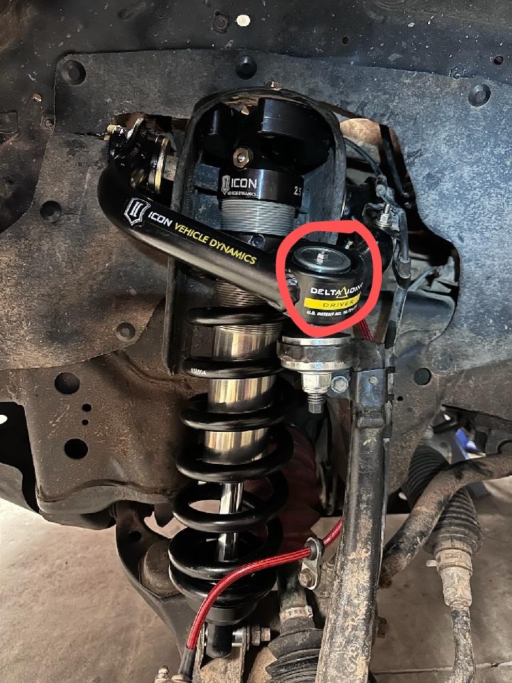

    Yeah should be able to, can get zerks at tractor supply or even Ace in the small faster section

    Yes, that's where said lost zerks are supposed to go.

    Do you think it's worth getting that needle attachment from Icon so that the dust cover cap can fit over top?
    Don't currently have the dust cover cap either, so I'd have to buy that and the needle greasing attachment too

    Personally I think the dust covers are a good idea, but I wouldn't bother with their asinine needle thing, just put a regular zerk in there, fill the joint, put the other one back as a cap.
